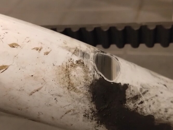

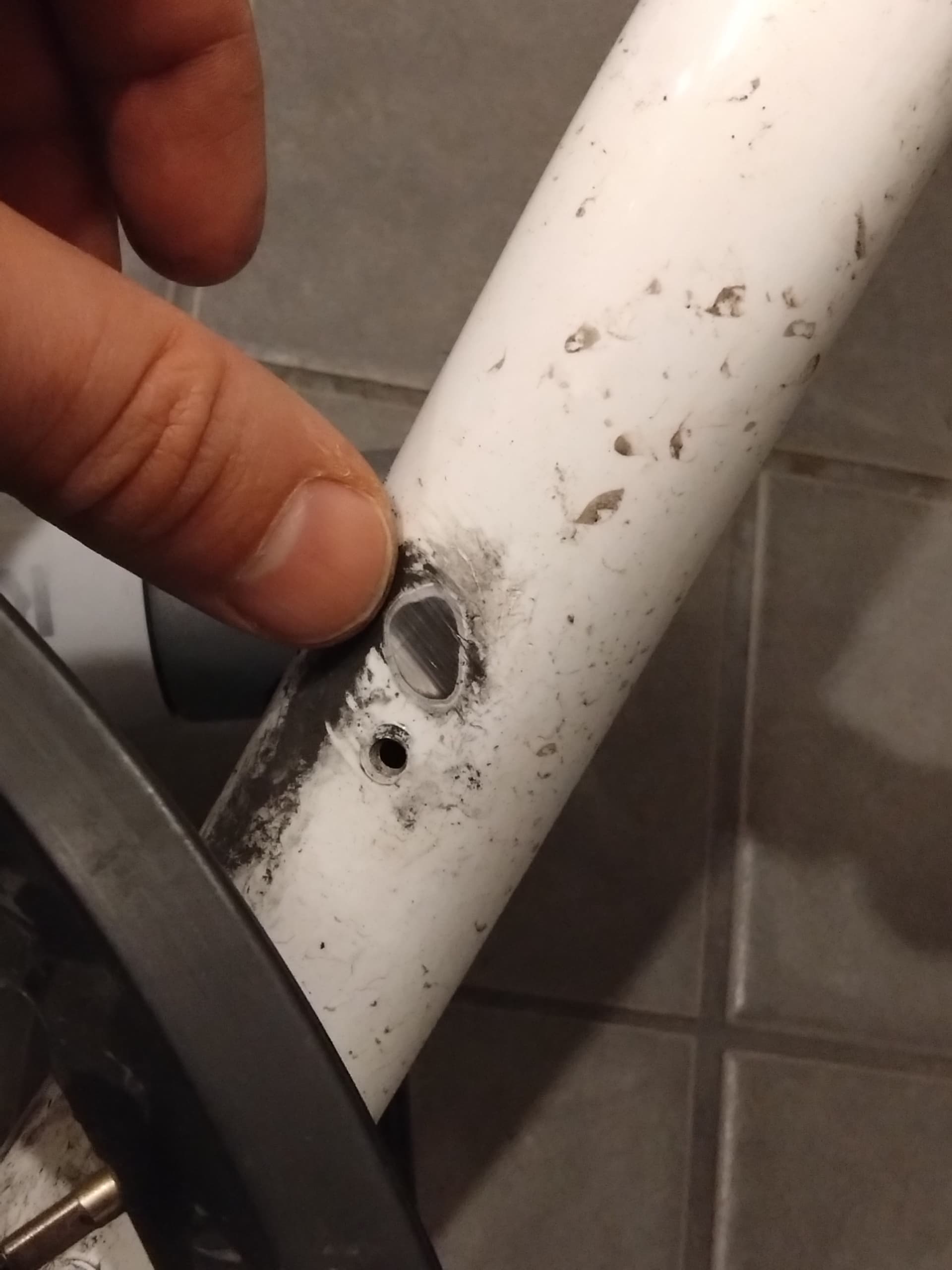

Sad news :disappointed: Yesterday I changed the winter tires from 42-355 back to the normal one 32-355.
I was surprised to see that there was around 2mm groove on the bike body caused by the rear tire.
I don’t know why this happened. When I mounted the 42-355 tires I made sure that the tire is not touching the body ( around 2-3 mm tolerance). What caused this ?
Is it the small gravel that is used here everywhere to prevent slipping?
Is it because of applying weight (82 me + 1 accessories + 5 backpack = 88 kg) the tolerance change ?
Or the tolerance was not enough for the dirt to escape?
Unfortunately it was hard to notice that something is happening before changing the tire . I should have paid more attention. I didn’t notice sound or drag. I thought the dirt accumulation on the body is normal due to the low tolerance (there is no space for the debris to move freely).
Anyway, now I have around 1-2 mm grooves on both tubes where the rear tire touch the tube.
Do you think it is still safe to ride this bike ?

I did know that effect from my EVO (with the extremely wide 16" Van’s tyres) - unloaded there was gap (maybe 1-2 mm), but once loaded (with me) the tyre started to touch the frame.
Next time, before you use the 42er tyres again, you need to spoke the rim a bit to the left side, like Klaus mentioned.
Personally, I do not think this will be a problem, but naturally, you should check the area regularly for cracks :face_with_monocle:
Thanks for sharing your thoughts! :slightly_smiling_face:
Interesting to see that rubber can grind the aluminum. Combination of heat, dirt,… etc became like saw. :sweat_smile:I didn’t expect this frankly. I thought that the tire will just get stuck or will give noise. I think 2mm tolerance is not enough maybe 2 more mm will do the trick (4mm int total). I will the spoke adjustment later
