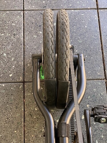

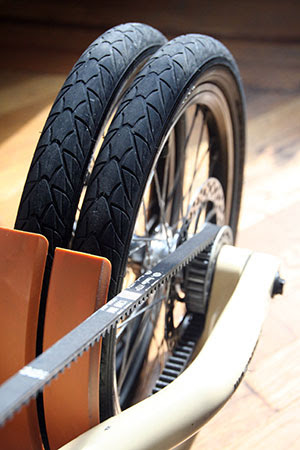

I want to inform you herewith about the fact that I installed on my Strida MAS, which came with Kendo Kwest 32-305 tyres (not 40-305, which seem to be the standard for 16" Stridas today) a pair of Schwalbe Marathon 47-305.
The surprise for me was that it folds and holds with the new tyres without problems - so, no adaptation was needed. I admit that, when folded, the tyres are not parallel, but it was the same with the original tyres.
Here is a pic as per today, with Schwalbe Marathon 47-305:
And here, just for fun, the comparison between the old 32-305 and new 47-305 tyre
