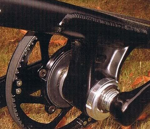

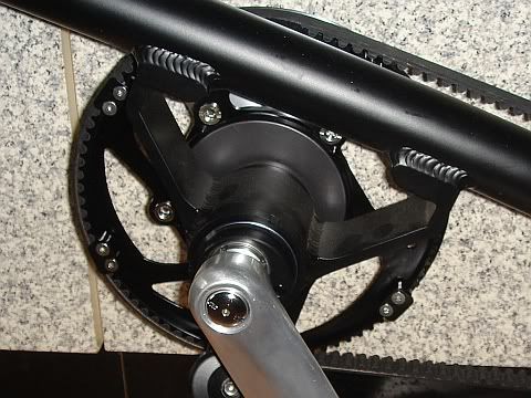

Has anybody noticed the aluminium holding part for the bottom bracket of the new MAS is much different to the older version?
The older version is made of three parts, a tube for the bottom bracket and two "carrier", which connect the bottom bracket housing to the frame tube. The connection occurs via four welding seams, two of them from bottom bracket to the "carrier" and two seams connect the arms to the frame tube (visible far better on Amuro's reply below).
The new versions seems to be one part, the distance of the two "carrier" together is much smaller, additionally there is an (amplifying?) base between the "carrier". The position and shape of the welding seam has changed, now it looks like there is only one seam.
I would like to know why this part has been changed, for design reasons only?
Hard to believe...
B. r.
Last edited by Blackstridaaustria on Sat Dec 18, 2010 11:05 am, edited 2 times in total.

Postby Amuro Lee on Sat Dec 18, 2010 4:33 am
It is so strange that the welded BB mounting of KeKeMaN's MAS in Spain is the same as the older version. :roll:

Re: MAS two speed reviewed
Postby Amuro Lee on Sat Dec 18, 2010 9:14 am
I've just noticed that the "back sides" of the speed-drives in the about pictures are silver in colour but the same part on my speed-drive is black. :roll:

Postby Blackstridaaustria on Sat Dec 18, 2010 9:24 am
Again I was not exactly enough, I beg your pardon...
I mean the holding of the bottom bracket, which is shaped completely different, also the welded seams look quite different.
Post and picture were edited, please read further informations, sorry to cause inconvenience...
Thanks!

Postby Amuro Lee on Sat Dec 25, 2010 3:56 pm
http://www.hkstrida.org/forum/viewtopic.php?f=12&t=4410
STRIDA HK wrote:The reinforcement is to pass EN testing. However, the best part is the 1-piece cast bottom bracket!
MAS STRiDA.jpg (66.14 KiB) Viewed 18481 times
MAS STRiDA 1.jpg (44.95 KiB) Viewed 18472 times
MAS STRiDA 2.jpg (53.33 KiB) Viewed 18727 times
Postby Blackstridaaustria on Sat Dec 25, 2010 9:20 pm
You mean before reinforcement it failed in EN test?!
---no comment---

Postby Minkair on Mon Dec 27, 2010 2:39 am
That cast bottom bracket doesn't look so wonderful - judging by the amount of weld material required, there could be long term fatigue issues in the bottom tube for the new version. The EN test may just have required less deflection under static load?
Anyone know the EN spec?
