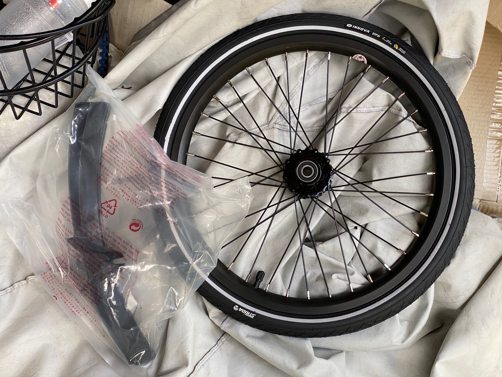

Well, I have some concerns regarding 4.
On the Strida, you can not tilt the saddle (nose up or down).
So, with bigger rear wheel, you get always nose down.
May work for you, but I don’t think that’s ideal. :thinking:
I understand your concerns about point 4.
Saddle tilt? You can’t change the angle… :sob:
I think it might be useful in my environment, where I often climb uphill.
I often get a slight “wheelie” sensation when pedaling, so…
And if I keep the 16-inch cast wheels, I can always put it back ! :wink:

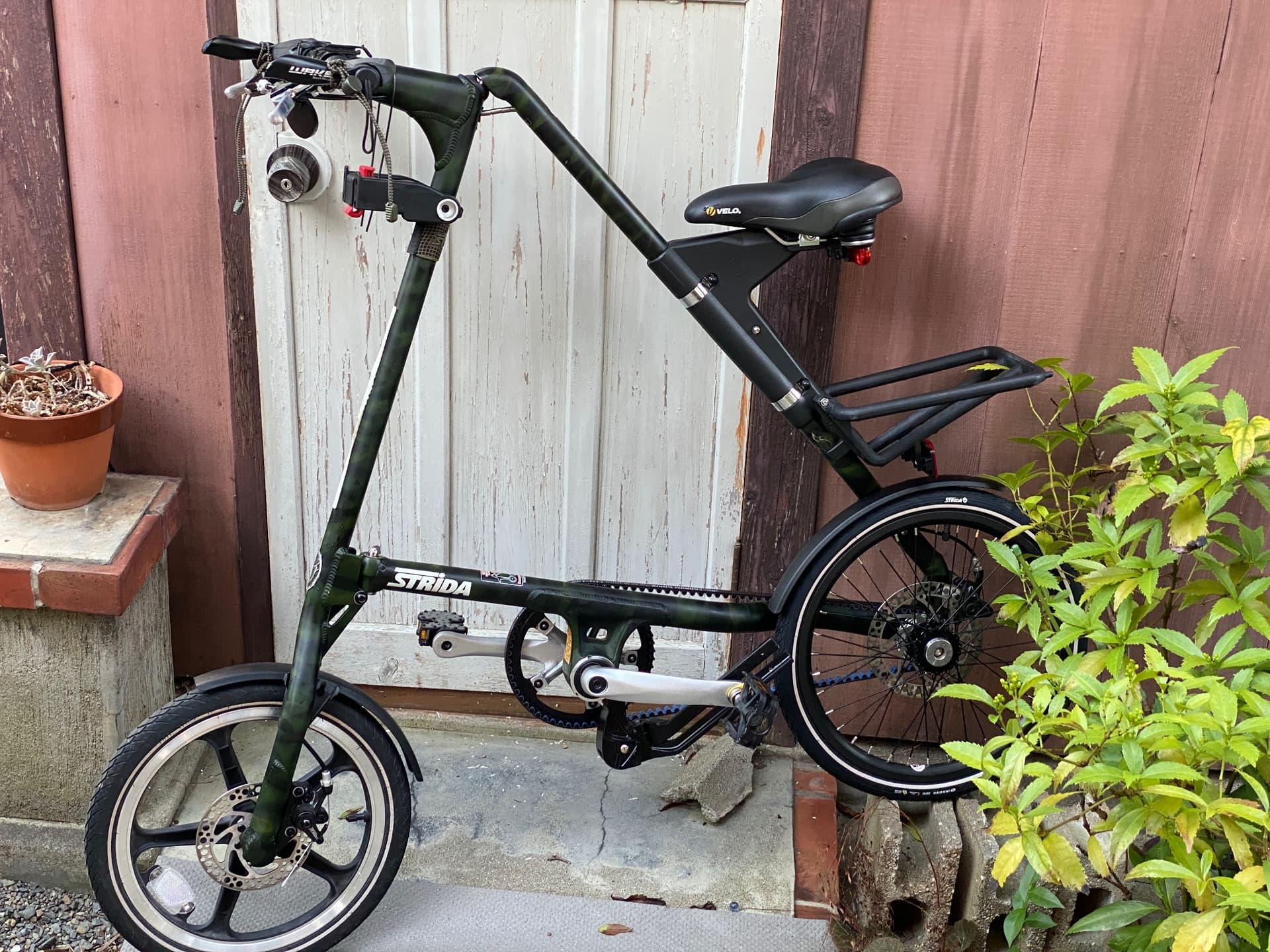

The Gates carbon drive (55T belt ring, 22T free cog and 122T belt) installation experiment was a success!:tada:
Details will be added later in a new topic!:upside_down_face:
