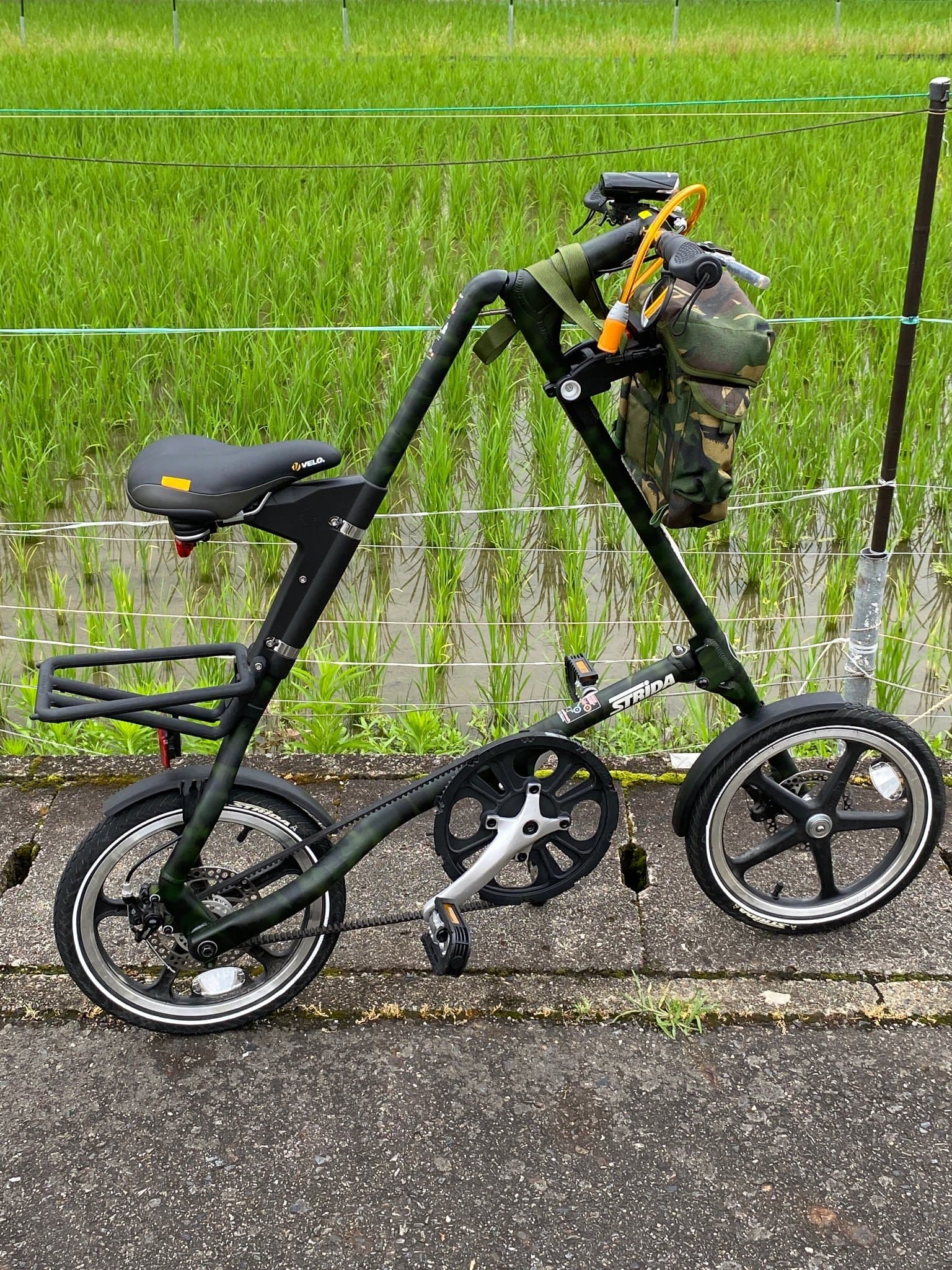

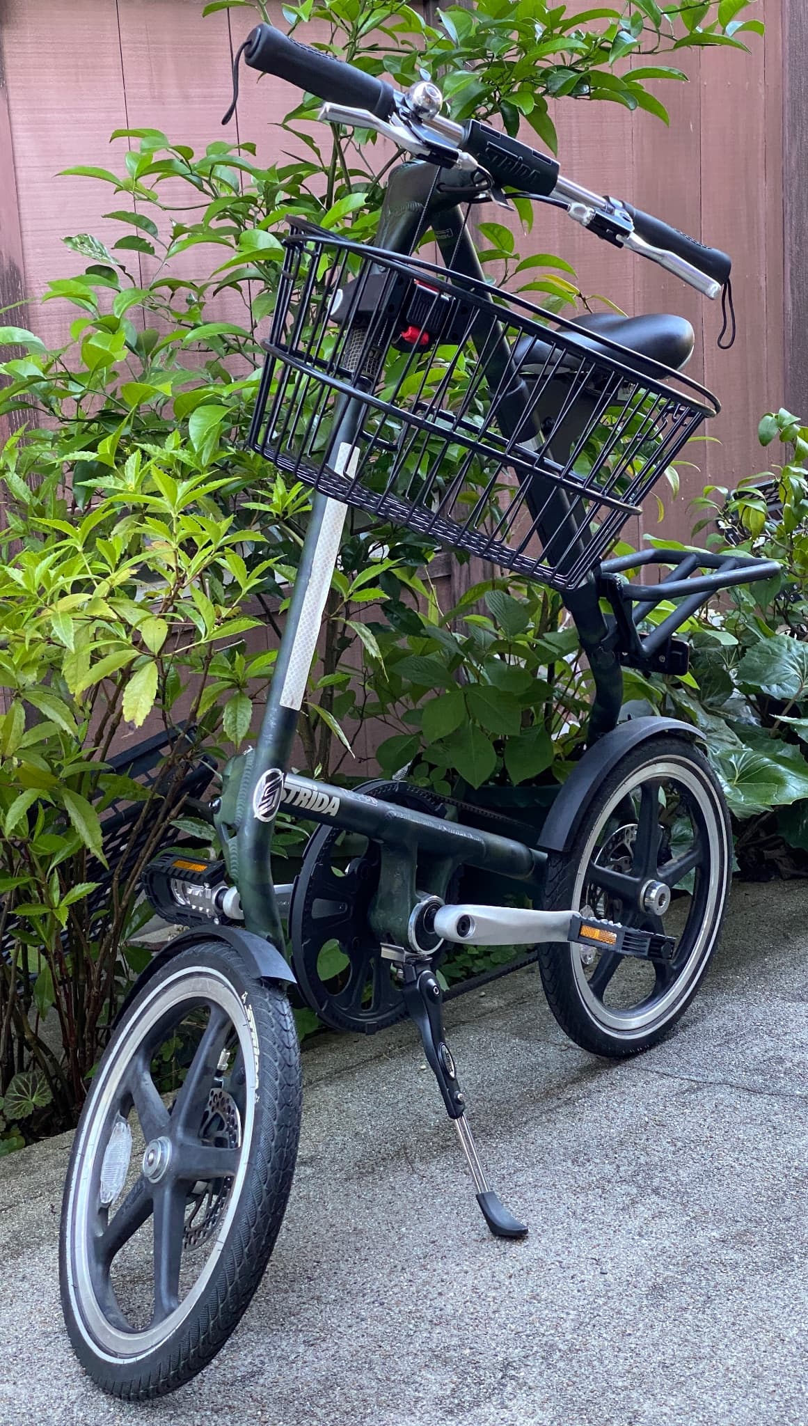

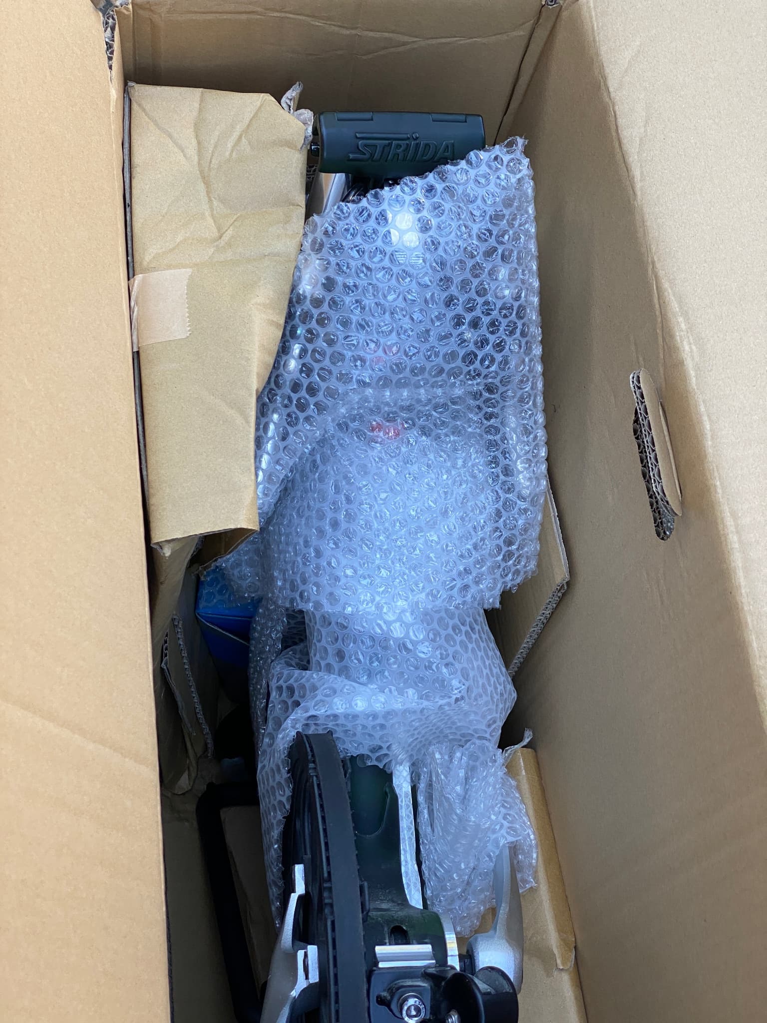

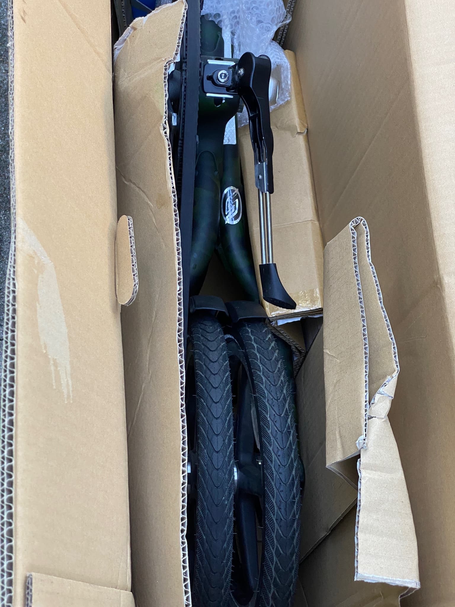

Taken out of the box and assembled STRiDA

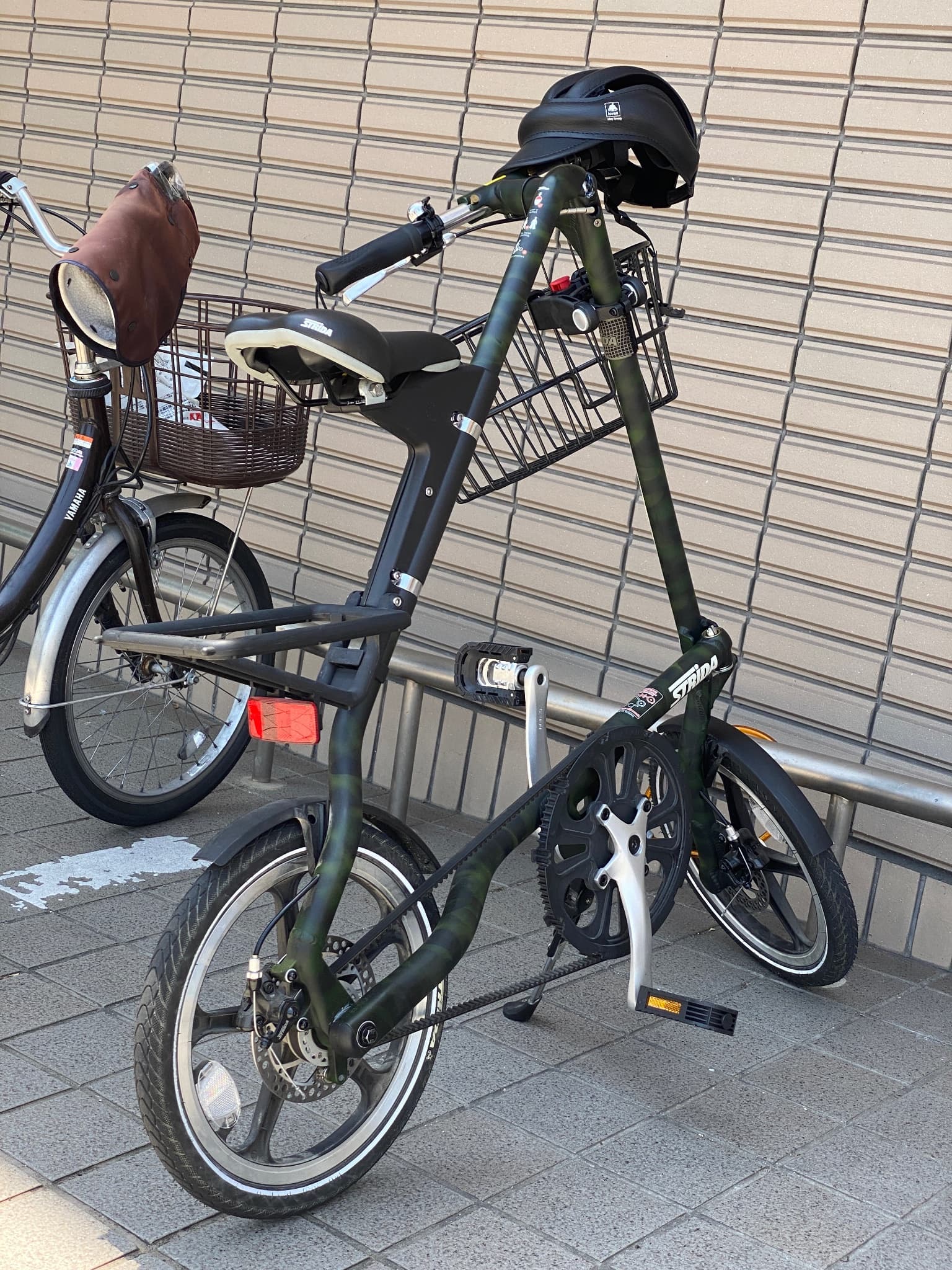

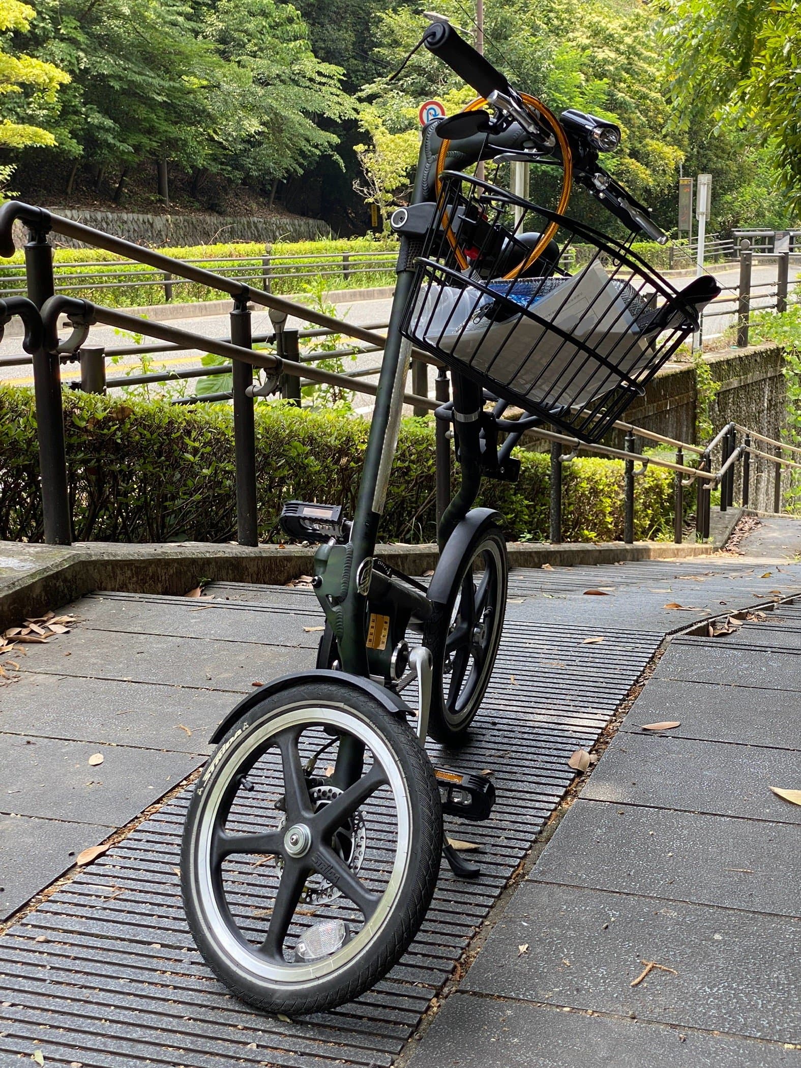

So, it’s a super luxury (although it’s a reasonable price since it’s second-hand) item, but I got the my second STRiDA LT-CAMO…
I love the my first MK1, but she’s a very very old lady, so I’m worried about the durability and replacement parts around the BB and drive system, so I’m going for a practical one… I think the riding feel is the best, so I went for it.
I also purchased a Rixen basket separately and installed it.
The temperatures have been abnormally high over the past few days, so it may be difficult to find the right timing, but I’m looking forward to going for a bike ride on her. :wink:

I rode my STRiDA LT for a little over 10km in the morning before it got too hot… I was too naive and it was so hot :hot_face::hot_face::hot_face:
I wonder where the rainy season has gone…It’s still June, but the hot midsummer has suddenly arrived… :sob:
And the place I went to was closed… :scream:
I felt it was more solid and hard than the MK1
Also, the brakes are really effective, so if you don’t apply them gently, it will lock up and you’ll say “I can fly!”
Like a mamachari, if you put too much luggage in the basket, it will affect the balance of the bike, so you have to be careful about that
It’s probably better to carry the heavy stuff on your back.

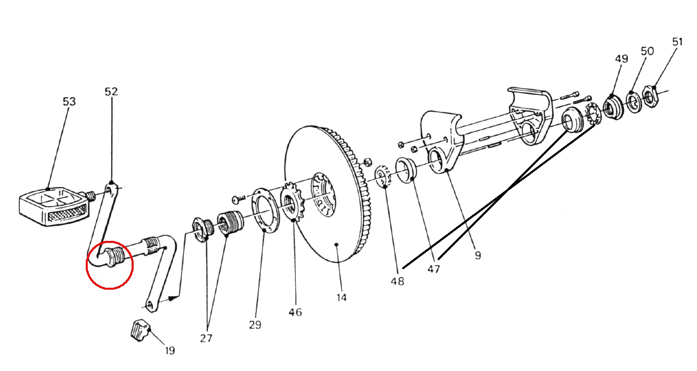

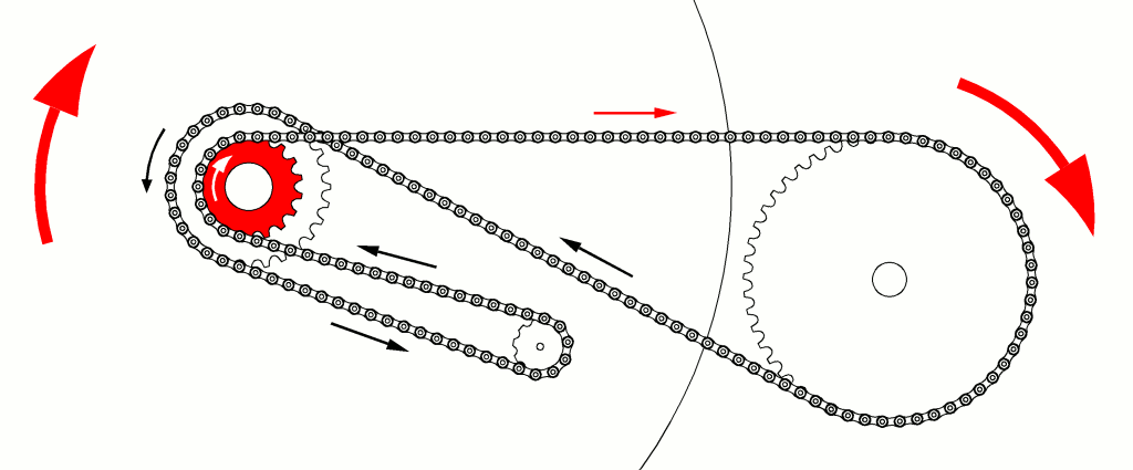

As mentioned - technics weirdo here - what kind of data do you think to need? :thinking:
And I mean to understand that as a cartridge bearing (like pushing a shell into a barrel), more or less one part with all bearings, to be pushed into the bottom bracket housing.
The Fauber bearings are different, there is even the chance to adjust the bearing play.
(Edited a little bit.)
Important to watch is the odd position of the freewheel inside of the front beltwheel - instead of a pulley at the rear.
It reminds me somehow on a retro-direct drive:
chain_anim_1024
Anyway, to use the freewheel like that, it’s necessary to mount it from the left side, in fact the opposite side as usual. :nerd_face:
I believe that is the biggest problem if you want to install a cartridge bearing. You had to create a part which allows the mounting of the freewheel onto the axle - before the right crank. :face_with_monocle:

Thanks for the reply and the drawing! :folded_hands:
I’d like to draw a diagram, but it’s a bit too hot for me(The current temperature in Kyoto is 34 degrees Celsius :hot_face:)…
So I will just state my delusions… :joy:
What I’m thinking is to reversibly replace the (proprietary) drive parts of the old STRiDA with generic parts that are still around and will likely be made in the future.
Yes, you’re right, and so I wonder if I can fit a generic bracket with a BSA standard 68mm width and 34.8mm thread into the STRiDA cast or plastic bottom bracket and somehow attach the freehub and front pulley to that axle, etc…
If it were possible to make the rear freehub, I would fantasize about replacing the “cast or plastic BB housing” itself with a 3D printed part that is tailored to the STRiDA eccentric BB (eliminating the room for adjustment via screws and shafts), but this would also be impossible, as it would be difficult to somehow make use of the rear drum brake while equipping the rear with a belt freehub due to the inner diameter of it. :face_with_spiral_eyes:

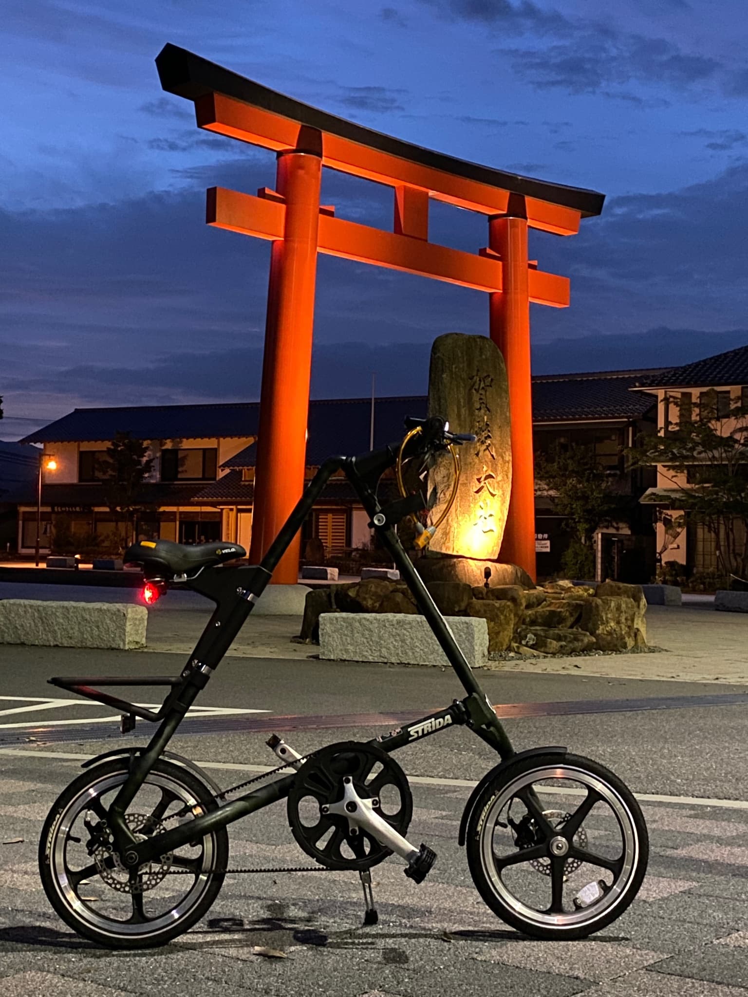

So I took the STRiDA out for a test drive while I was out shopping and checking out the rice fields. :person_biking:
Hmm, it’s not bad, I guess? :thinking:
I don’t have a hex socket that fits the torque wrench, so I’m a bit worried about the tightening torque though… :roll_eyes:

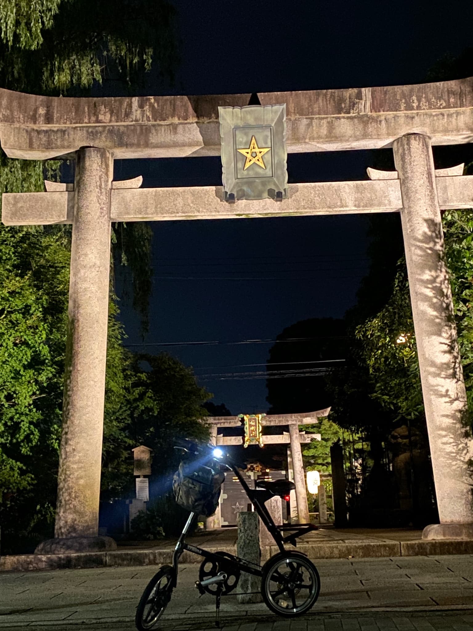

The temperature has been so high recently that I’ve been enjoying pottering from late at night to early in the morning. :sunrise_over_mountains:
I managed to take some great photos that are typical of Kyoto (Japan), so I’d like to share them with you. :shinto_shrine:
Cheers! :beer_mug:

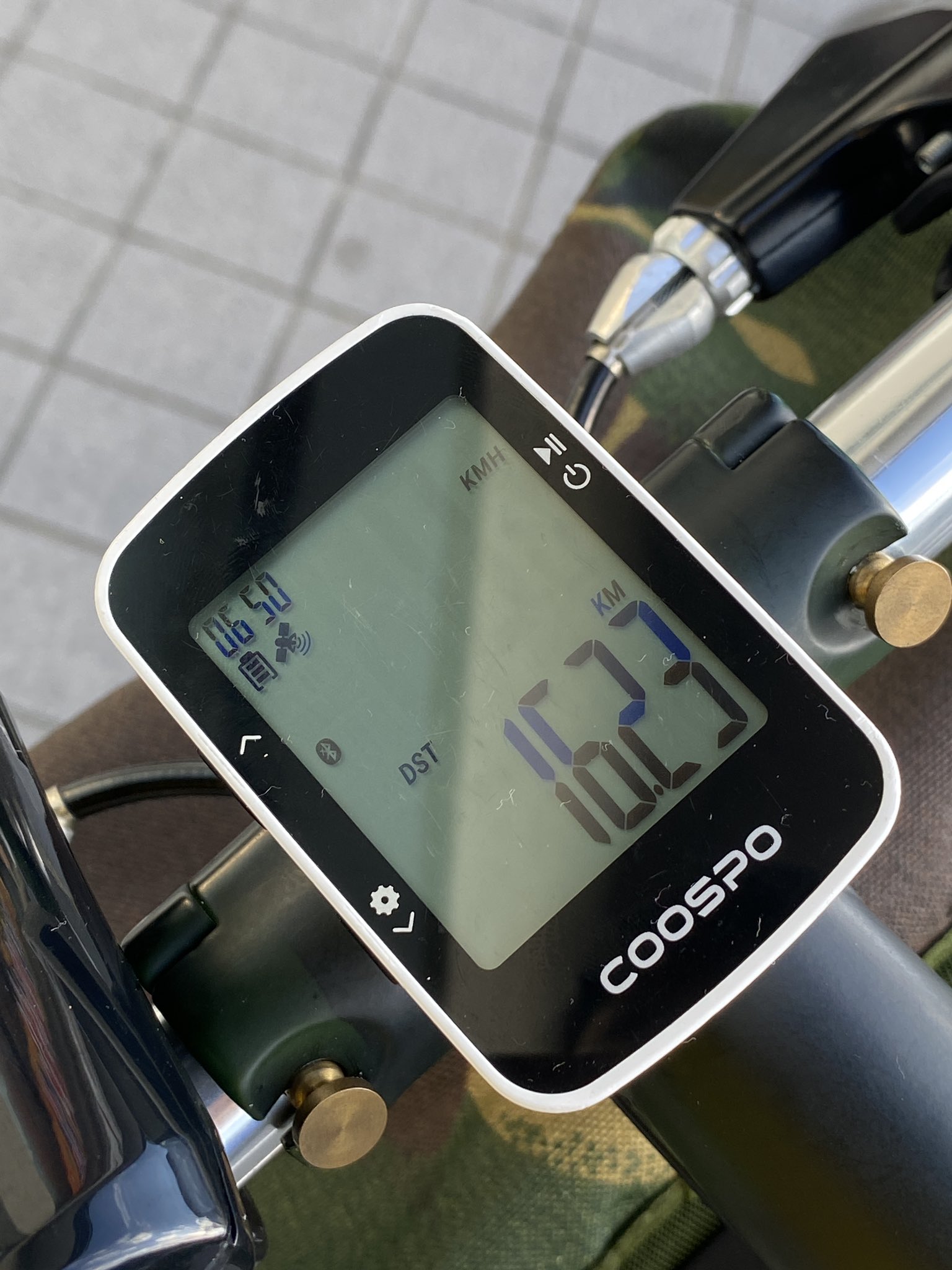

When I’m pottering around I always want to know the (more accurate) distance traveled and speed. :thinking:
Sensor-based cyclocomputer are difficult to attach to the STRiDA, which has small wheels, a unique frame shape, and stem and handlebars far from the wheels, so I decided to use the inexpensive GPS cycle computer CooSpo BC26 (roughly 3,500 yen, or 20 euros, on Amazon).
It has more than enough functions for a mini velo, including a clock, riding time, speed, and distance traveled, If you link it to the smartphone app, you can also see your travel route.
And the mileage keeps increasing… :motorway:

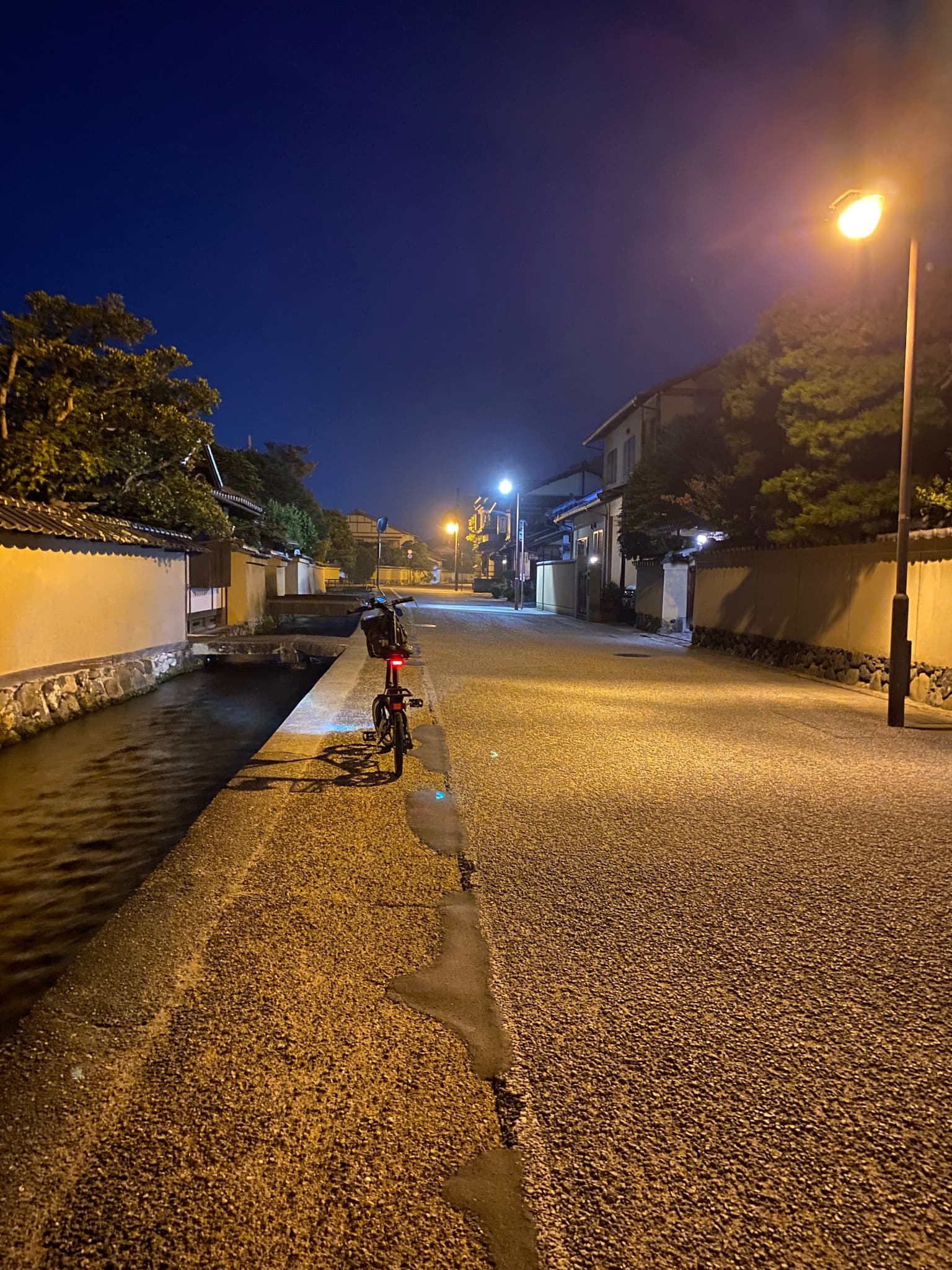

I’ve attached a photo from my pre-dawn ride the day before yesterday. :shinto_shrine:
Doranine

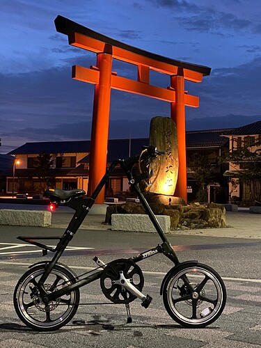

Happy riding! :person_biking:

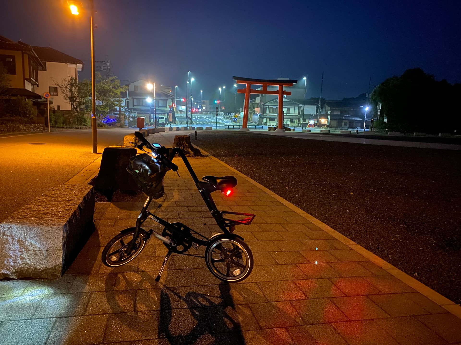

As usual, my pre-dawn shrine tours are going well. :shinto_shrine:

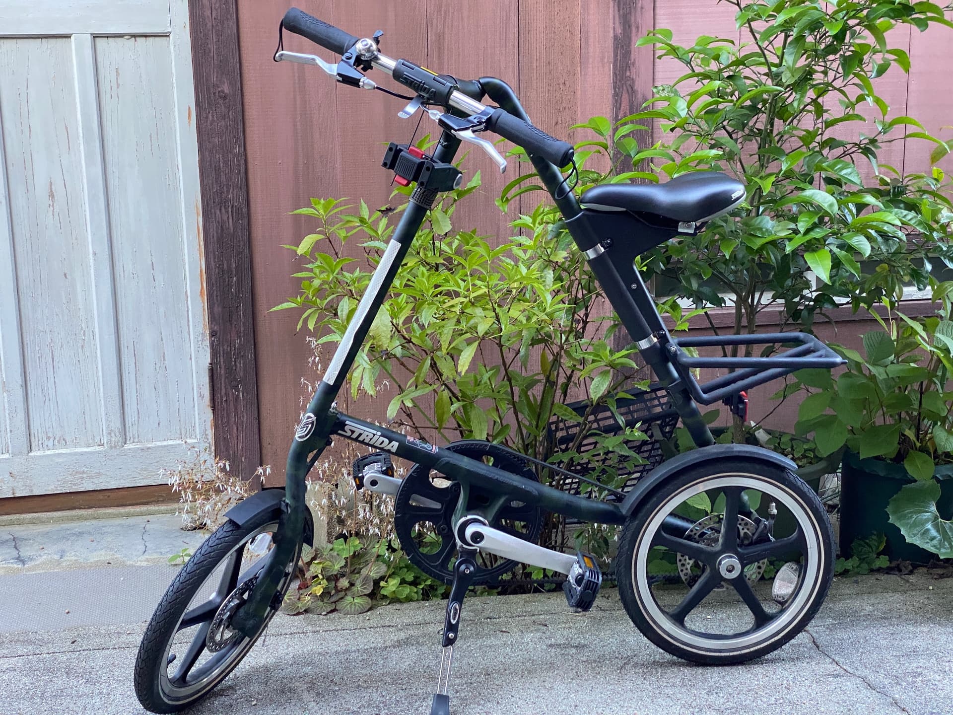

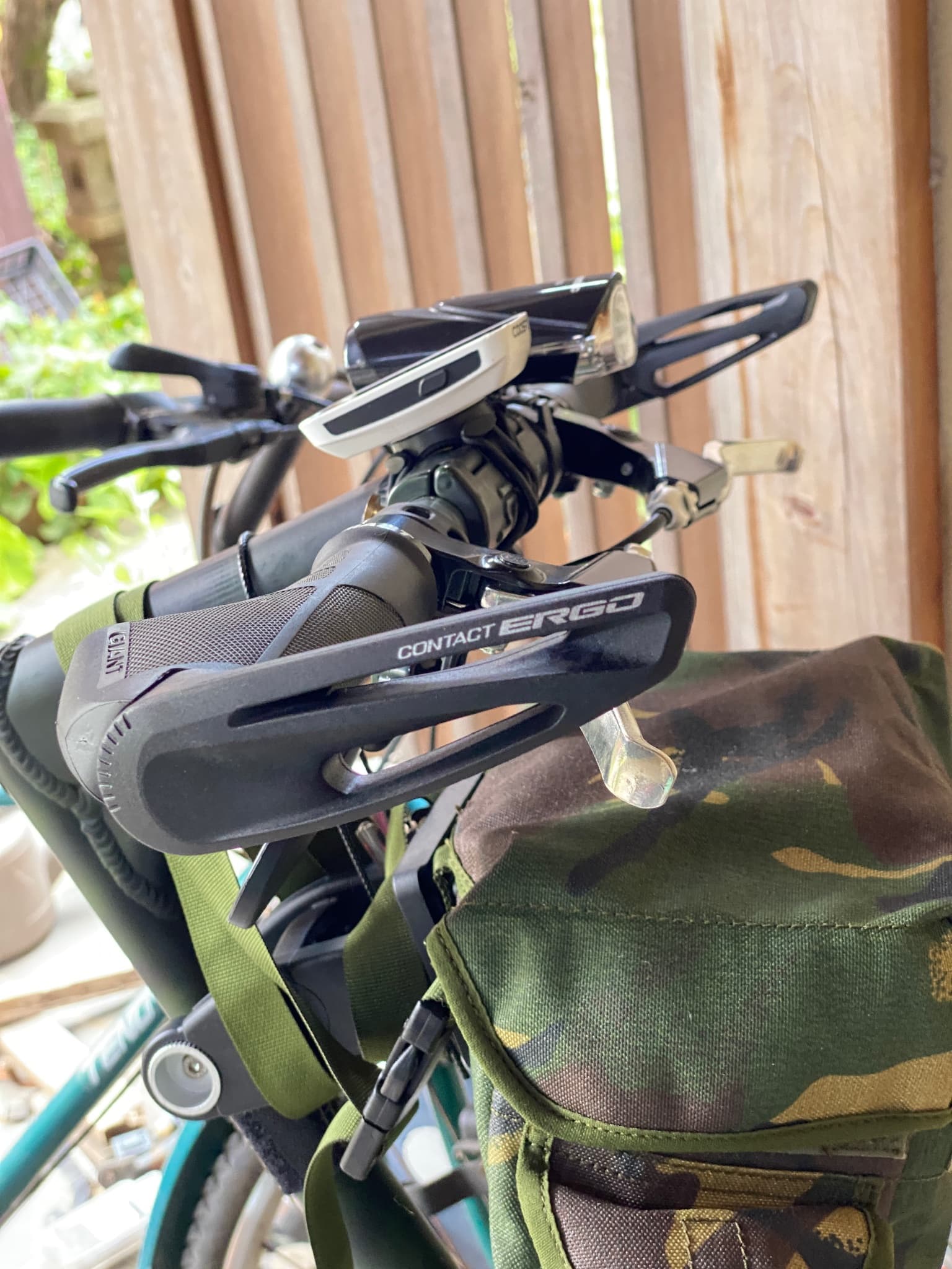

Considering my riding position, I thought it would be a good idea to install bullhorn-like bar ends, so the other day I bought some Giant ones at a local bike shop and had them installed.
After that I rode it for a bit and it felt a lot easier to start pedalling and climb hills.

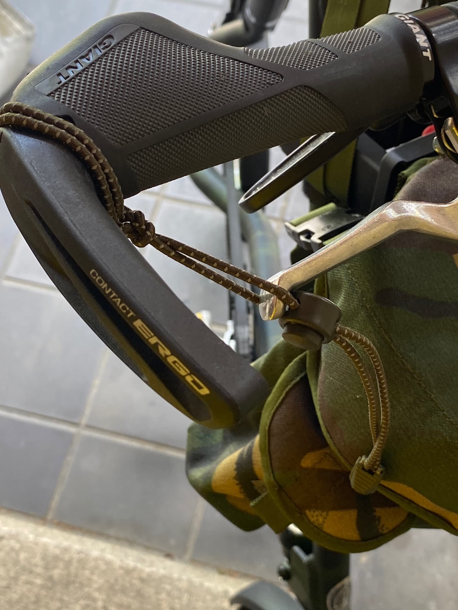

If you attach a bar end like this, you will lose the parking lock string and will not be able to apply the parking brake.
So I did this using no-tie shoelaces, a rubber cord with a stopper.
Normal non-elastic nylon cord might be better, but products like this are cheap and easy to get from outdoor shops or Amazon.
This rubber cord also contains reflective material :sparkles:, which may make it a little safer at night. :woozy_face:
