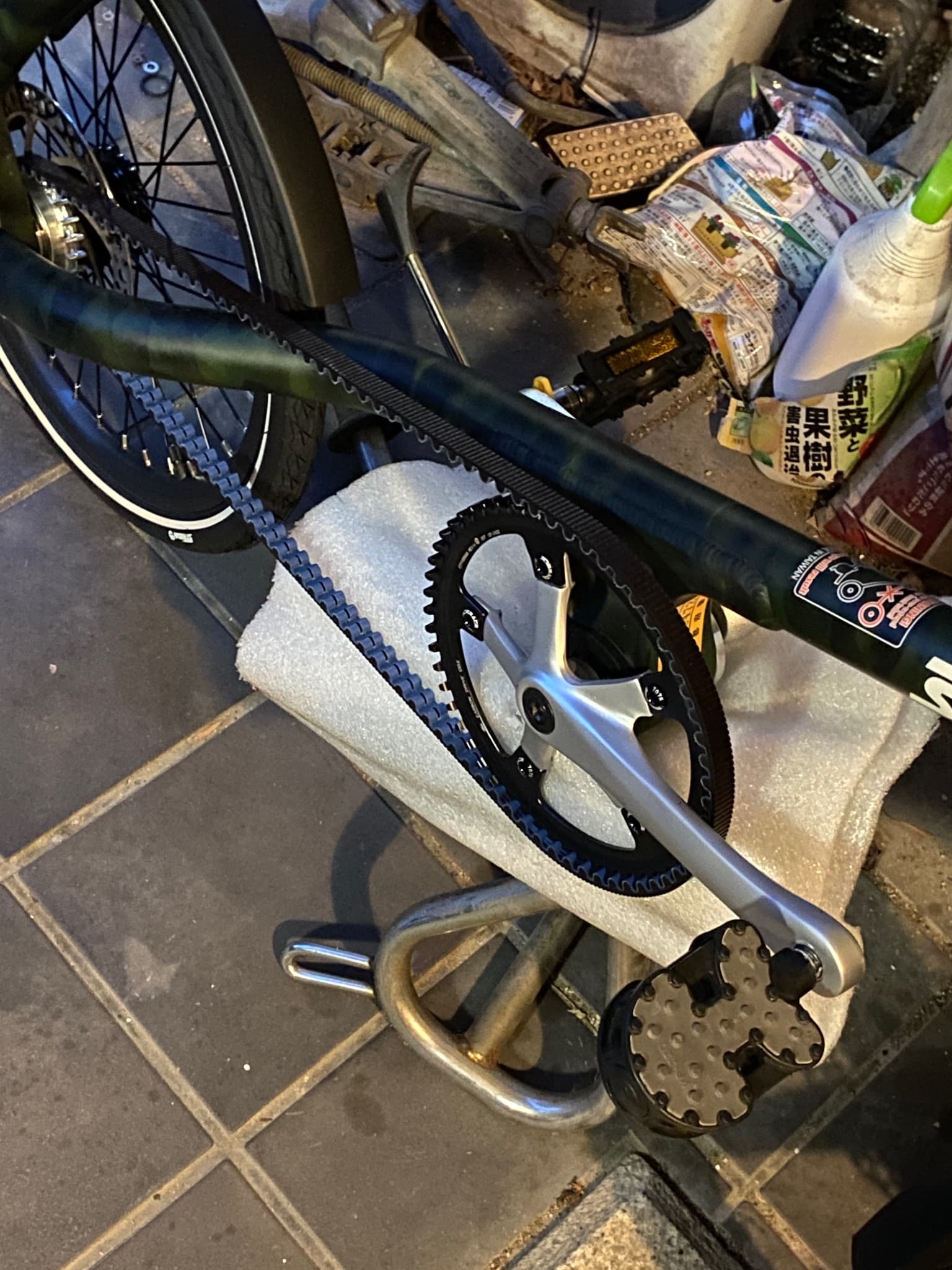

As with most drive sysytem maintenance, I placed the bike upside down on a mat to prevent damage to the handlebars.

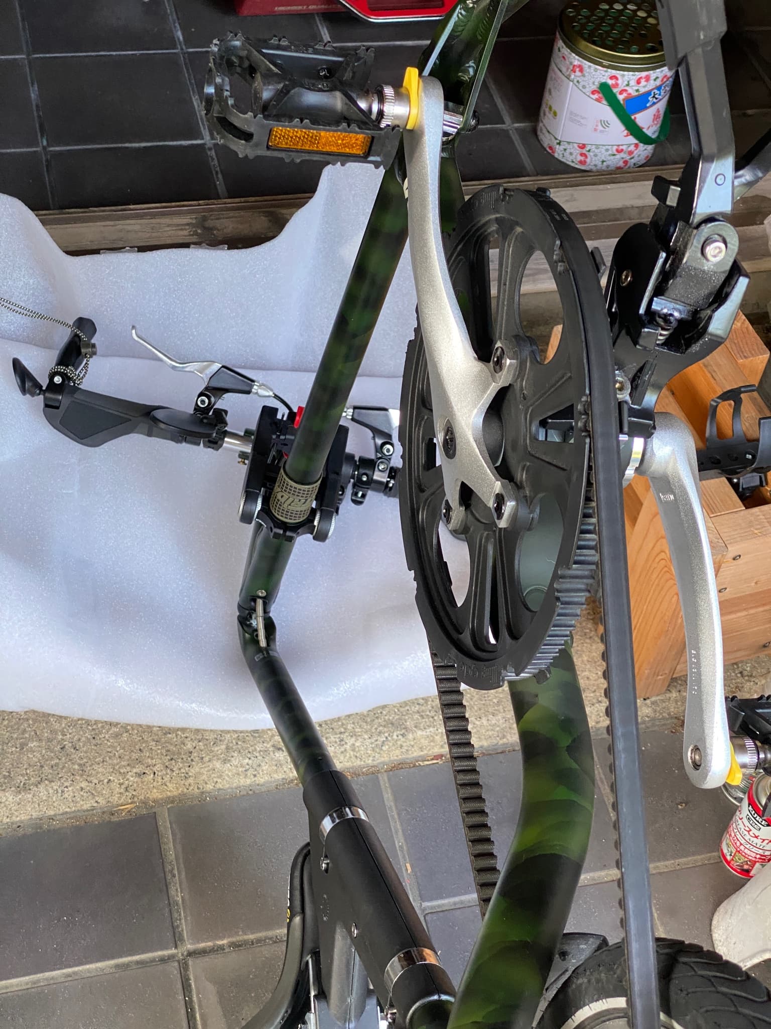

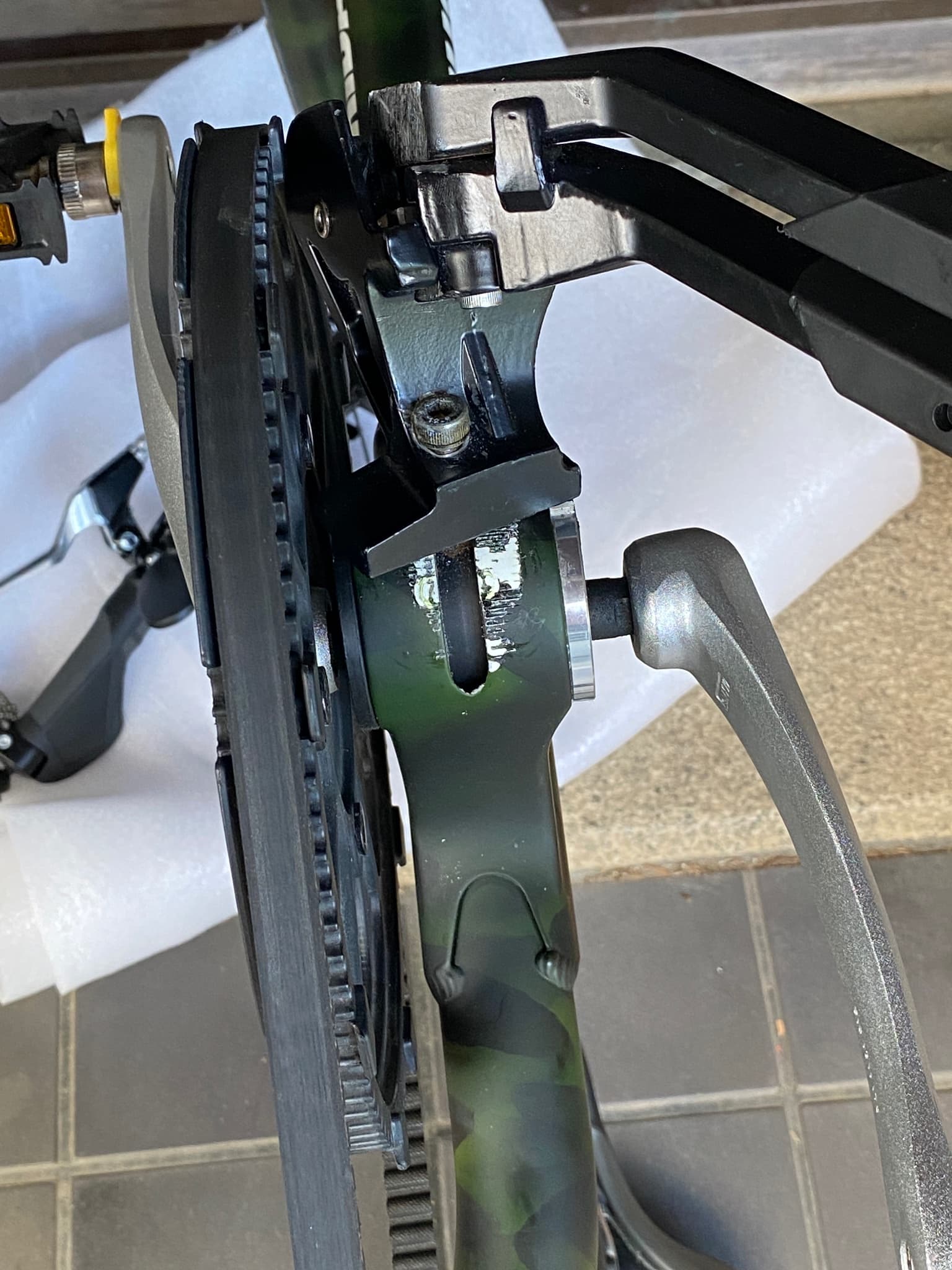

Remove the stand and loosen the BB retaining ring with an O-ring wrench, then loosely reattach the stand and use it as leverage to shift the BB and loosen the belt.

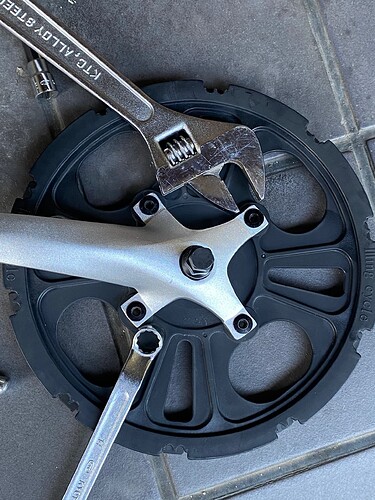

Remove the right crank bolt with an 8mm hex wrench, screw in the cotterless extractor, secure it with an adjustable wrench (because the tool’s nut is an odd size), and then tighten the separator bolt with a 14mm wrench to remove the crank from the BB axle.

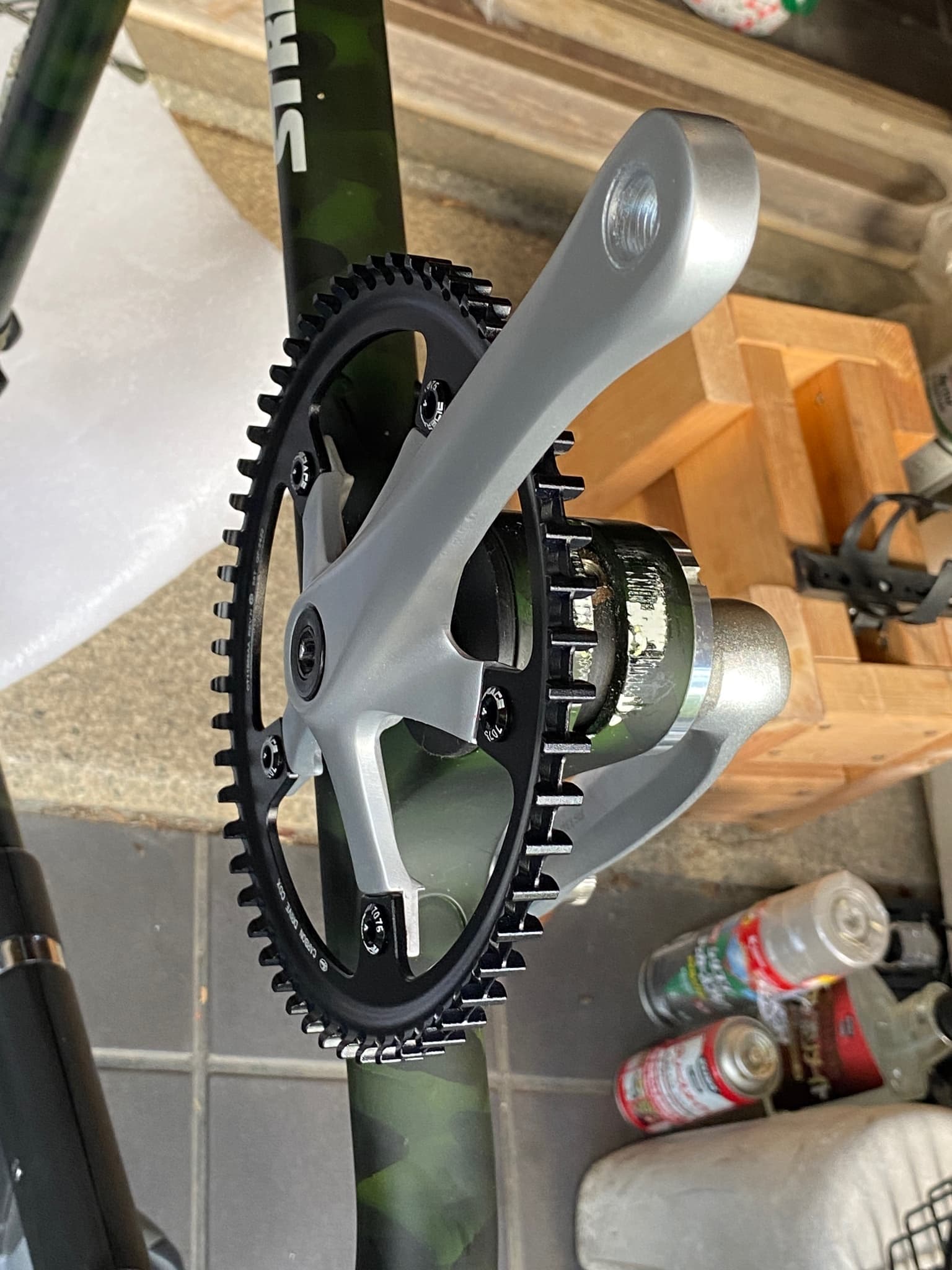

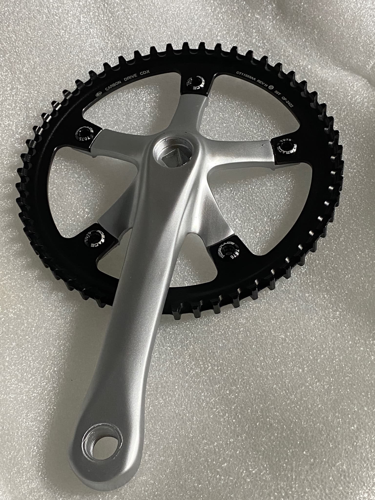

Instead of the original, install a junk Sugino right crank roughly painted silver with spray paint and a CDX 55T ring.

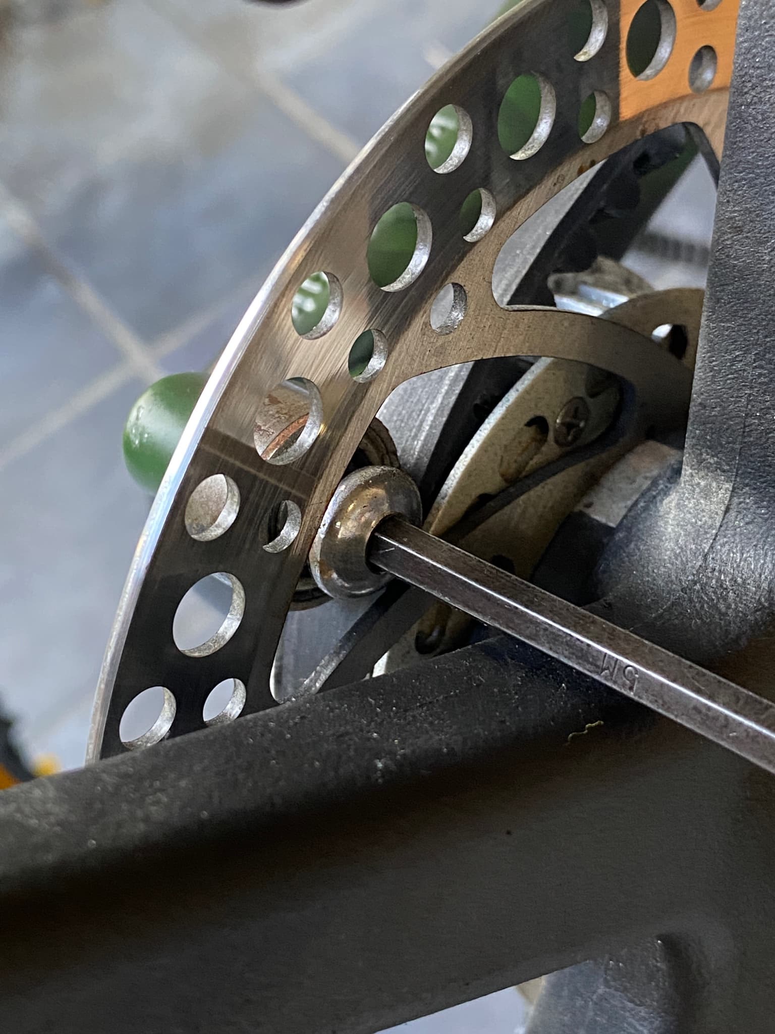

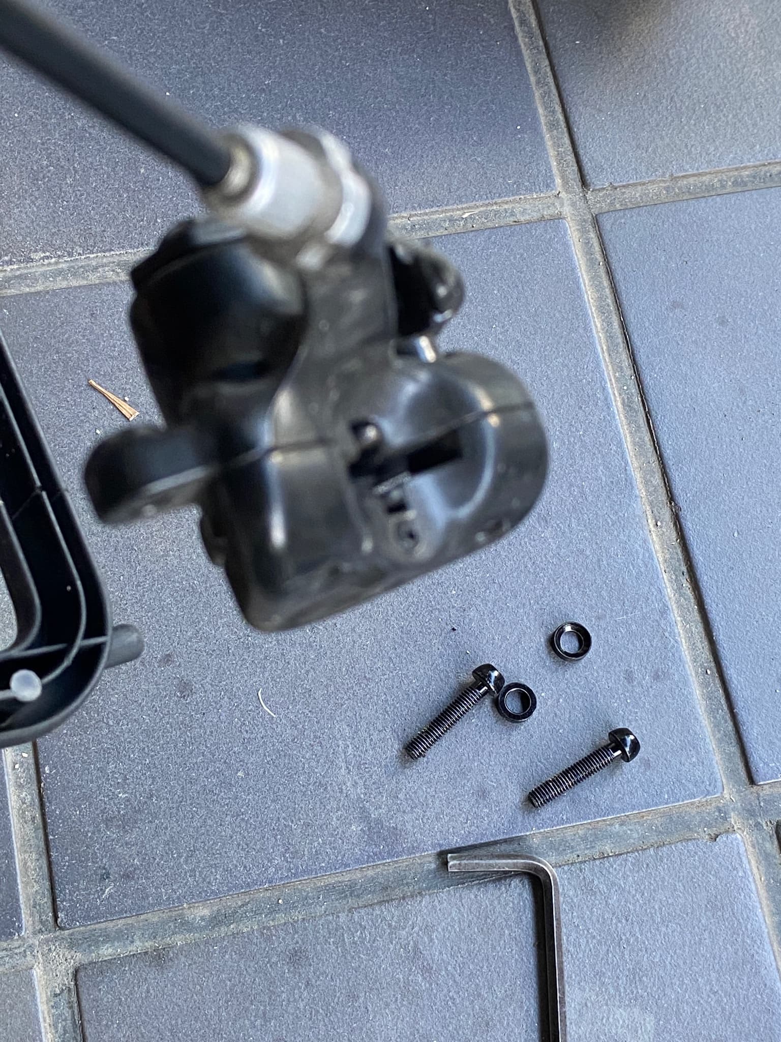

First, remove the brake caliper bolts with 5mm hex wrench.
Be careful not to lose the washers and adapter rings (mine had the washers stuck to the frame).
Next, loosen the bolts with 5mm hex wrench from the gap between the spokes and disc and remove the belt tensioner.

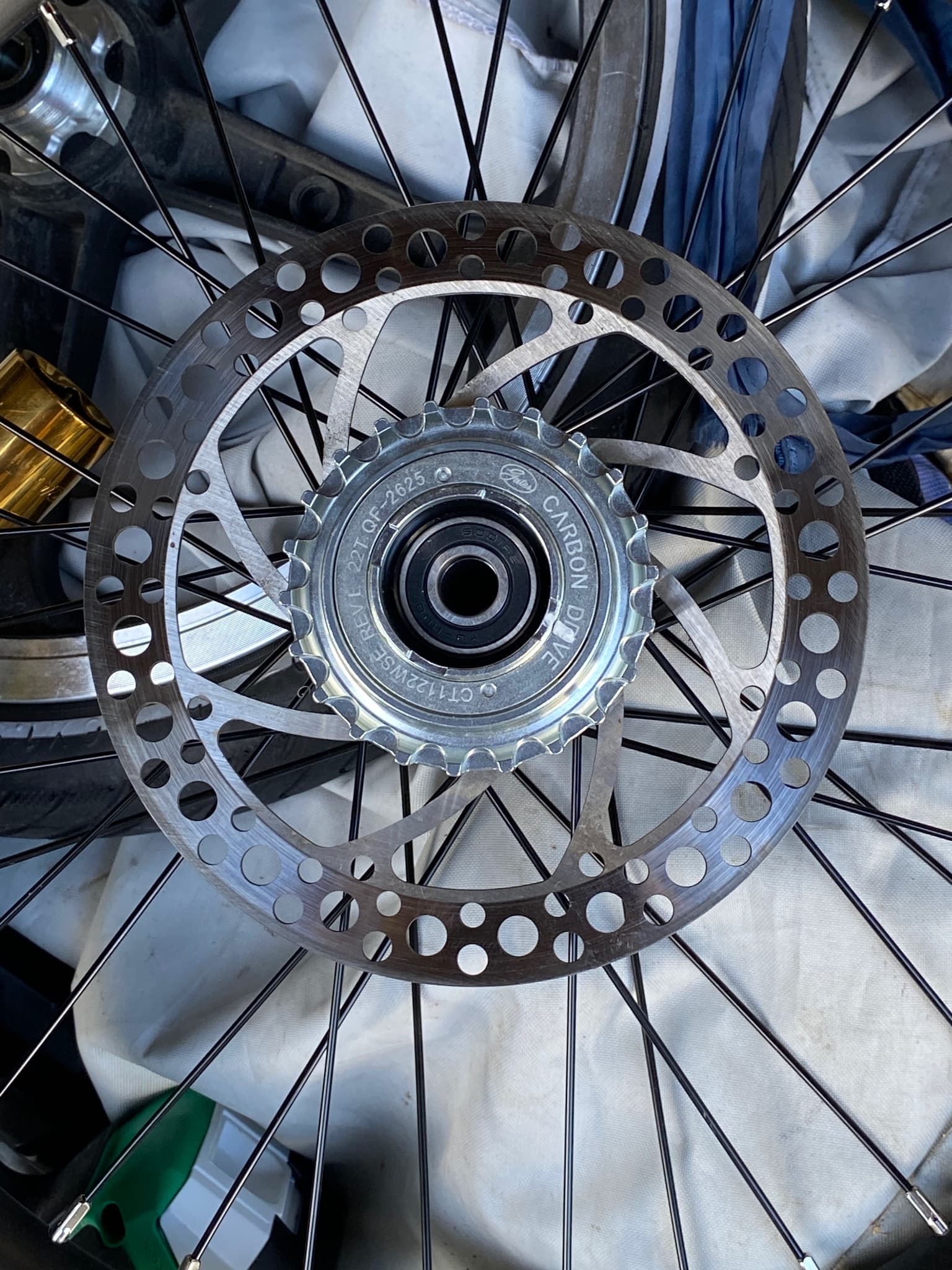

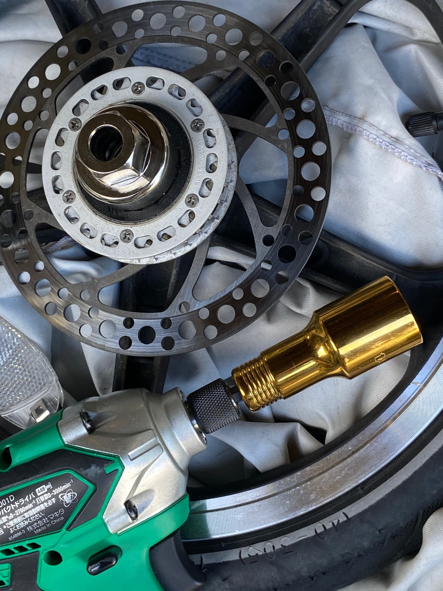

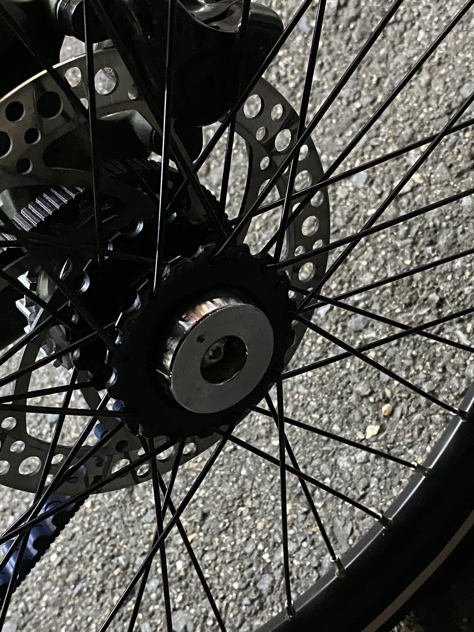

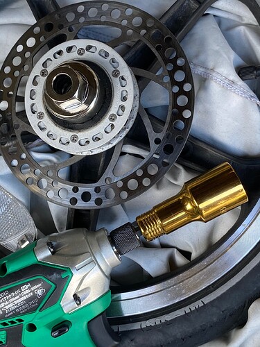

Attach a 24mm socket to the impact driver and insert it into the 24mm part of the freewheel removal tool. Loosen and remove the freewheel cog, then remove the brake disc that is being held down by the freewheel.
I’m also upgrading to an 18-inch rear wheel at the same time, so I’ll fit the removed disc onto an 18-inch wheel and secure it with a 22T CDC free cog.
The reason I used a CDC cog was because I didn’t have any CDXs available for purchase…hopefully this won’t be a problem later…
There’s no specified torque, but it tightens automatically as I pedal, so tightening it by hand seems sufficient.

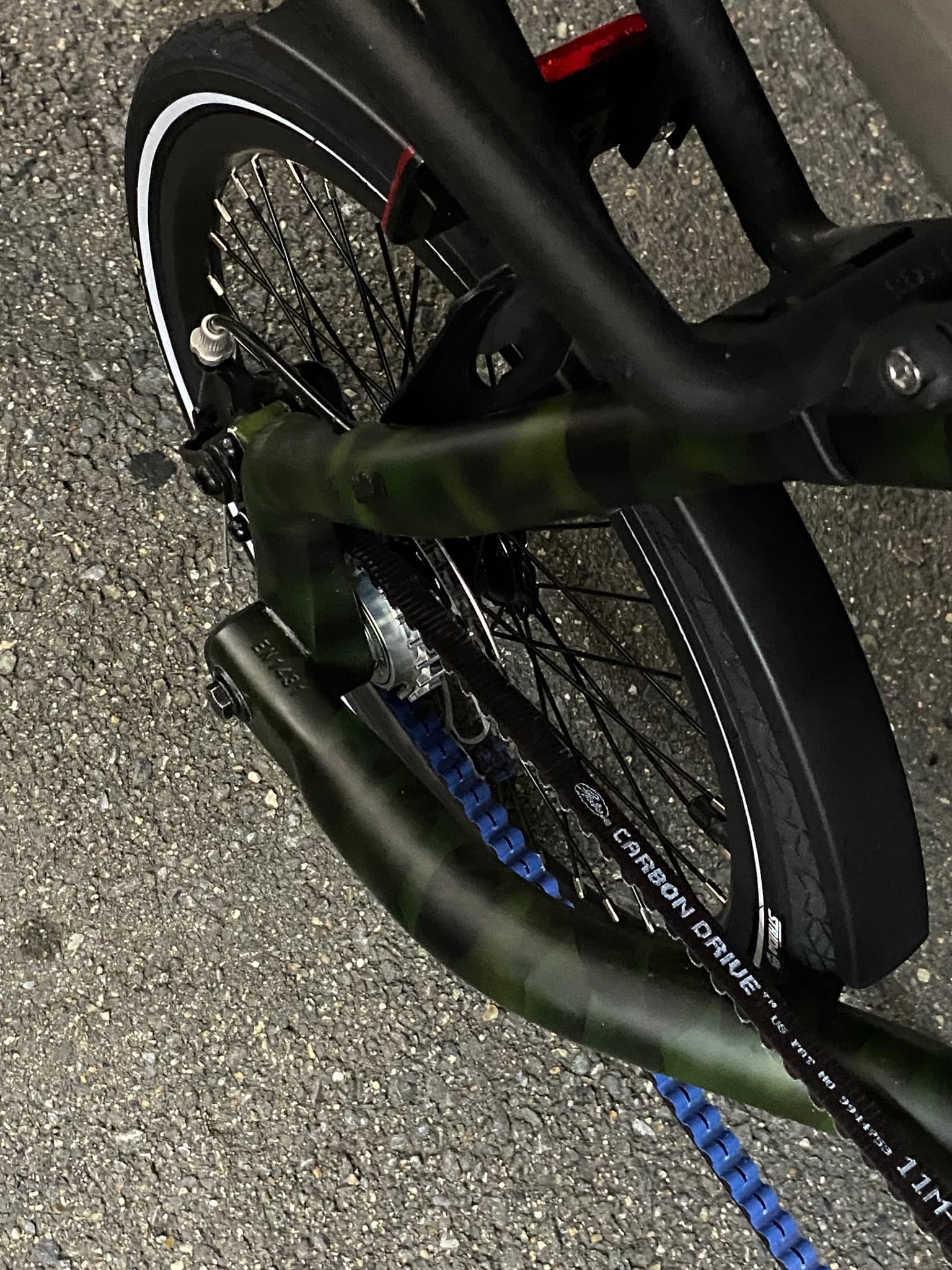

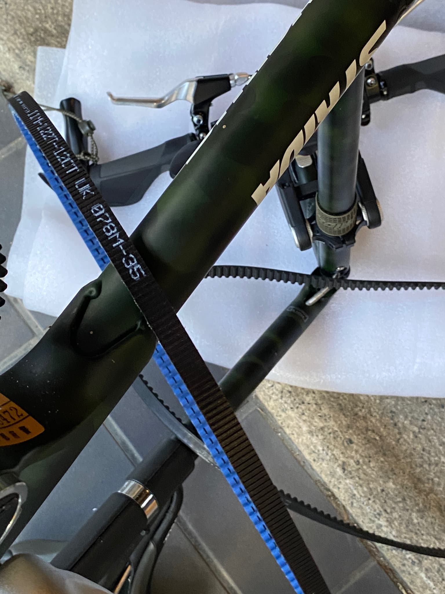

I removed the folding joint, removed the original belt from the undertube, and threaded the CDX belt through instead.

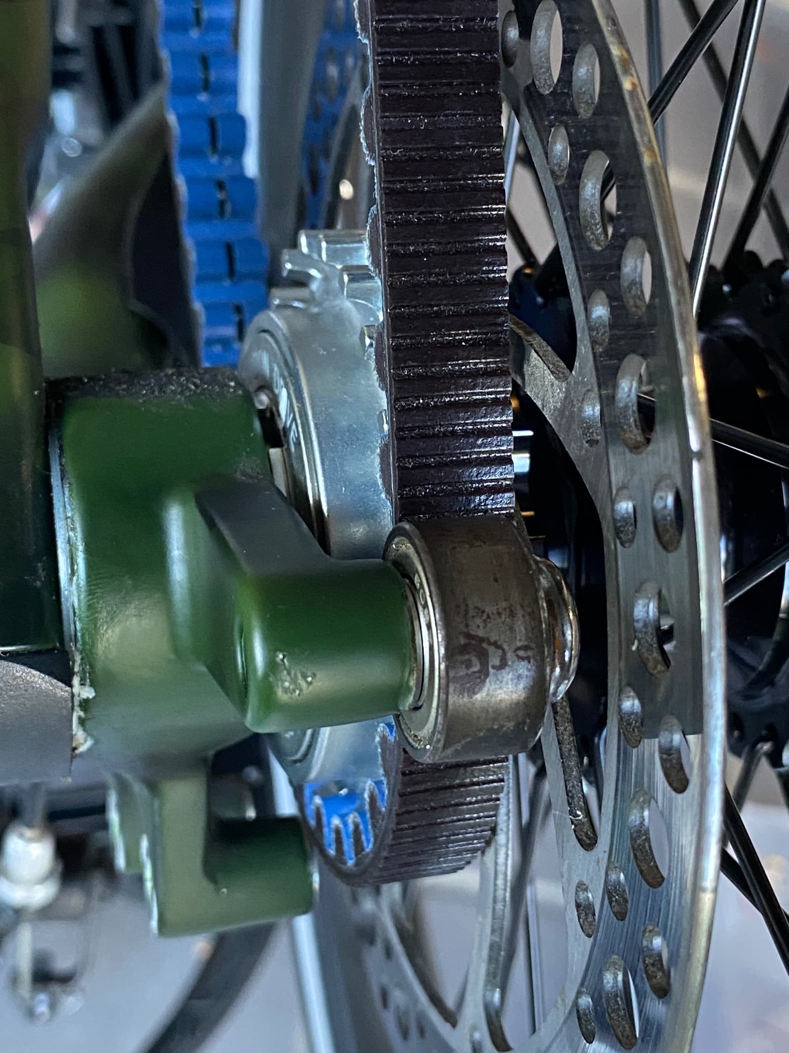

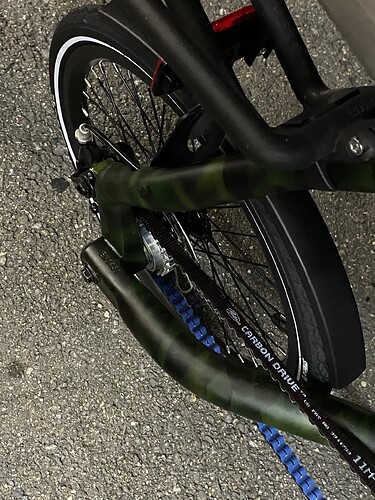

I’ll put the belt on the cog and attach the tensioner (I was able to use the original tensioner for the 22T cog, but according to the Gates manual, there needs to be a gap between the tensioner and the belt so that it doesn’t touch it).

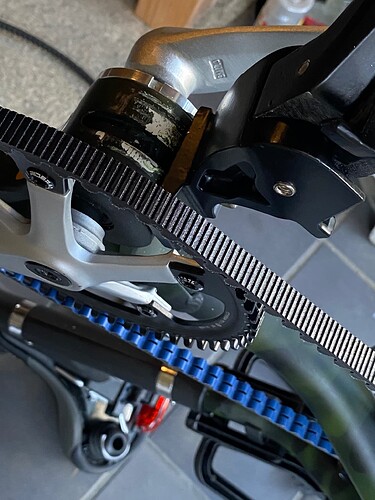

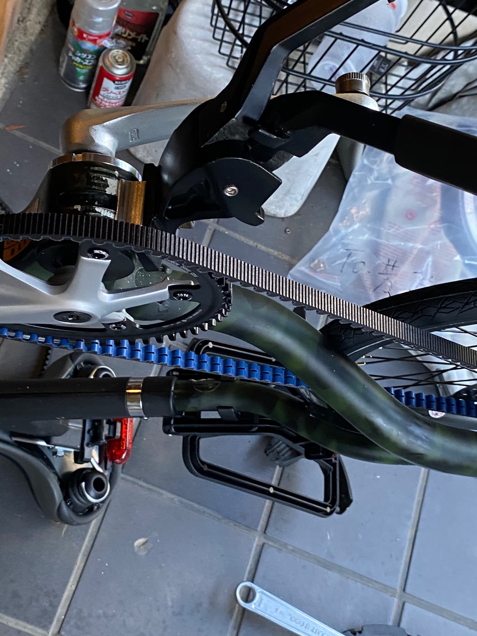

I hooked the belt onto the front belt ring, and after slightly hooking it and turning the crank, it gradually engaged properly. (Note: According to the Gates manual, I shouldn’t do this. It’s probably because applying lateral twisting force to the belt could damage the belt structure.)
Then, I temporarily attached the stand and used it as leverage to adjust the belt tension. Once I found the right position, I tightened the BB mounting ring to secure it, and then attached the stand.

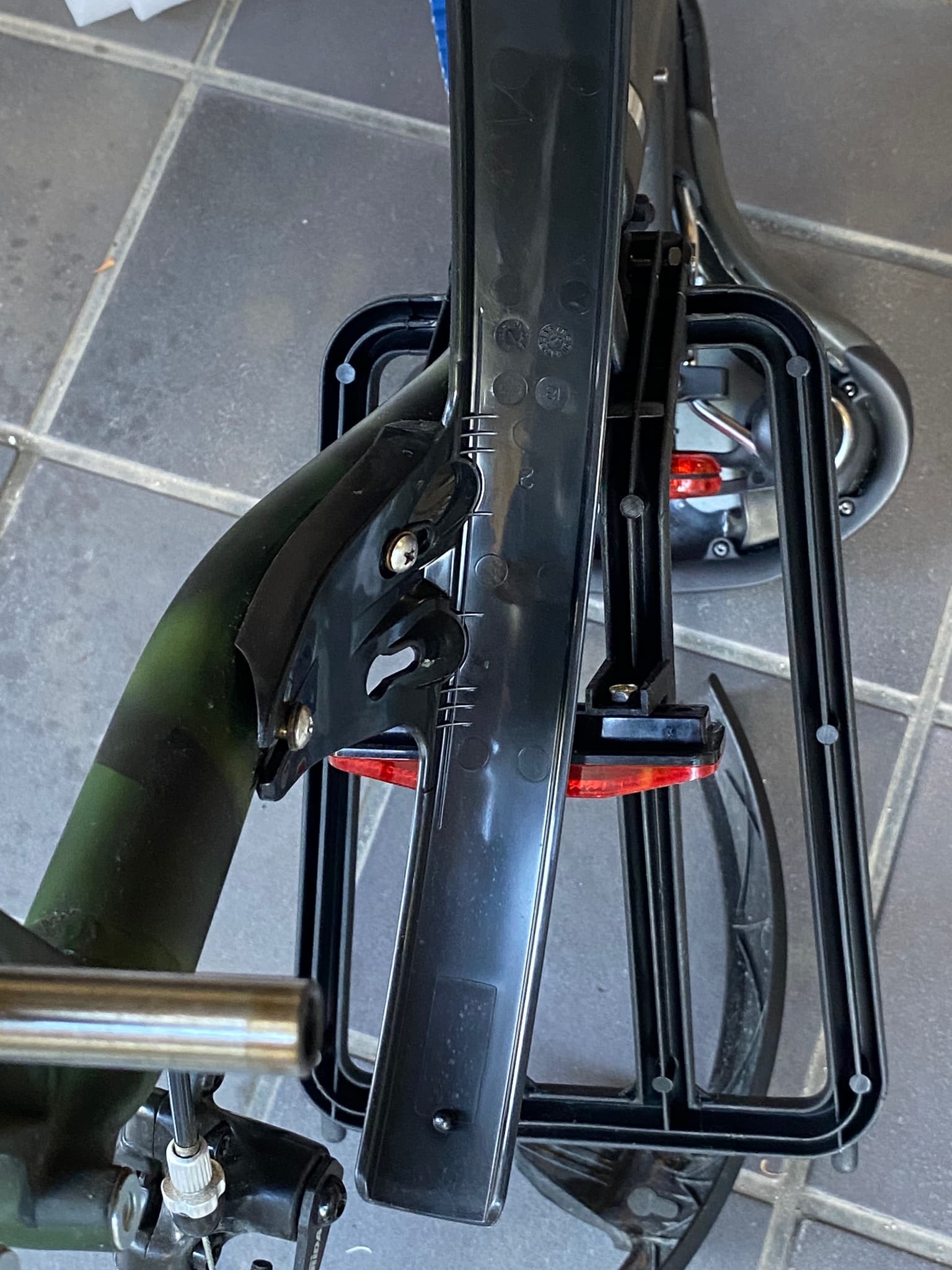

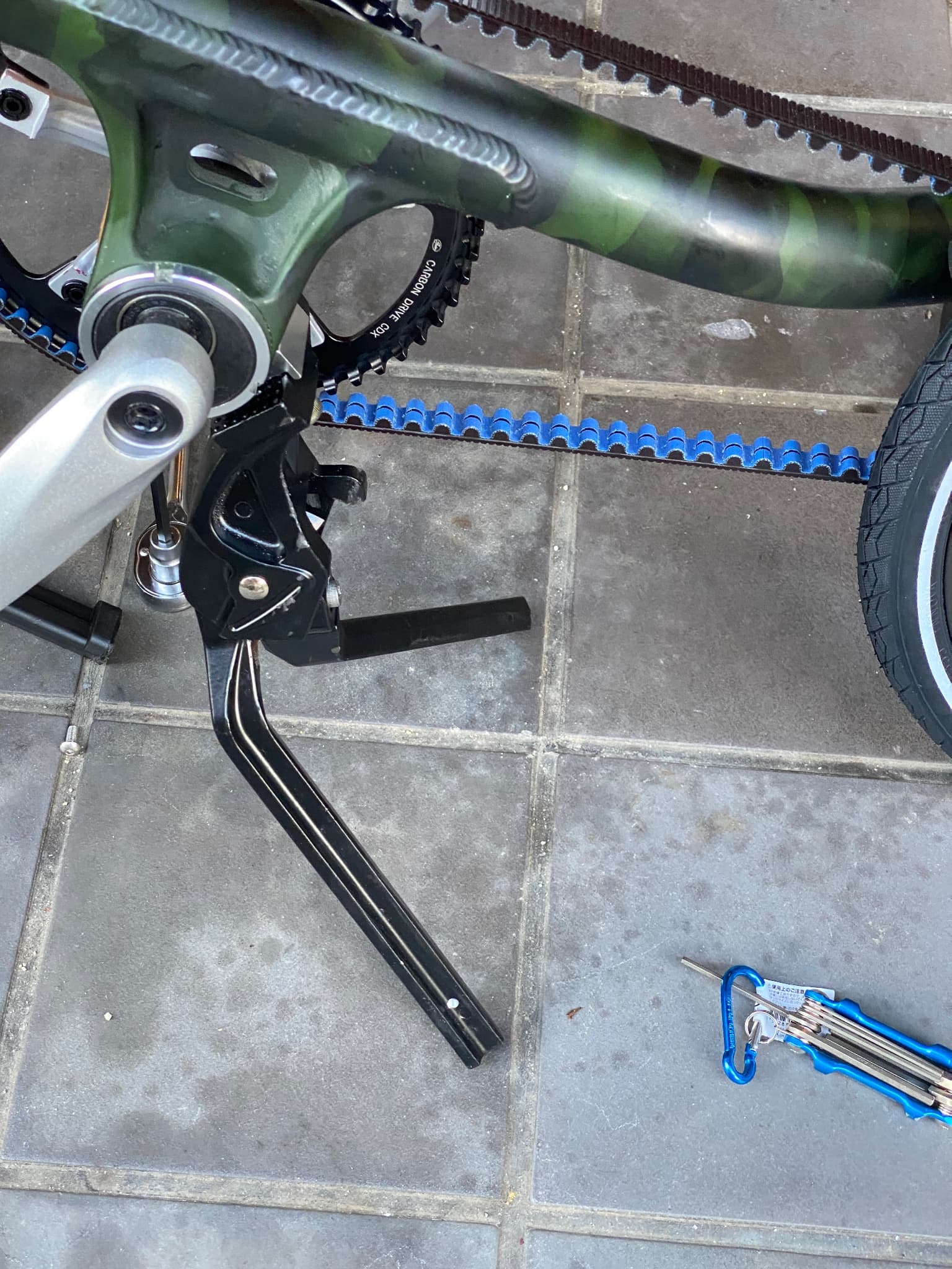

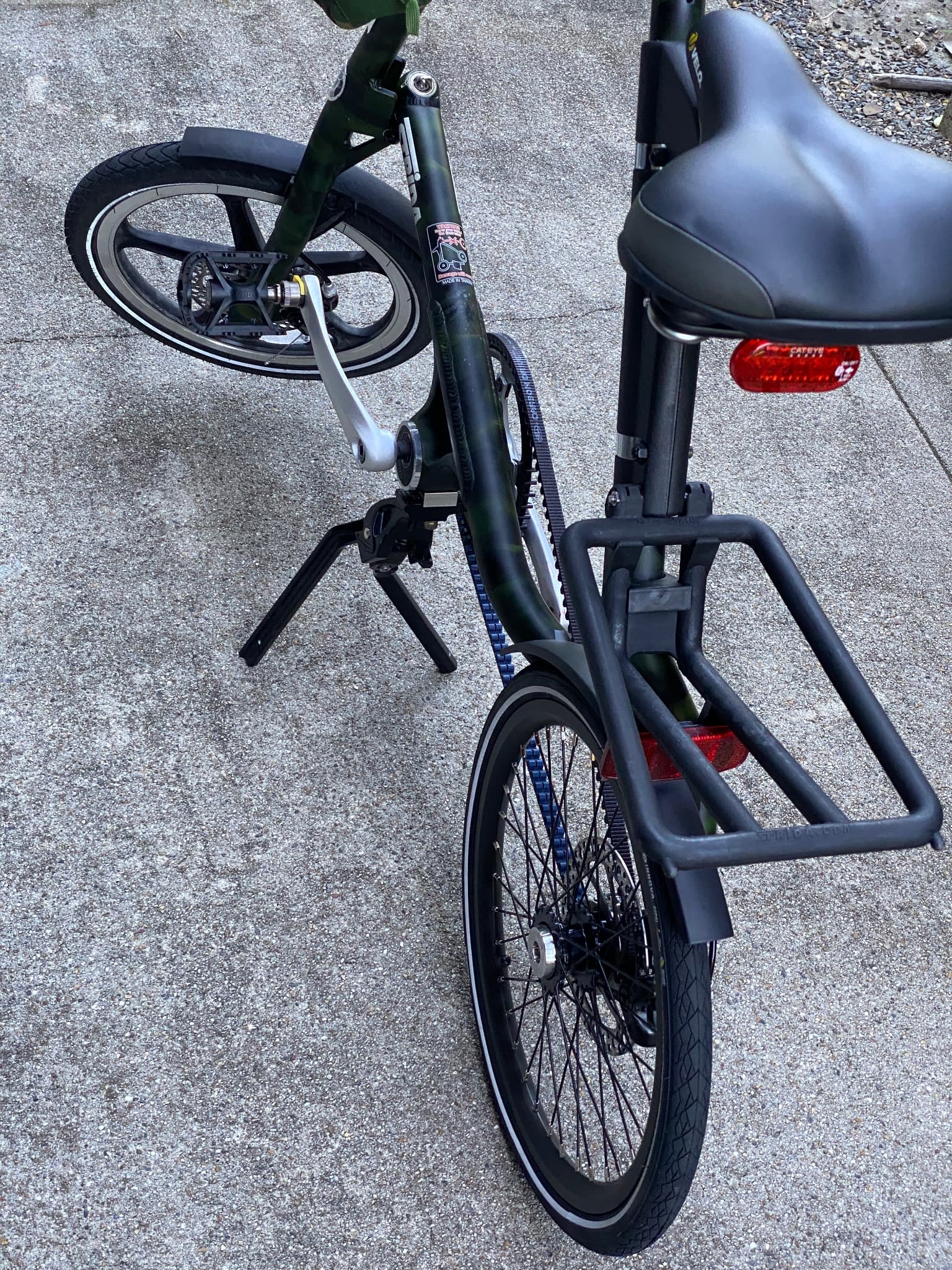

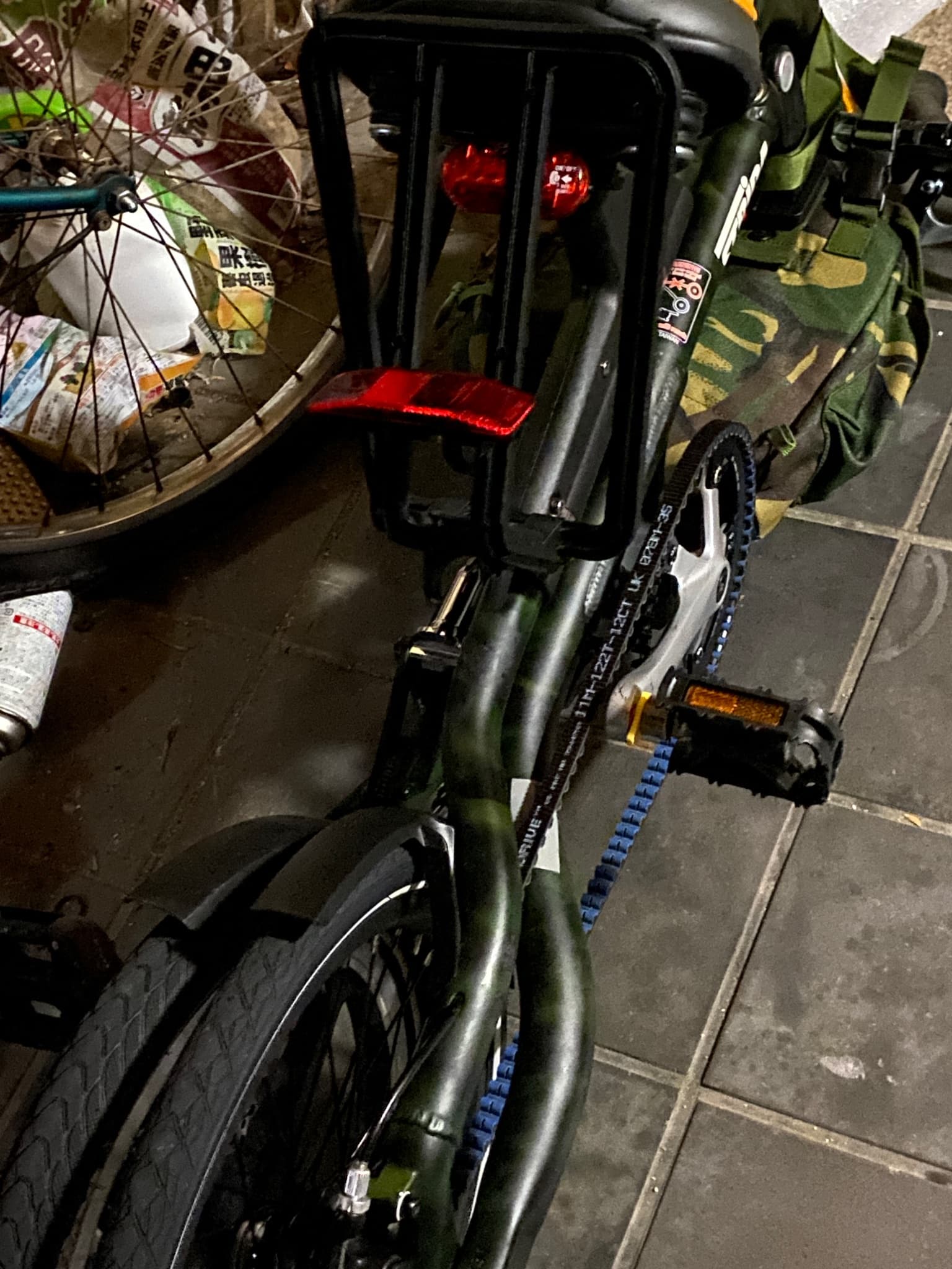

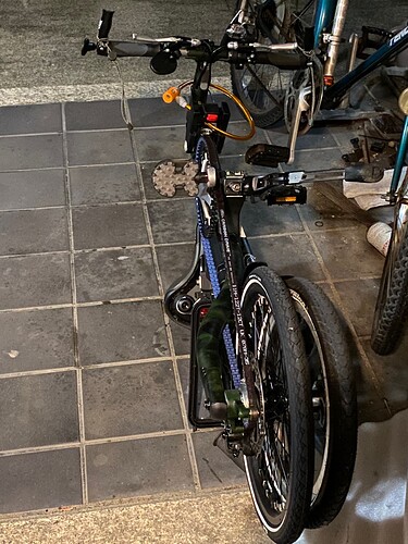

With the 122T belt, the eccentric BB adjustment was set almost all the way back, which meant the legs of the double-leg stand were too long and at a bad angle, making it impossible to hang properly… They also hit the tire when flipping up.
I guess I’ll have to cut the legs…
I put it on the stand and took a break, intending to return it to the original.
Since this was just for testing, I temporarily attached the original non-folding pedals to the Sugino cranks.

The belt clearance is really tight… I’ll probably put some tape on the bottom tube to prevent chafing just in case.

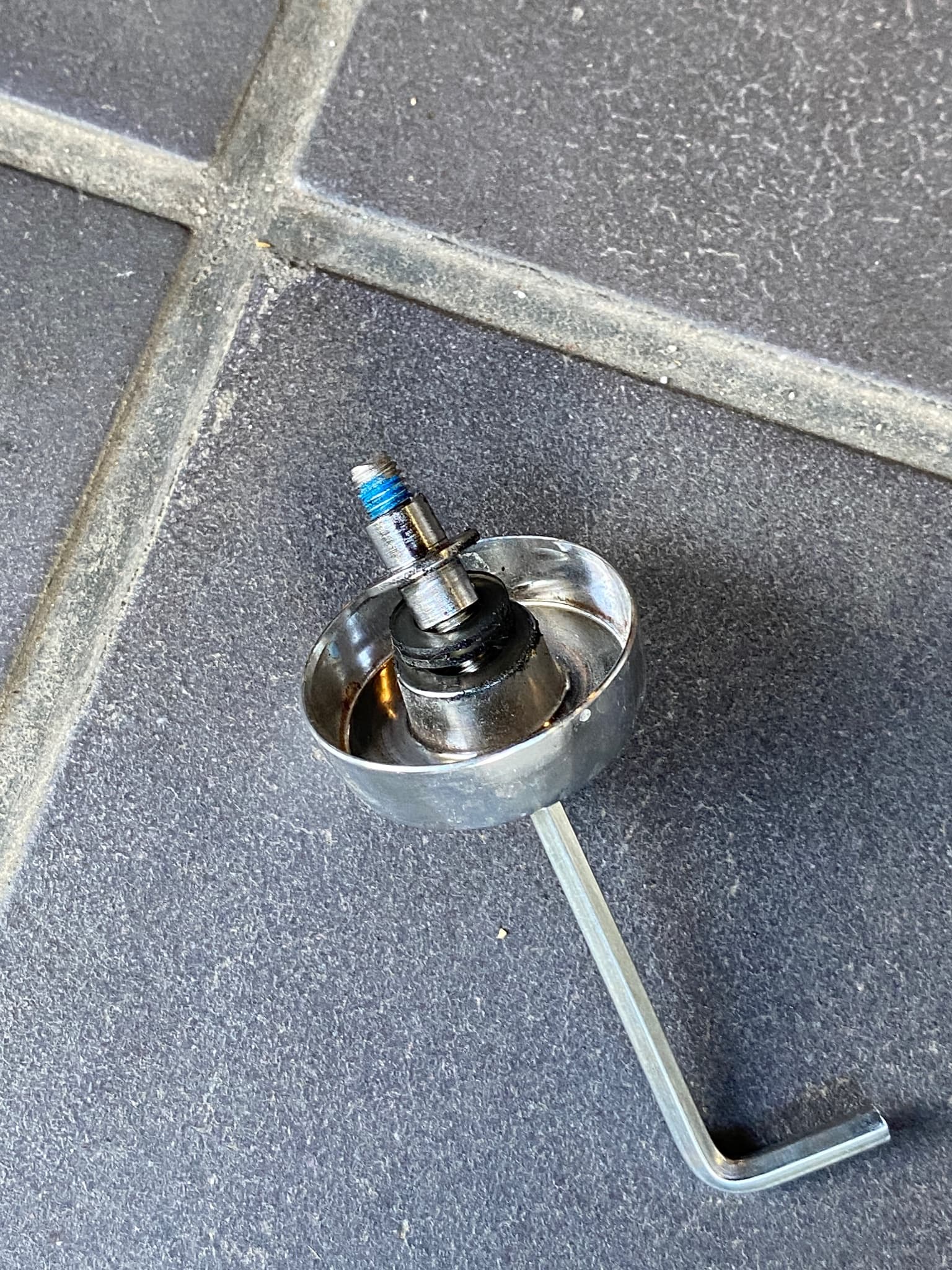

It’s also quiet… I thought I heard some kind of metallic bell-like rattle, but it turns out the rear magnetic joint is slightly floating and making noise…The bolts are tight enough…
The stock stand is too extreme in position and won’t hang properly. I need to come up with a more drastic solution.

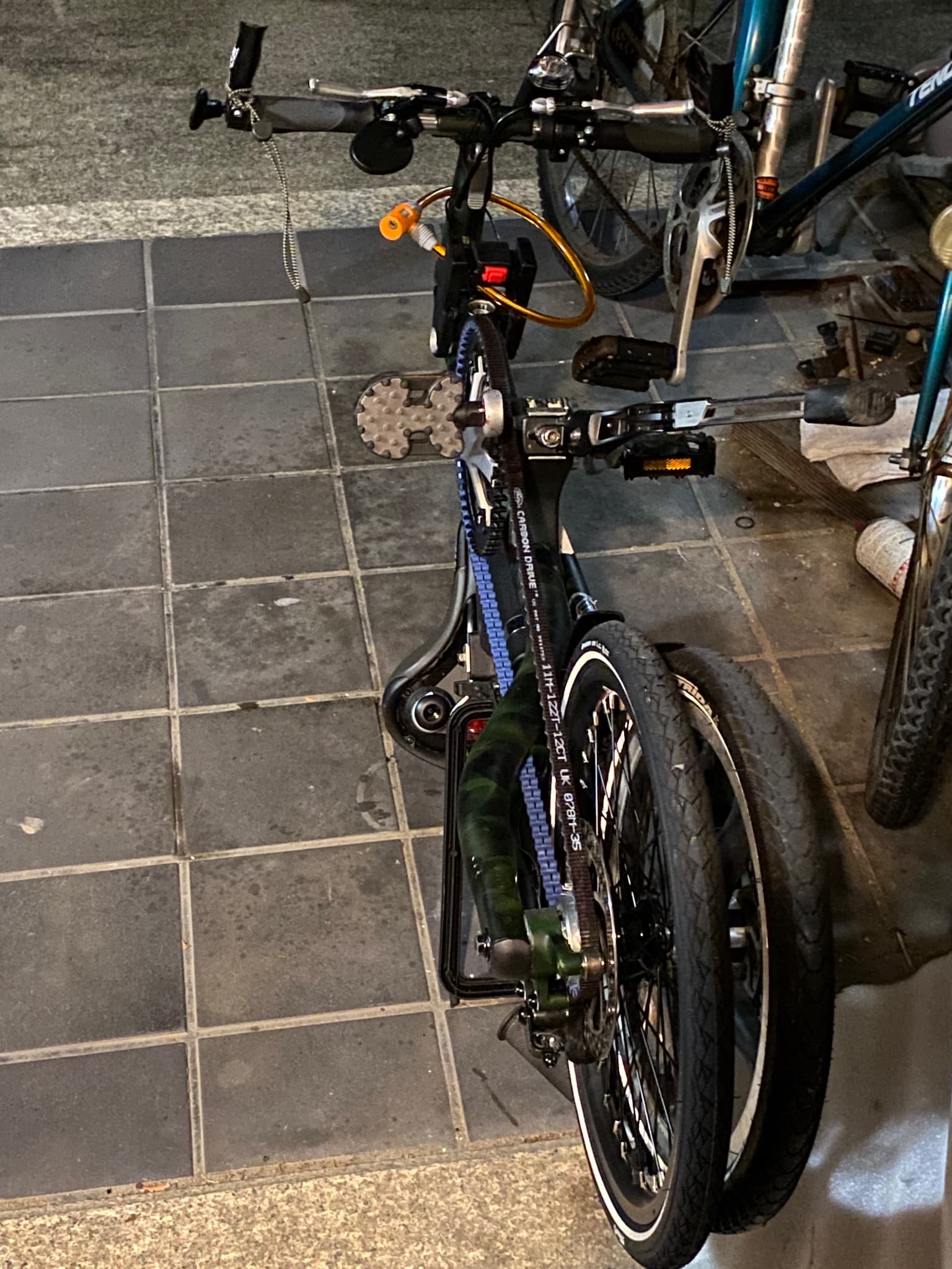

I went out for a test drive in Mayonaka (the middle of the night).
It looks like it’s parked securely, but it’s really unstable.:shaking_face:
The ringing sound is definitely coming from the rear magnetic joint (or its cover?).
The rattle coming from around the bottom bracket was due to the aluminum bolts attaching the belt ring either not being torqued enough or being loose, so I turned the bike on its side in front of the shrine gate and tightened them all up, and it went away.

Can you see the gray vinyl tape on the bottom tube?
There were no signs of contact, so I guess it’s all good.:grinning_face:

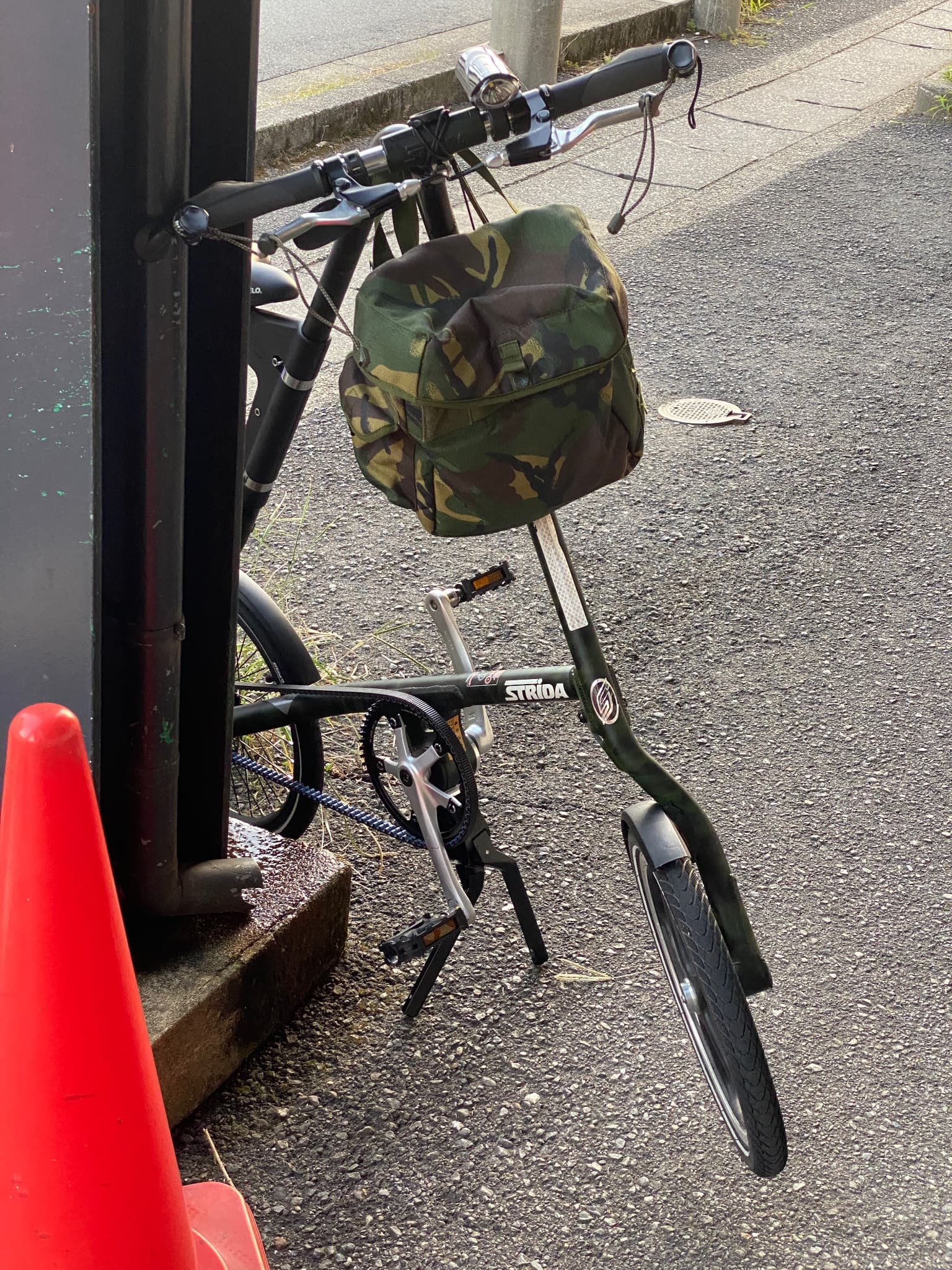

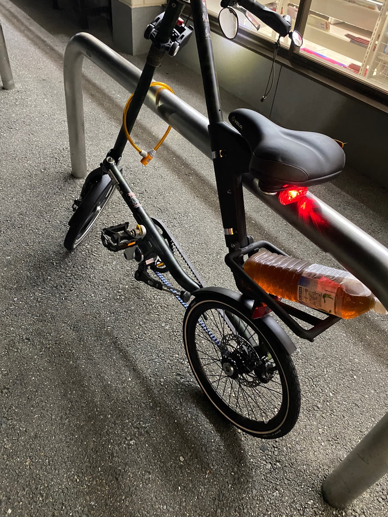

I loosened the belt tension and was able to stand on its own with the handlebars turned to the left at maximum, so I went for a test run to see if this tension was okay… I’d probably use the CDX tension meter to check properly, but for now I’m just going by feel.:face_with_spiral_eyes:
I went for a test ride while shopping.
It seems quieter than before, but I wonder if the belt was too tight and that was causing the BB and cogs to squeal… Either way, it’s still unstable, so I’ve decided to go down a size and upgrade to a 120T belt…but my budget is a bit tight :sob:
If I park it against a pillar or something, it’s fine no matter which way the handlebars are turned!:upside_down_face:
My plan will be complete once I can change to a 120T belt, enable the stand, and incorporate the 3-speed GTRO, but if you’re using it as a single speed, I recommend a combination of a 70T belt ring, 22T free cog, and 130T belt, as this is close to the original reduction ratio.:vulcan_salute:
