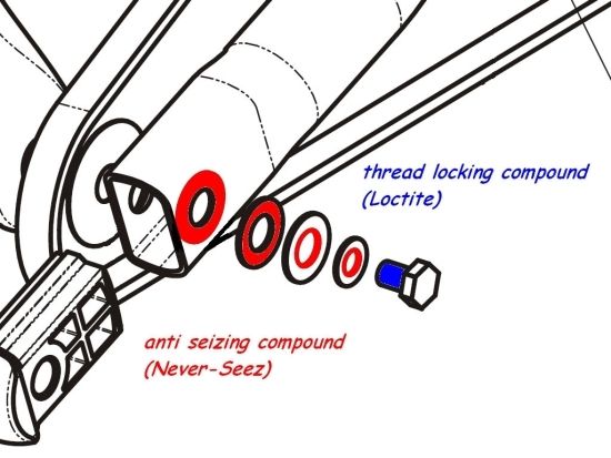

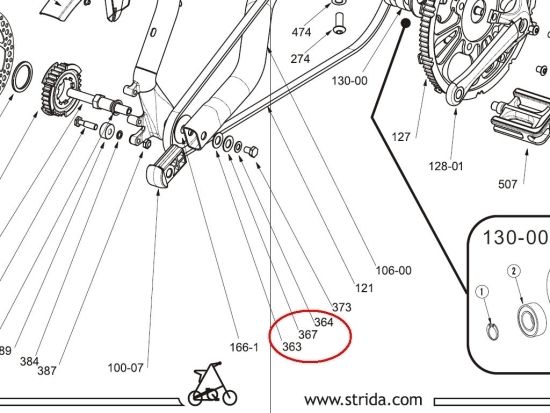

this kit is intended for the creaking/crackling noise issue which appears mostly while pedaling under high load, caused by the sharp edge of the cup spring p. nr. 367 (363 + 367 for older 5.0 Strida).
Components of the Standard version:
- 363-x washer ~ 12 x 25 mm Ø, laser cut 1.4310 stainless spring steel of 0,2 mm thickness (as a
replacement for the previous used part. nr. 363) - 367-x modified Strida cup spring, edge rounded + polished (replacement for p.nr. 367-3)
- 364-x washer M8, stainless steel (replacing low-q. original washer nr. 364)

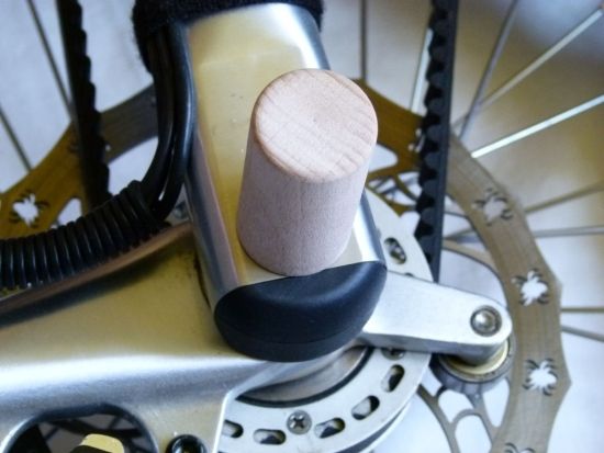

- grinding tool, grain K 180 sandpaper on beech wood, 26 mm Ø (frame burr removal)
- glass ampulla, content ~ 1 ml “Never-Seez” (anti seizing compound, lubricant)
- drawings, data sheet NS, toothpicks

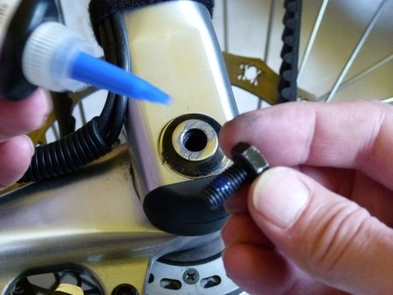

added ST-373 rear axle bolt for those who damaged it or don’t have Loctite thread lock

If you’re using a liquid thread locking compound like Loctite or similar (and not an original new bolt 373) it is implicitly necessary to wait a while – don’t move the rear joint for at least one hour.

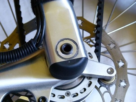

01 – 03: Remove bolt 373, washer 364 and cup spring(s) 367 (363)

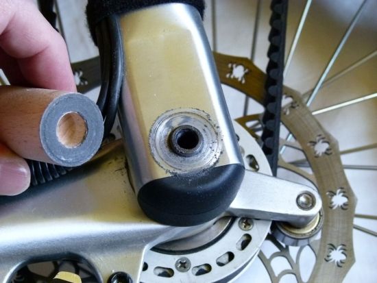

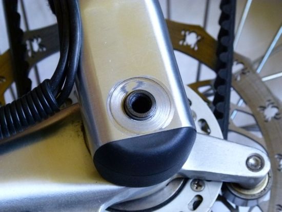

05: Use the grinding tool to remove the burrs in the frame tube
06: Remove just the protruding burr, it’s not required to grind more

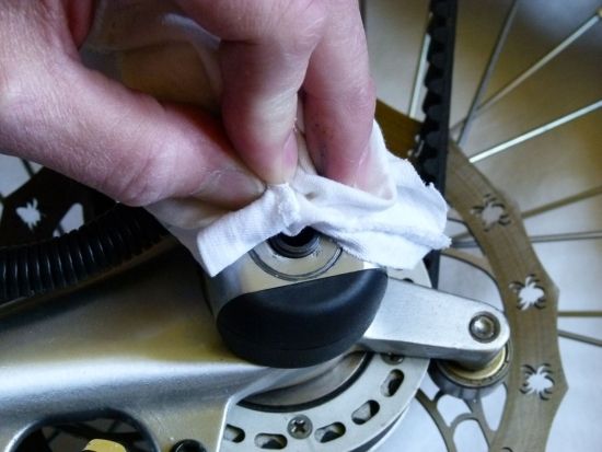

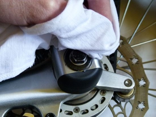

07: Clean again, a drop of oil should be helpful to pick up the grind dust first,
08: and then remove the rest with alcohol

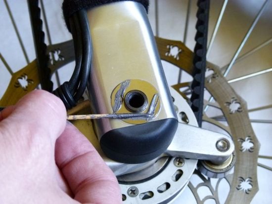

09 - 10: Apply a small amount of Never-Seez on the frame tube
11: Put the thin stainless washer 363-x in place
12 - 13: Apply again Never-Seez

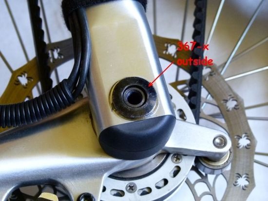

14: Next the cup spring 367-x (black side out, polished side towards tube)
15 – 16: A little bit of Never-Seez on the upper edge of the cup spring and
17: another bit NS on the outside of the washer 364-x

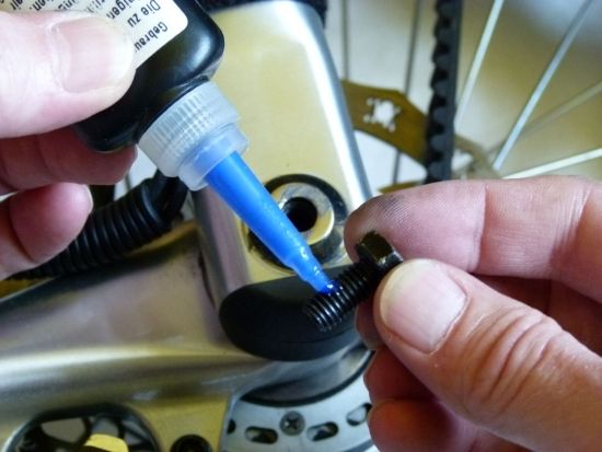

18 – 19: Don’t forget to use either a new bolt or thread locking compound (like Loctite)

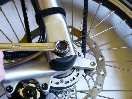

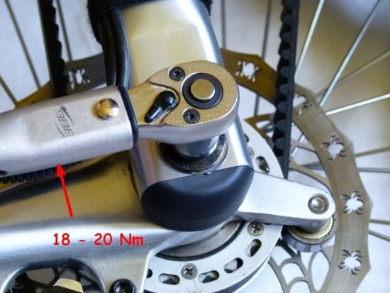

20 – 21: Tighten bolt 373 to 18 – 20 Nm
22: Remove carefully the waste Never-Seez
23 - 24: part drawings
