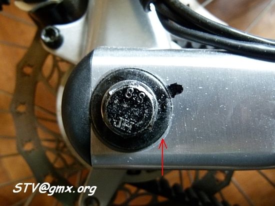

And most of all - the kit is named “crackling noise repair kit” - and definitely not “worn out bottom tube repair kit”.
The purpose of the kit is not to “increase the surface area” - it is a proposal to eliminate seizing (or galling) between the frame, the cup spring 363 (367, 367-3) and the washer 364 above, and again; the crucial part of the kit is the anti-seizing compound Never-Seez Nickel special.
http://www.neverseezproducts.com/purenickel.htm
Using this kit for a wobbly wheel doesn’t make any sense - it was developed only to repair the creaking/crackling noise issue!

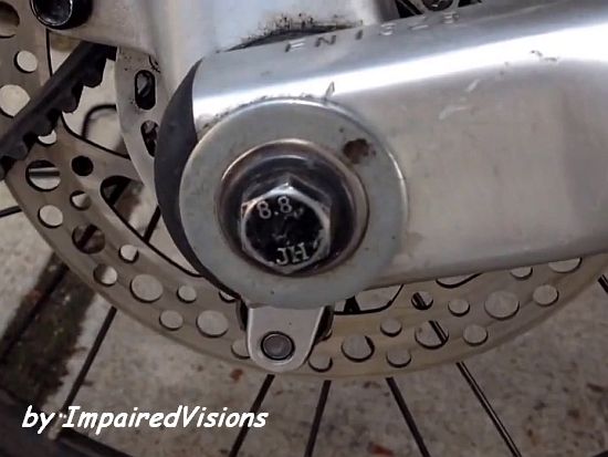

At your video “A bit more bad luck”, when you’re showing the wobbly rear wheel, it’s very easy to notice that even the belt tension varies dramatically by moving the wheel. This belt behaviour is telling us without any doubt that the distance between the rear axle and the bottom bracket axle is floating - and the only plausible reason for that again is a (dramatically) worn out hole of the bottom tube!
Tube and insert 100-07 had to be replaced…
In fact, due to the using of some thicker washers, your dealer just squeezed the bottom and the seat tube together - the joint is now stiff (it seems) but under higher load (=while riding) it is still moveable (and still leads to belt twisting).
I think it’s easy to explain the malfunction of part 338 under above mentioned angle of sight:
You will surely agree that a force which can cause a warped disc must have been high.
The force’s direction was more or less parallel to the rear axle.
One could say also that the belt moved the whole wheel to the left side (or say it tried to push the wheel off the axle).
If you imagine part 338 now as a tube (fixed by the wheel bolt) with a washer attached in the middle (the cut-off flange), I don’t wonder that the flange was simply punched outside - next to it (seen from inside) is the much harder inner bearing ring!
:neutral_face:
