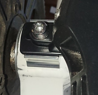

I updated that bike with kickstand - it hadn’t kickstand from new. So belt tension is fine - because there is no space for more tension anyway - the bottom weld touch the metal part from kickstand.

The silvery part below the black kickstand plate can be rotated for 180° - as it is asymmetric you can achieve several mm more space to tighten the belt - if necessary.
(Moreover that, there is still the opportunity to inverse the adjustment direction, if above does not solve the problem: How much play in Strida 5 belt? )

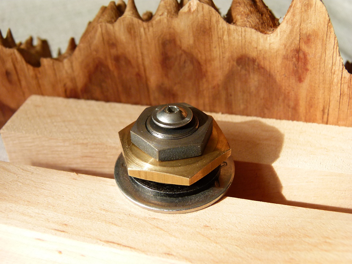

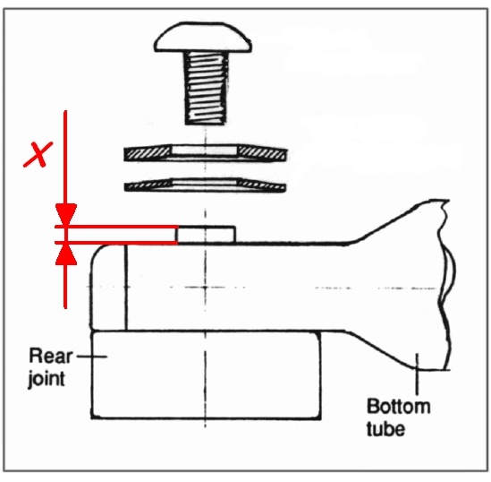

Few days ago I got a second hand Strida. I’m impressed by the quality of the design. It makes noise from the rear hinge. I can see from the side that the cup spring is eating the frame. I will soon unscrew this part to see the damage. If too much damage I would like to know if this tube of the frame is available. My Strida is the first version with the connection to the bottom bracket made of aluminium with v shape. Thanks a lot for your answers.

I do not think that single tubes are available, but feel free to ask directly at Strida.nl.
But I also believe that an exchange of the bottom tube is not necessary in most cases, it should be possible to repair it, in worst case by exchanging the plastic insert 100-07 and installation of an „armour“ shim like shown below:

I don’t have vernier calliper but I will disassemble the part (and also take a look at the tension of the belt that I think is to tight) during the weekend and try to find one to let you know. Thank you for your help !

A first thought: i consider it unlikely, that You will need a new tube. Most likely, You‘ll be able to repair eventual damage of the bottom tube.

Chris do I understand that you think that the down frame tube should be replaced ?! Don’t you think that because of his long v shape the black washer can’t damage « a lot of tube ». I will probably understand how it works when I will be able to disassemble the part (I don’t have a torque wrench). Thanks a lot for your help !
