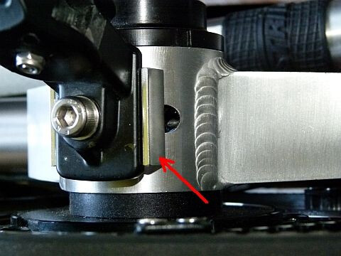

Loosen the nut screw that should fix the bottom bracket in position and loosen the bolt of Your kick stand.
With a kick stand mounted, like You have it, my experiene is that the forces You can apply to Your kick stand are good enough to tighten the belt with the aluminum bottom bracket. It’s more difficult with the old plastic bottom bracket.

You have found Your belt tension so You hold it while You tighten the nut screw (part No. 130-05) arresting the bottom bracket. Tighten the screw that holds the kick stand and You are ready to go.

The bottom bracket is in fact an excenter.
Tightening/loosening (adjusting) works by rotating the excenter clockwise/counterclockwise.
To rotate the excenter, please remove the bolt 474 (kickstand bolt) with an Allen key (8 mm) AND loosen the big groove nut at the left side of the excenter with a hook key (Ø 60 mm).
Note that both elements (bolt AND groove nut) have to be tight after adjusting.
