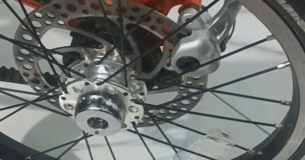

I have a strida mk5. Today while driving, I pushed it little hard for speed. It also doesn’t help that I am right on the cusp of with limit (210 lbs) and now it’s making this sound from the rear side. I can’t really pinpoint where the sound is coming from. Can anybody help/ encounter similar issue?
Note: The sound only comes when I am riding it, I think my weight on the bicycle have something to do with it. When I try to pick the bike and rotate the tire, the sound doesn’t come. I even stopped peddling and the sound was still coming, so I am ruling out the pedals too

I’m pretty sure that your rear wheel is going to die.
I bet there are several spokes loose, perhaps broken already.
Please do not ride that wheel any longer, it may collaps soon.
Am I right?
I am not really sure. What’s the solution for this? And how can I make absolutely sure that that’s the case. I mean how can I check if my wheel is dying? @Blackstridaaustria
I haven’t seen any spoke being broken, how can I check if they are loose?
Knock on each single spoke (with grip of screw driver, piece of wood etc.).
Do you hear a tone or a dull noise?
Tone - under tension.
No tone - no tension on the spoke.
You should be able to feel that, too…
You could also compare the spoke tension to that of the front wheel…
These wheels can be built sloppy.
They are not made for that much lbs.
Amuro Lee, honoured forum member, had similar lbs - he destroyed several wheels.

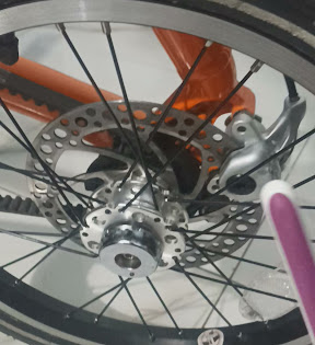

Let me try it with a toothbrush handle and post a video real quick.
Take your time please. :nerd_face:
Here you go
Please let me know if I’m missing something
Couldn’t feel much by squeezing, the front tire and the rear tire kind of feels the same and squeezing.
I don’t know much about bicycles, let alone spokes.. I leave it at your wisdom, what do you think by hearing the sound?
