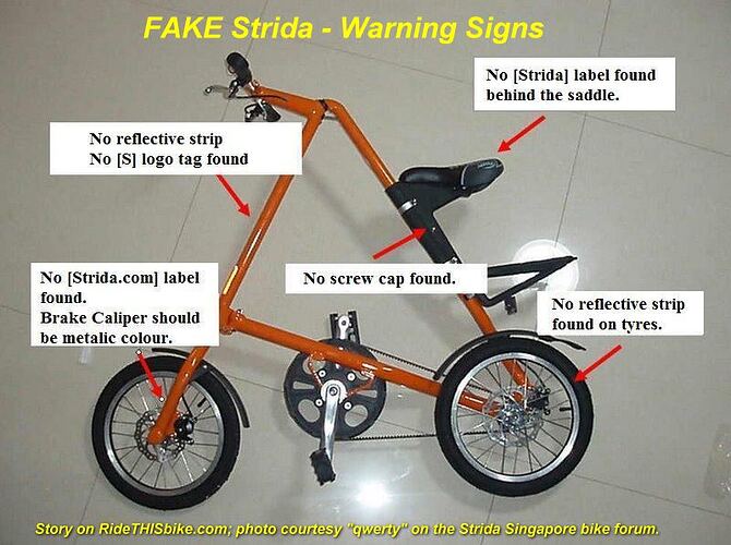

Usually the quality is awfully bad, here an example of an Austrian SLO:
Please notice the waves at the curve of the frame - I wonder that anybody wants to ride on such thing. ![]()

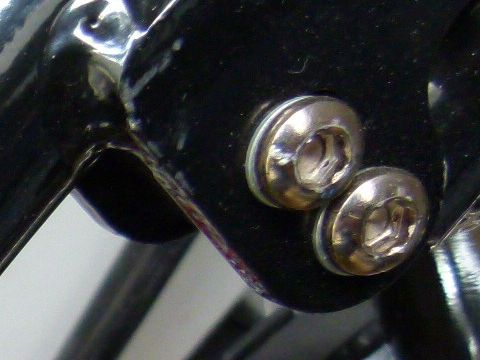

Can someone post pics of the obvious differences. I read in a post that the fake ones have 4 screws on the steering pin and the real Strida has 2. Can someone post a pic of this as I can’t find one.

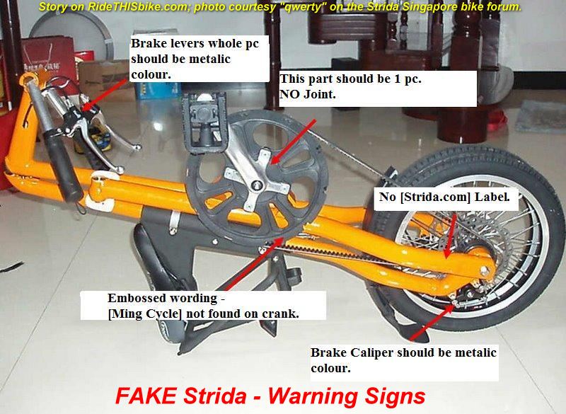

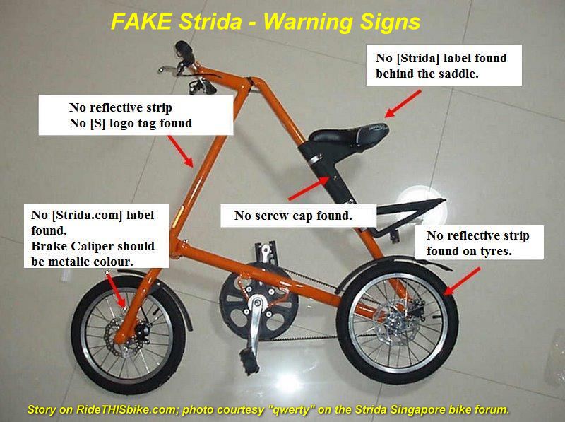

Thanks for posting the pics about fake Strida Warning signs, I couldn’t find it anymore.
Guess you’ve overlooked the above pic?
Ok, here is a different cut of the Austrian SLO pic:
In this post
How does the bottom bar latch work?
the link for the bottom bar latch patent can be found
http://www.freepatentsonline.com/7681900.pdf
It is showing definitely holes for TWO bolts, not four.

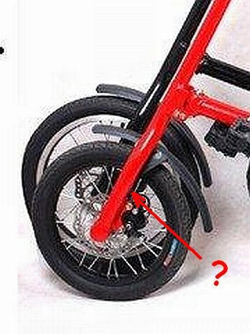

Why, do you think, is there just one (crappy) pic at the DHgate seller’s site?
Might it be that he wanted to hide the FOUR bolts?
(The resolution is also too low to see the brake calipers.)

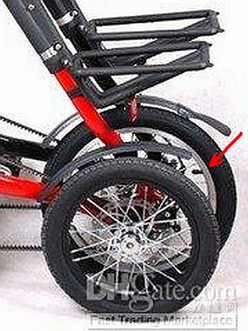

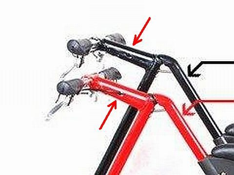

But there ARE some strange details visible:
Here it looks like the brake cable holes are sidewise of the stem, normally they are at the bottom side!
The valve should point straight to the axle, maybe the tube is mounted not correct?
Why does the stem not look like that of a real Strida?
(The real stem is more conical than the fake.)

Why are there no Strida.com adhesive stickers on the frame?
Why are the reflective stripes of the tyres disappeared?
