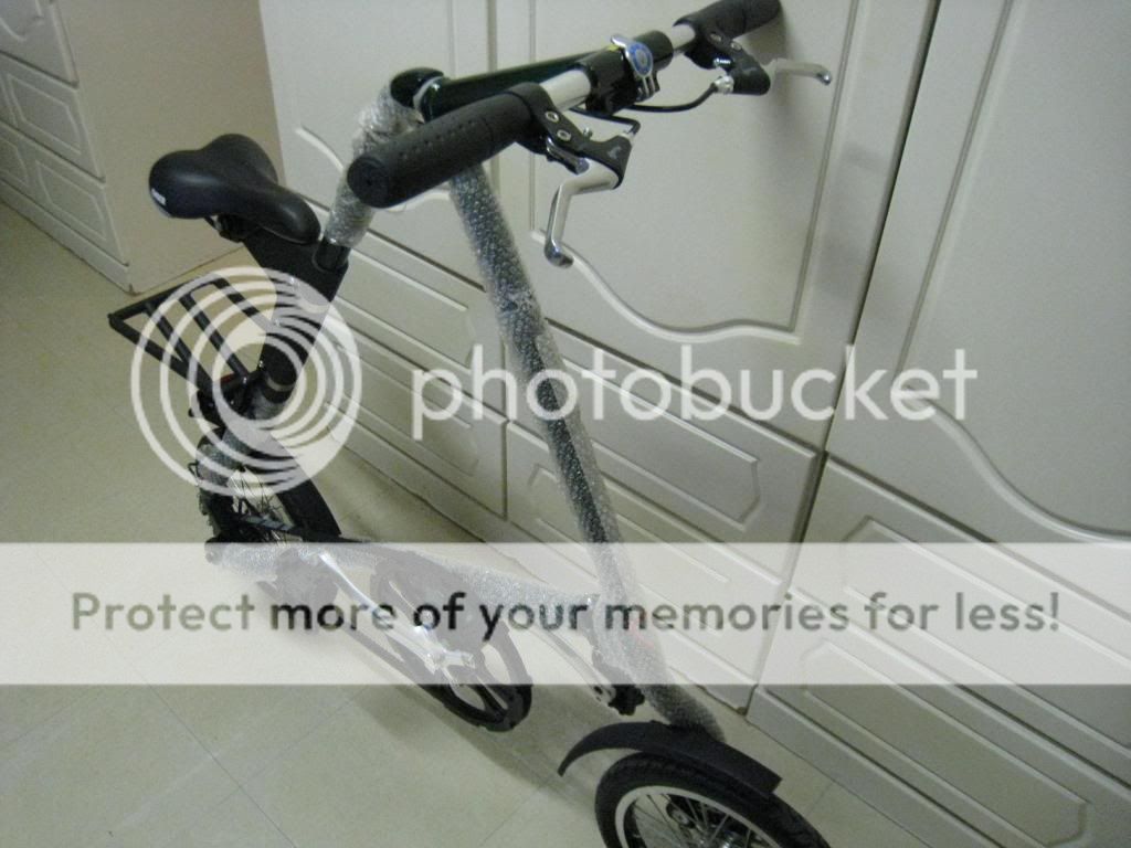

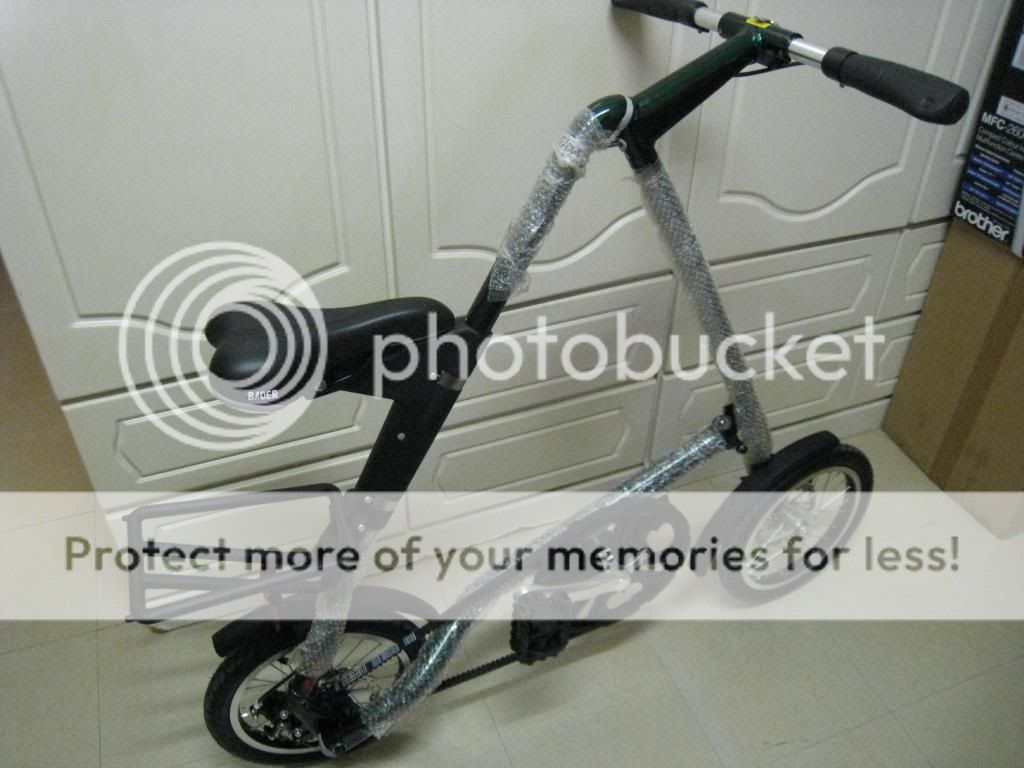

It looks like the Crank axle is mounted in plastic - softer but lighter than the original aluminium part.
There is something weird about the joint between the lower tube (downtube ?) and the back of the bike … no end cap - then tube just seems to be rounded off ? and the washer between parts looks like its in 2 parts ??
The brakes are different too.
It certainly looks like a Strida … an SLO
Strida Like Object
Good luck with it - take it easy as well ! … good to have one more bike in the world, but bad to have one less person ![]()

The bike weighs exactly 11 Kg’s. My old Strida 3 is a little bit lighter, but guess most of the diff is in
wheels and plastic BB.

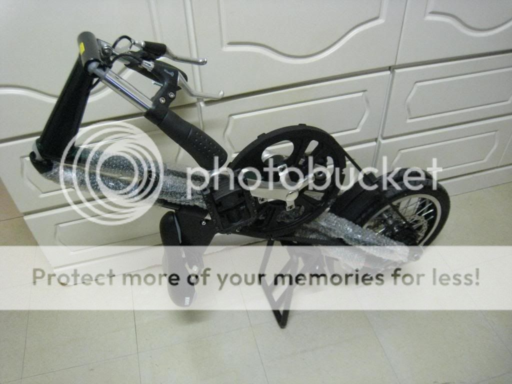

The chain ring looks the same sort of design as my old strida 3. I don’t understand the reason for the cut out notches around the main big ring (there are 10 of them in total). the rear smaller sprocket looks to be a one piece machined item rather than the glued arrangement on my 3.
I presume by the down tube you mean the one that has the BB bracket welded to it. Yes the tube does seem rounded off. There is no end cap as such - but it looks as though a “patch” has been welded over the end of the tube to create a (not as pretty) alternative.

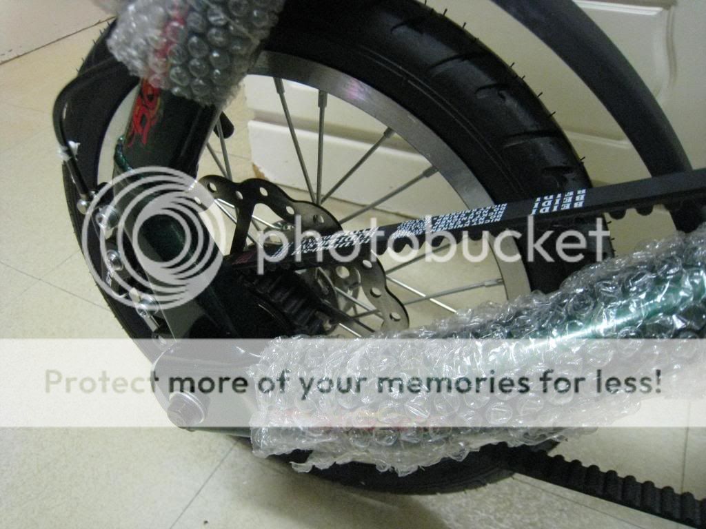

The washer between this tube and the Rear up (?) tube is a one piece washer. The picture looks like it does as this is grease that has been used in final assembly.

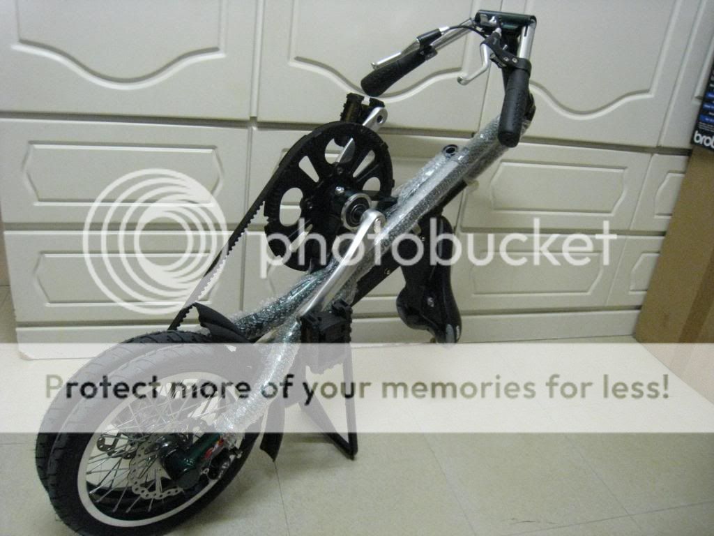

Sorry forgot to mention - the belt is toothed… these bikes definitely need this a smooth belt would just slip at the maximum available belt tension.
