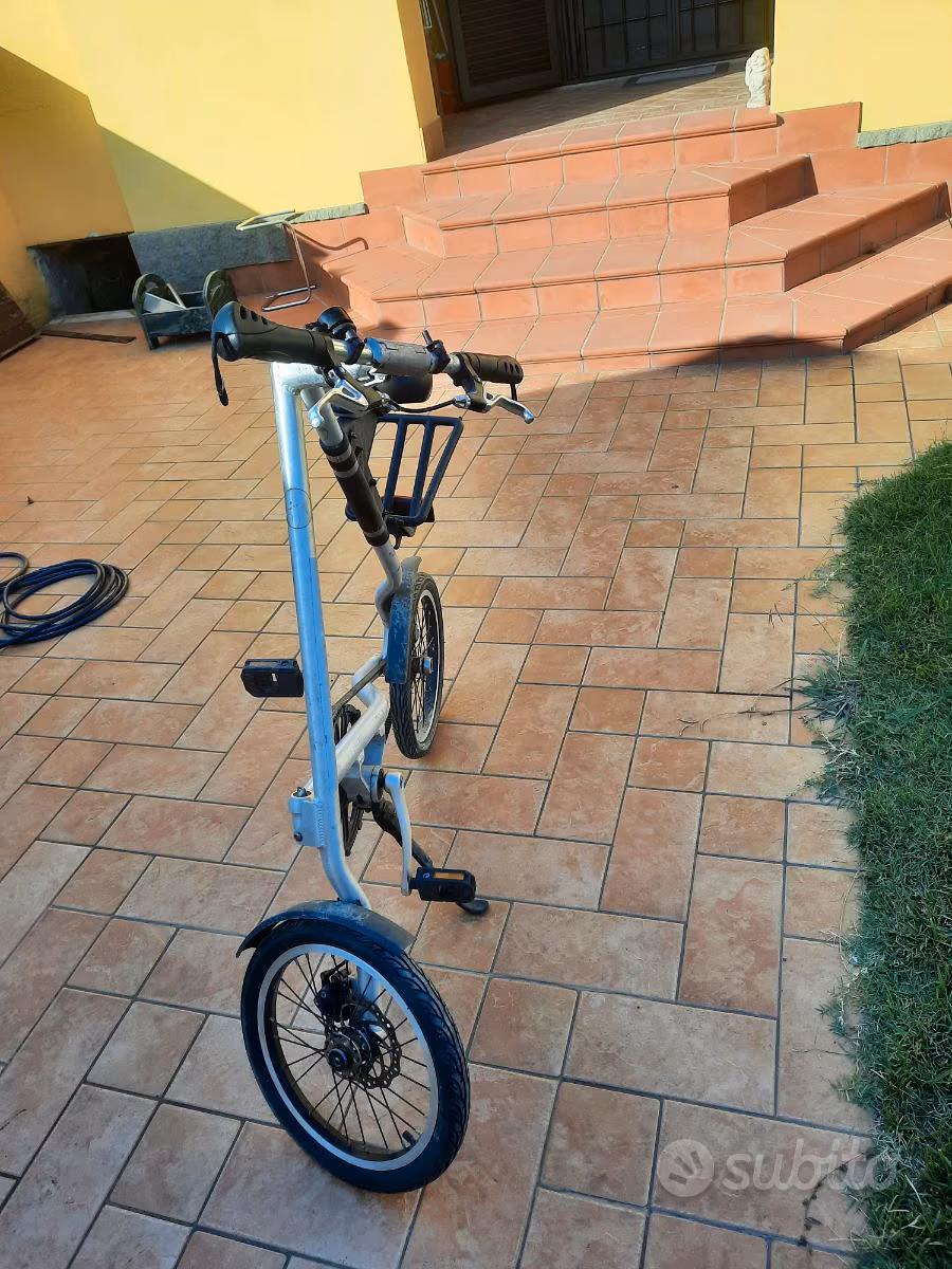

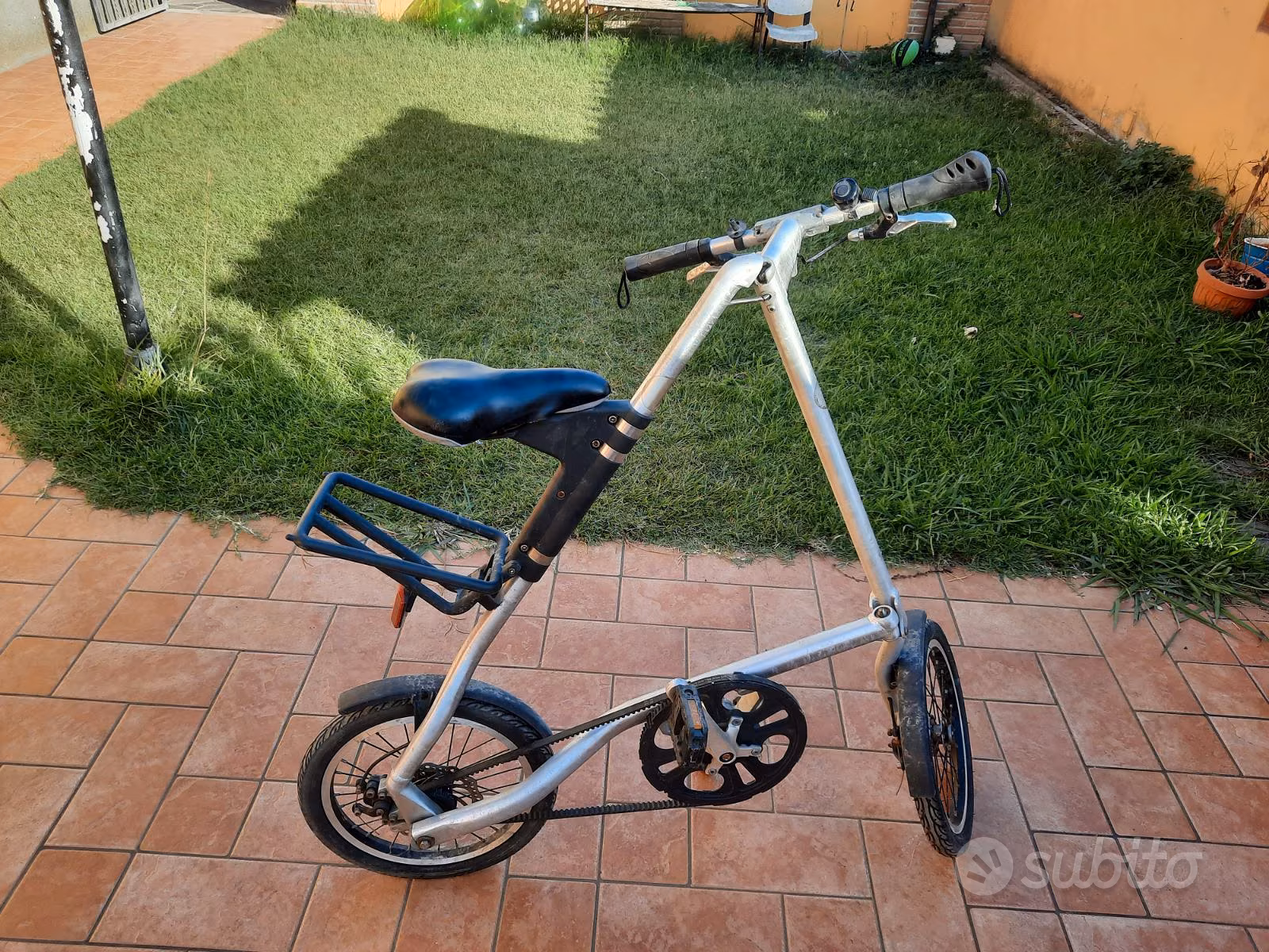

unfortunately i could only find them in red or brown plastic, but as i would like them in metal with spokes i was thinking of using the ones from this strida that you can see in the photos. do you think they are compatible and can be mounted on my strida evo instead of the 18 inch ones without any problems?

Hello Antonello,
Principially, you can interchange the wheels between all original Strida versions (except the Strida Mini) without any problem.
Just, I’m afraid that the bike you’re showing is in fact a so-called SLO (Strida Like Object), the same version than that of @Amir_Yarrow.
You can find out if it is genuine easily; try first to change the front wheels. If things don’t match together it is certainly a fake one.
Compare all details with those of your EVO, I bet you find many differencies.
I look first at the rotors, calipers, bolt heads, shape of cranks, clamps at the seat molding etc.
Is there a number stamped at the underside of the bottom tube, close to the rear hinge?
What exactly says the writing on the belt?
Could you add images with close-ups of the left crank area (bottom bracket), the bolt which is securing the pan for the ball-joint, caliper and locking mechanism?
Did you already remove (or adjust) the seat molding?

Hi Chris,
thank you for your reply.
it is a bike for sale on a classifieds site so before buying it I requested more information from the seller including the frame number.
I will update you as soon as I have any news.

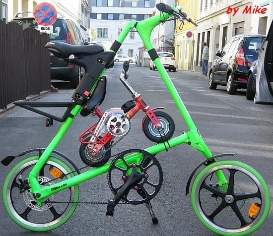

Tannus in 16" version do fit the Strida plastic rims, we tried that long ago at this bike:
grafik
I have still an unused wheel set of this type (with dark violet tyres) here, if you’re interested please pm me.
