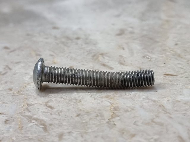

I’m led to believe that the asymmetric bottom bracket should now be somewhat loose (for adjusting the belt tension). It is not. In fact, I put a long M8 screw in the bottom bracket and applied a cheater bar, and this effort bent the screw. The bottom bracket did not rotate at all.

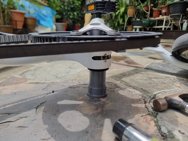

I also tried propping up the BB on a little pvc pipe (to avoid putting pressure on the crank) and hit the bottom tube bracket assembly with a rubber mallet:
Did not budge at all either.

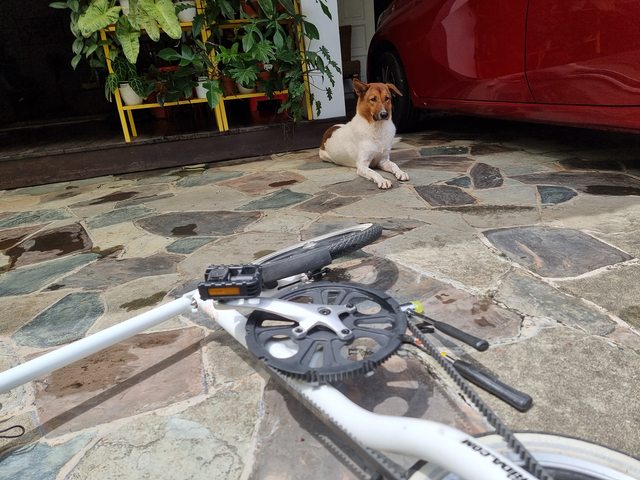

Bonus dog pic:
Ok, first many thanks for the bonus pic, your friend looks really sweet

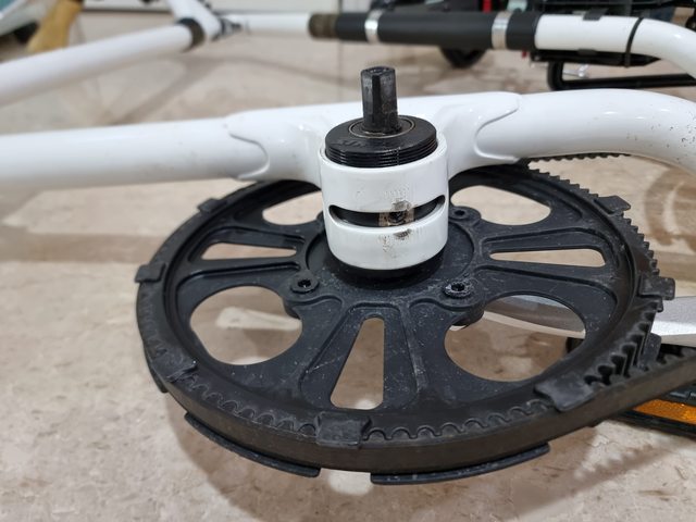

Could you please send the image below - in full size - to my email account?
Link to full size: i.imgur.com/NJyZPY7.jpg

I mean the bottom bracket looks really good, no sign of slipping at all.
Could it be that the previous owner glued the excenter into the bottom bracket housing?
At the left (forward) part of the black excenter, one can see a shiny line, close to the lower edge of the housing’s slot.
That could be glue - or is it grease (or WD40 remains)?
I guess the belt is under high tension.
You could derail it with a screwdriver, too - but there is a big risk that you destroy the belt this way.

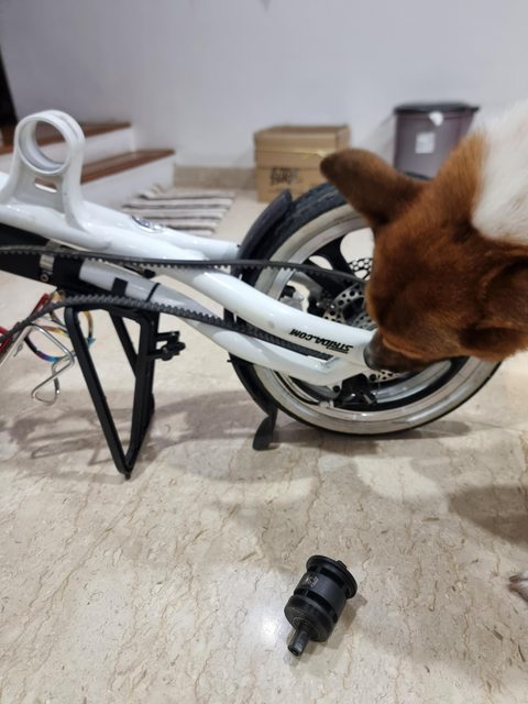

The answer was to remove the right crank and beltring (without detensioning the belt - there was no way to do so anyway). This allowed for a firm grip on the assembly from the right side. Then using the PVC pipe as a pusher, the FLBS used the world’s biggest rubber mallet and the fury of a thousand suns to just hammer the BB out. Took like a dozen blows.
(if anyone’s shopping for the PVC pusher, a DN25/G1" connector works wonderfully)
Upon inspection there is nothing wrong with the bottom bracket or the shell. There is no glue residue. The replacement aluminium bottom bracket just popped right in without a pusher also, so I guess it was just arbitrary variation in the plastic casting.
