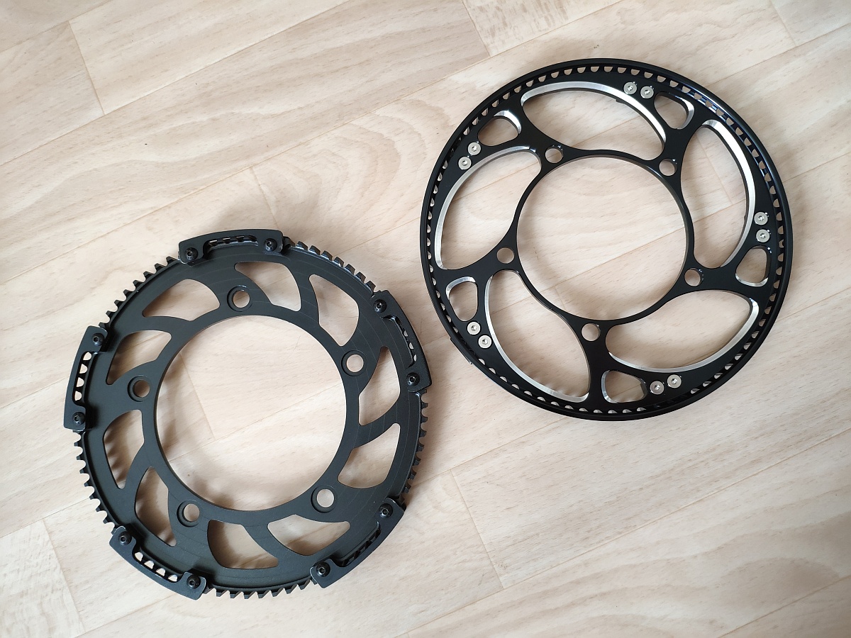

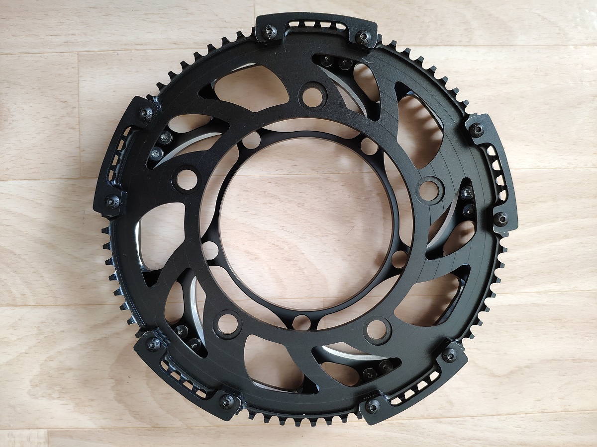

I’m not sure if standard BCD 130 would fit, anyway, here’s a quick comparison between efneo and ATS 80T beltwheels:

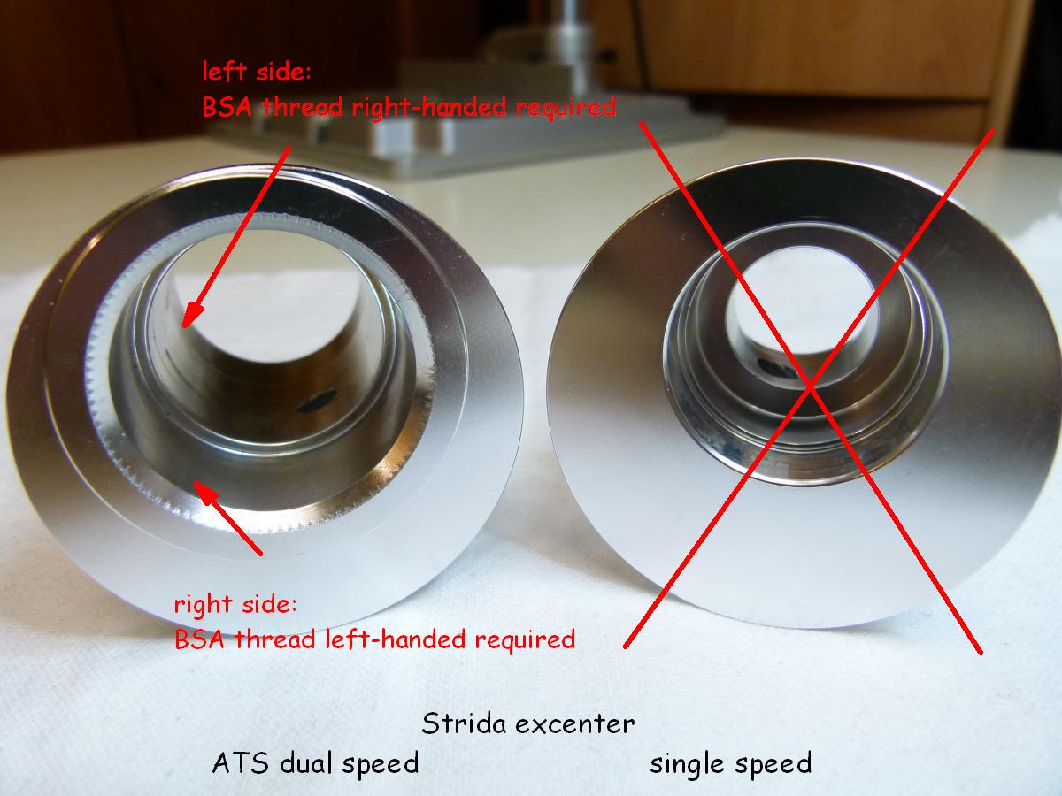

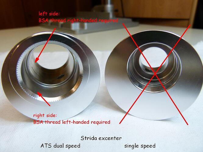

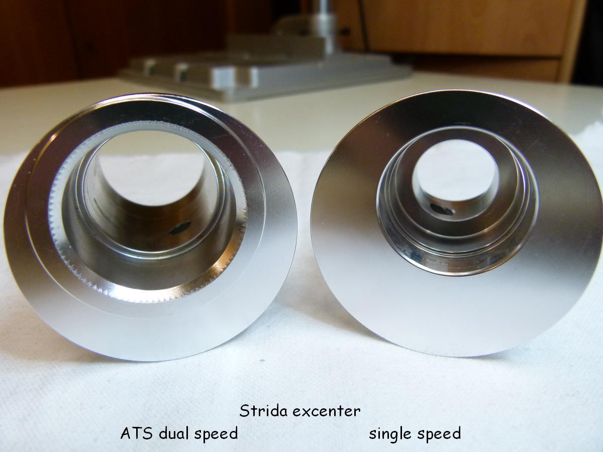

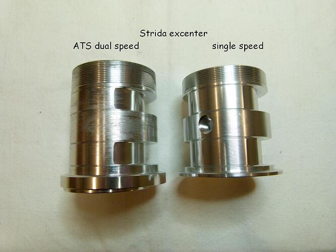

…and here you see what’s different between the Strida single speed and the ATS dual speed excenter:
:wink:
P.S.:

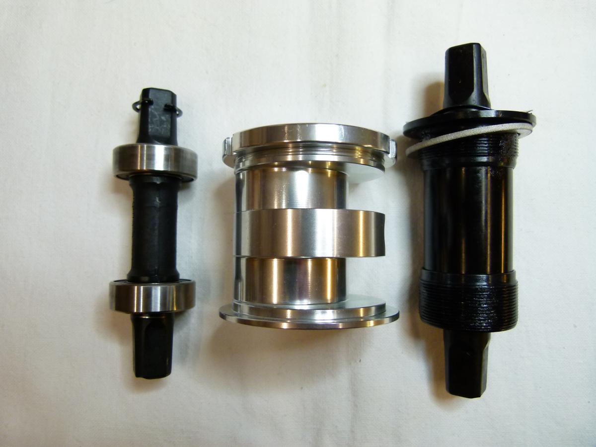

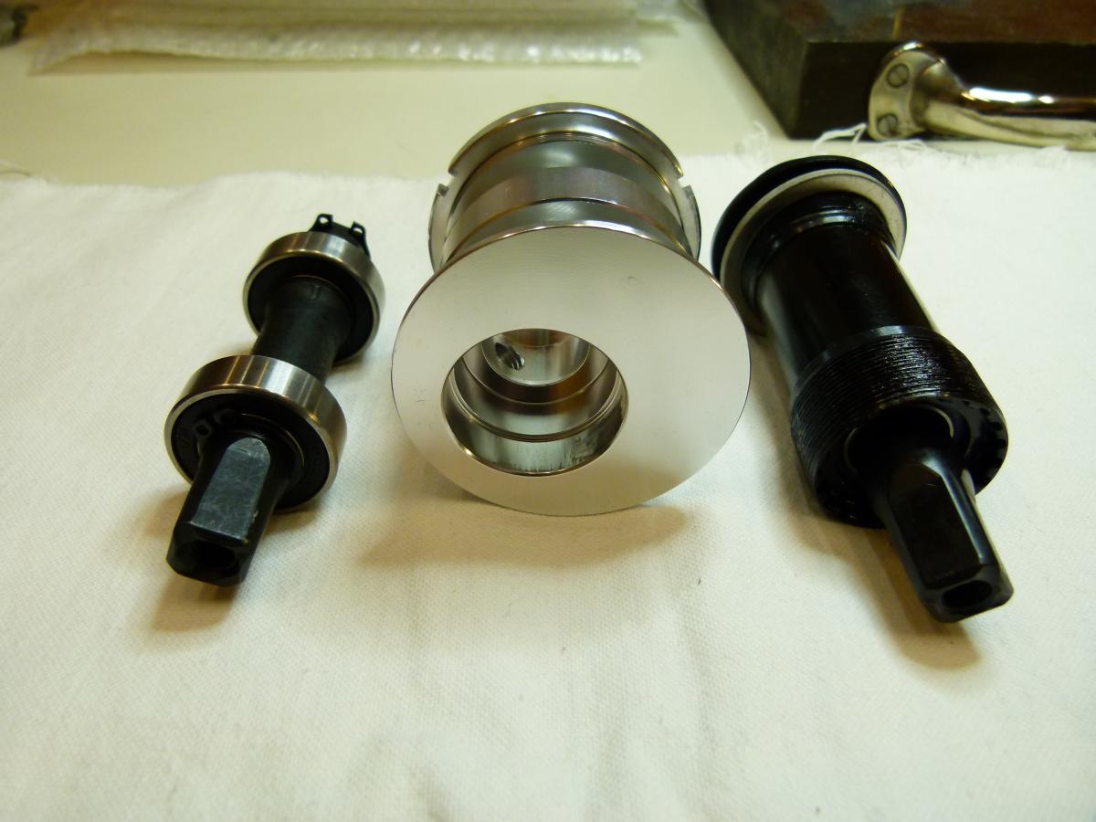

That image of the Japanese blog looks exactly like a modded ATS excenter with the bottom bracket (bearings) of an efneo drive.
Here next to a disassembled single speed excenter:
Thank you for the detailed explanation with pictures. :folded_hands:
The ATS excenter can be purchased on e-Bay (although I don’t know what kind of processing is required), and the BB seems like it should be possible to use a generic product, so that problem should be solved.(I feel like the width of the excenter is quite different, so I have some doubts about the centering of the belt.) :thinking:
If we believe the website of the supplier mentioned earlier, it seems that GTRO uses a universal BCD of 130mm to be compatible with multiple models, but it seems difficult to obtain a BCD of 130, preferably an 80T HTD belt wheel.
It may be possible to use the ATS one if it is modified, but the labor hours and precision required for strength processing are likely to be significant issues.

As shown above; there is one left and one right hand BSA thread required, nothing else.

By the way, what is the diameter of the Speeddrive or Efneo 80T belt ring?
I estimate that it has 80 teeth with an 8mm pitch, so the circumference is 640mm, and dividing that by pi gives me about 204mm.
If I do the same calculations, the Carbondrive CDX 55T is estimated to have a pitch of 11 mm, an outer circumference of 605 mm, and a diameter of approximately 193 mm, so it may just be possible to fit it into the STRiDA. :thinking:
