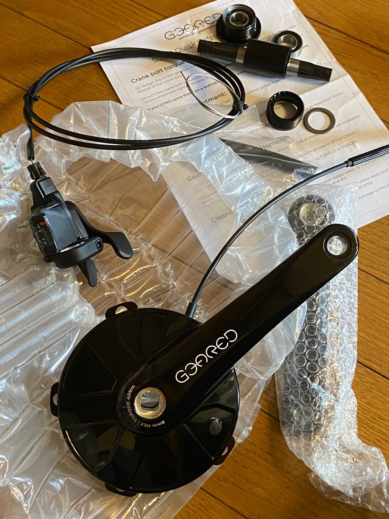

They adjusted the cable length and such, but unlike the efneo ones, they’re generic products, not STRiDA-specific, so the contents are minimal.
The GTRO main unit, rapid-fire shifter that I selected, left crank, and a non-cartridge bearing-type bottom bracket.
This BB appears to have improved the length of the square part of the right axle, the thickness of the flange, and the diameter compared to the cartridge type BB included in the previous kit.
The disc part of the main unit has changed from the simple, plain shape seen in past models to one with radial press lines, and the efneo logo has been changed to G3ARED, which seems to be the manufacturer’s current logo.
The pretensioner arm on the back of the main unit has also been changed from the previous metal type to a type with a rubber pad that is less likely to damage the frame.
nFIXED London sent me a PDF file of the instruction manual via email, so there shouldn’t be any problems with installation.

As shown in the photo above, there is a rubber plug in the disc part, and the PDF manual that was sent to me separately by email said to fill it with bottled oil using a dropper.
I’m going to ask about the oil specs, it would be fine if standard gear oil was enough…:thinking:
