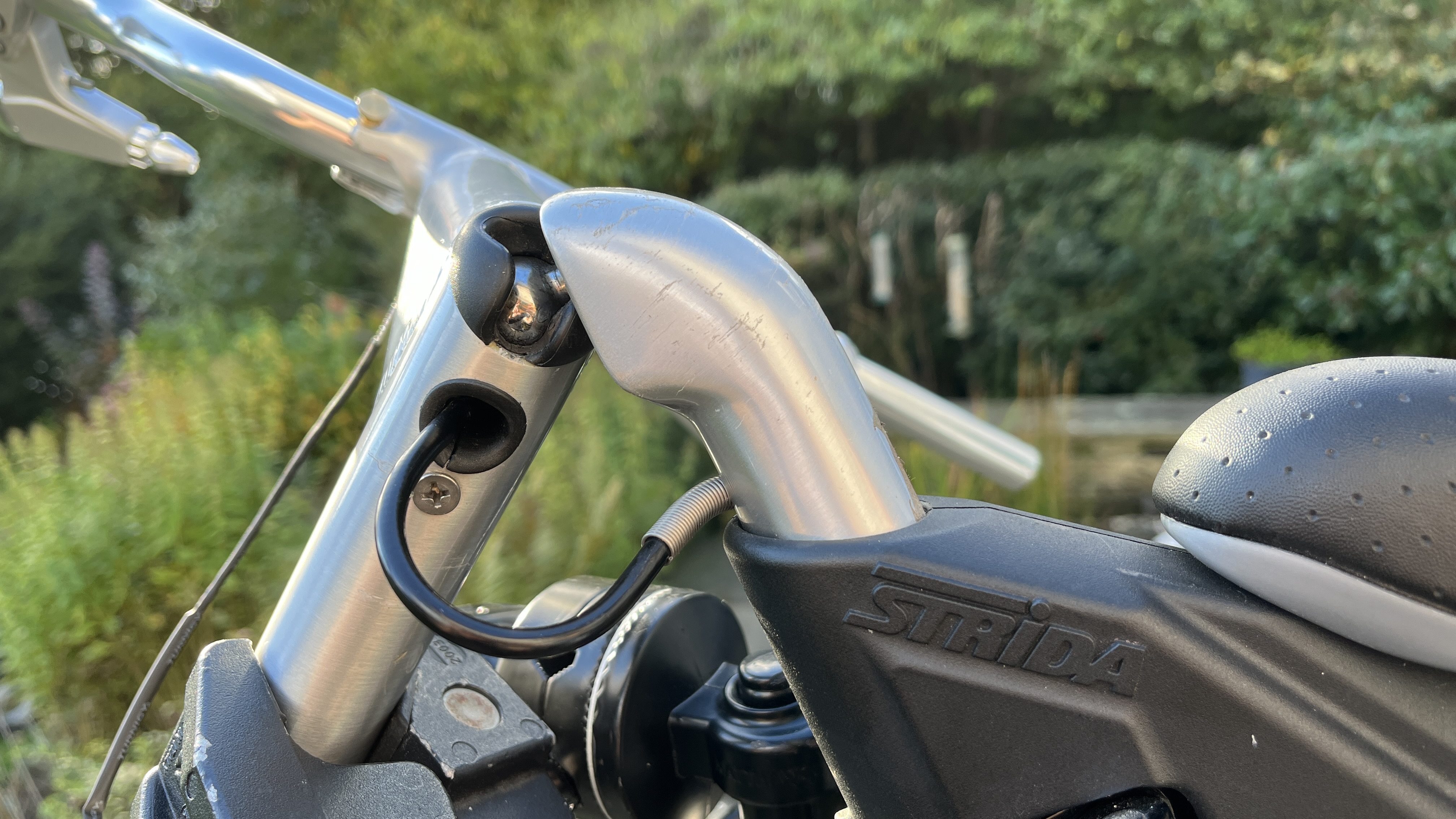

Well. I’ve just found that it’s not possible to change this on as Strida without also changing the cables for longer ones. I’ve just changed it around and now the cables cross over the handlebar clamp quite tightly so that I can’t now fold the handlebars down. Doh!
I’ll have to change it back for now, and maybe try to get longer cables another time. In the meantime I’m going to have to learn to override the cycling habits of a lifetime by braking with my right hand first. Should be interesting ;}
