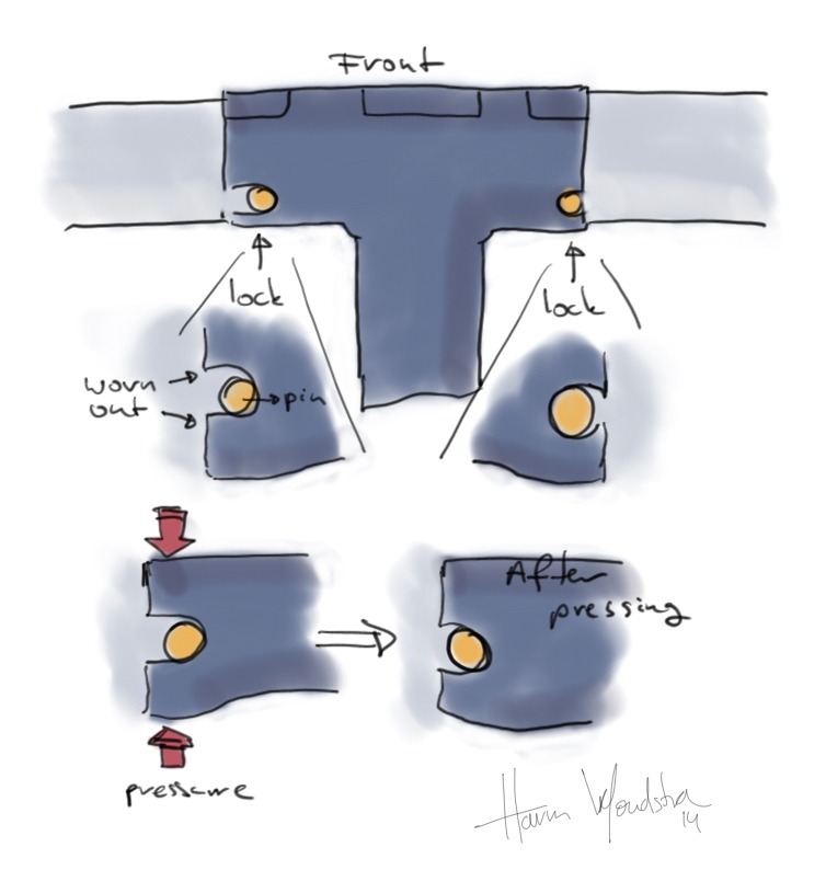

Anyway, the story in short: I bought a Strida 5.2 second hand. What I thought was a bend/worn handlebar was in fact a worn handlebar locking hole on the frame.
As you may know this is not easily replaceable. While waiting for my new front tube I took a vice and bend the frame over the locking knob.
I took a photo of the result. I didn’t take a photo prior to the fix, so I drew out the procedure.
The result is a secure lock on the brass knob. The handlebar won’t ride out when driving the bike and doesn’t wobble any more when in locked position.

One thing I should point out, bending aluminium weakens the material. There is a risk of breaking when bending. And if it breaks while driving, well, I hope you are not putting you weight on it then :slight_smile:
