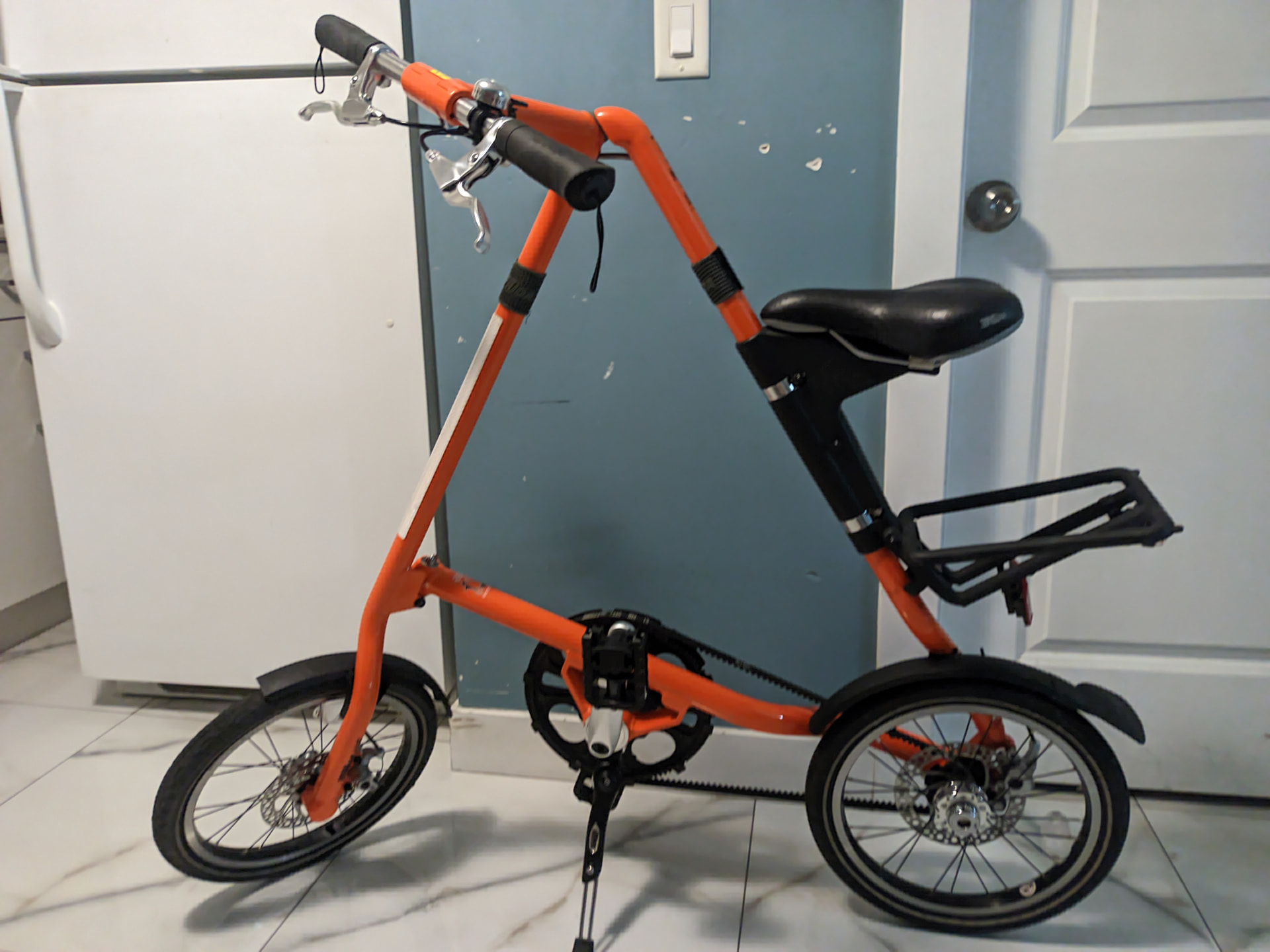

What model of strida is this?
I bought this strida from marketplace and I was wondering what model is this? Is this a genuine strida? And also, how much PSI air in front tire and rear tire? Thank you very much in advance for your help.

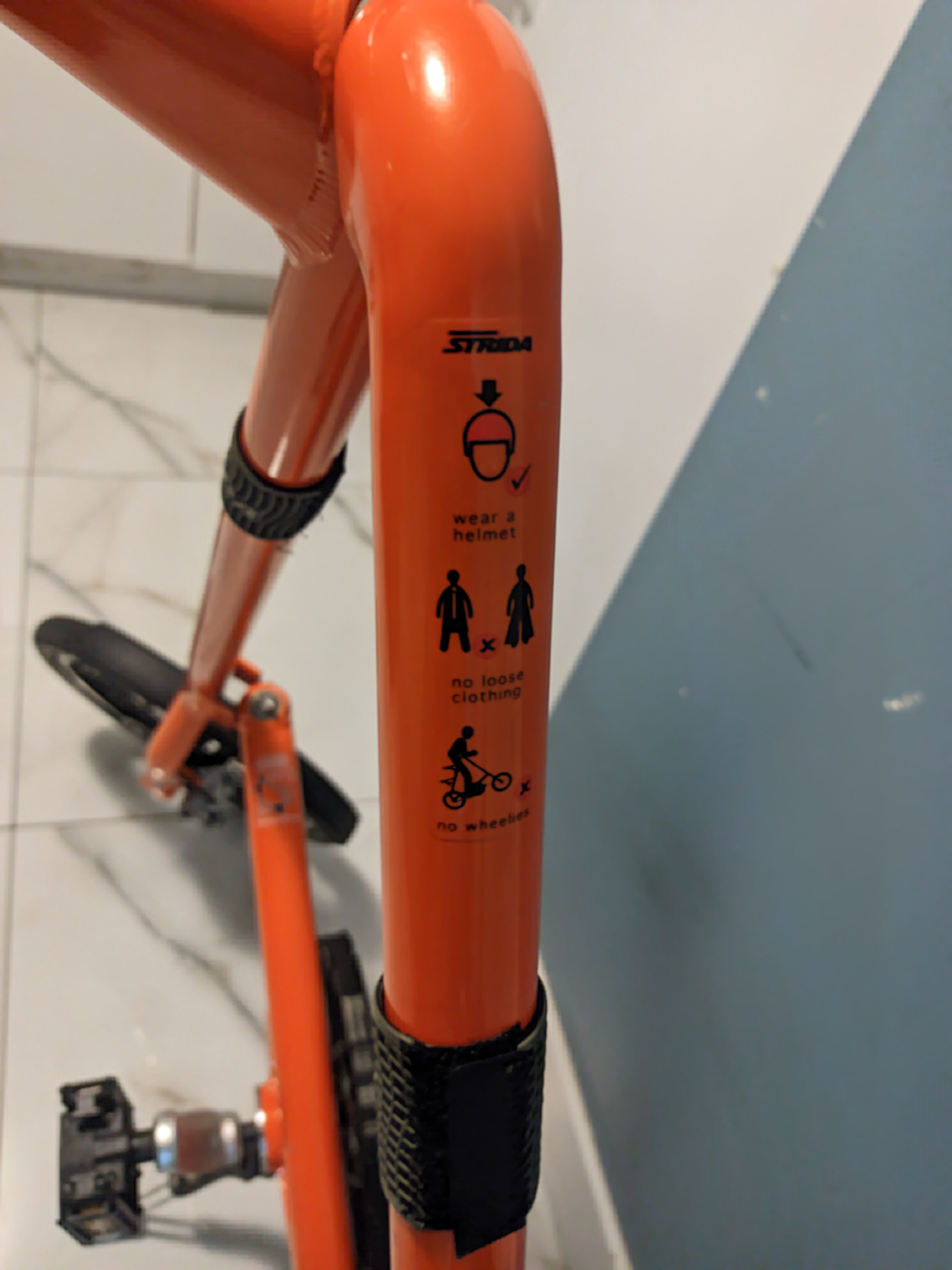

Looks like a mk 5
Same wheels as my LT with metal rims. I use 80 psi
Genuine MK5. :+1:
There is no pressure limit on metal (spoked) wheels.
While on plastic spoked wheels the limit is 85 PSI (I believe - the max pressure is printed on them).
Inspect your tire, the pressure range should be printed on it.
Within that range, you can experiment and adjust the pressure according to your personal liking.
Lower pressure - hard to pedal - soft ride.
Higher pressure - easier to pedal - hard ride.
