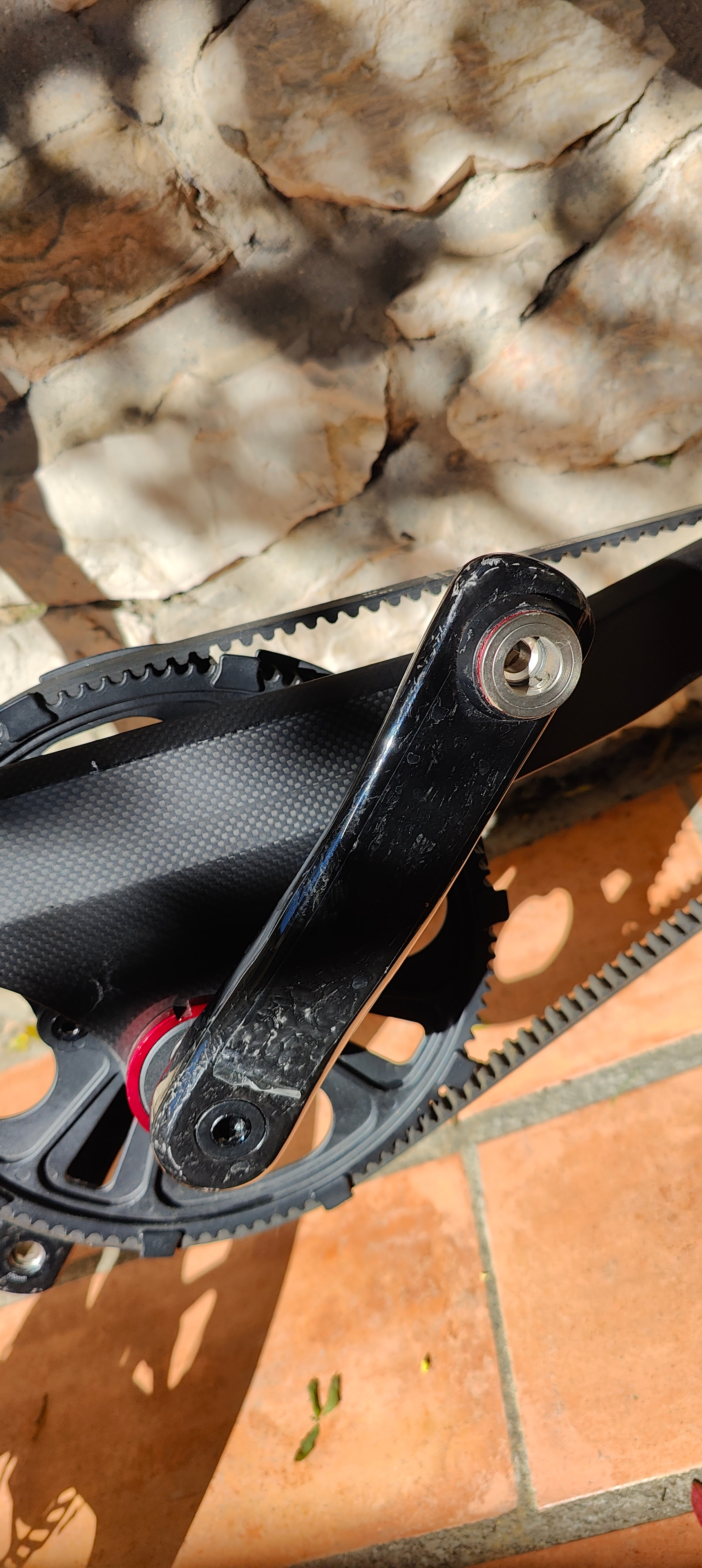

Here is a photo that may help a bit to understand. This spacer on the crank for fixing the pedal has no thread inside. Does it means that a specific pedal only is needed ? Or an intermediate item between the spacer and a standard pedal is missing ? Or something else that I don’t understand maybe ?
A workaround could be to try to remove these spacers and try to replace them by a threaded pedal extender ?
Olivier

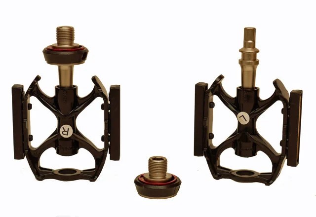

What we have here is an original Strida quick release pedal mount.
Do your pedals have an Allen key at their axles (instead of threads)? :face_with_monocle:
C.
Pardon please, forget that above.
You just take an 8 mm Allen key and remove the adapters.
Now you can mount any pedal you want. :wink:

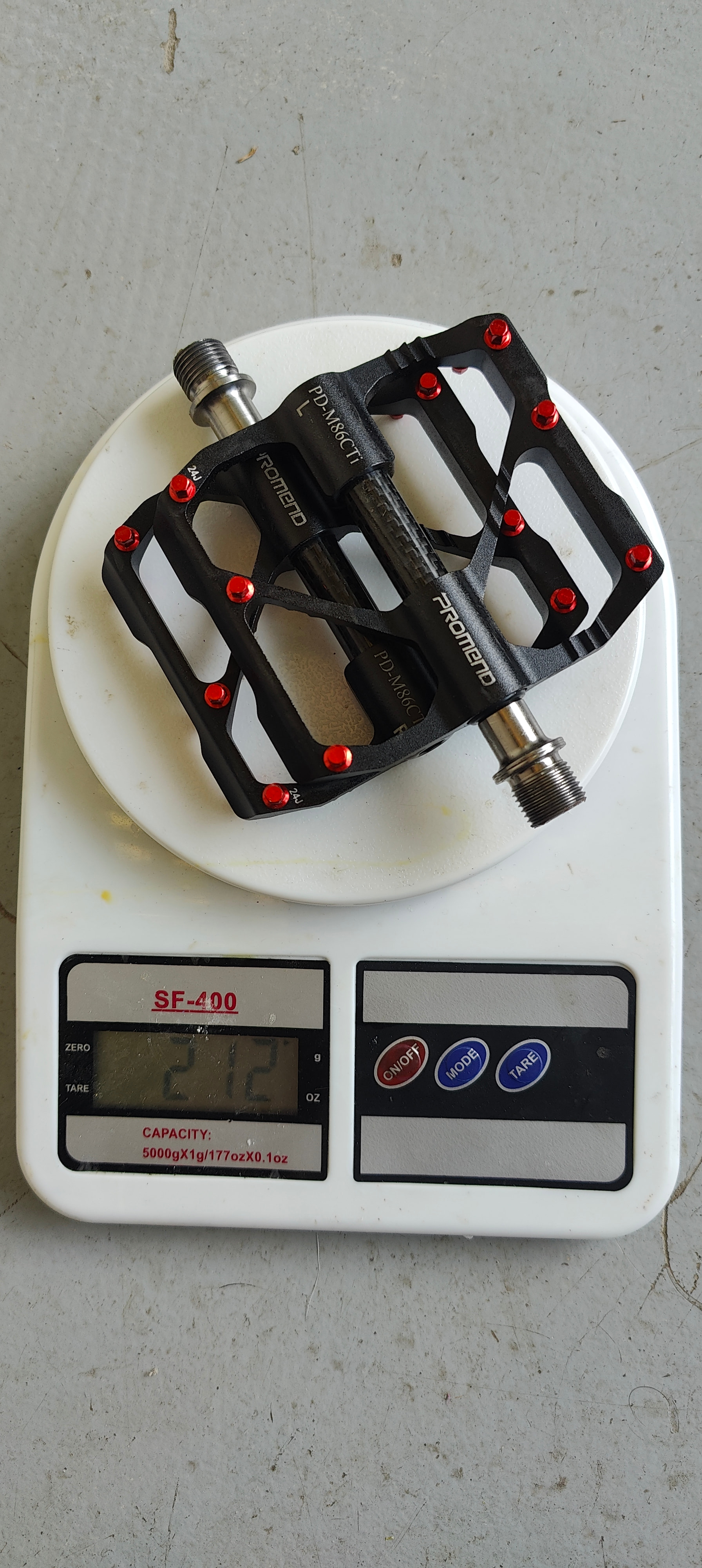

Dear Chris,
How are you ?

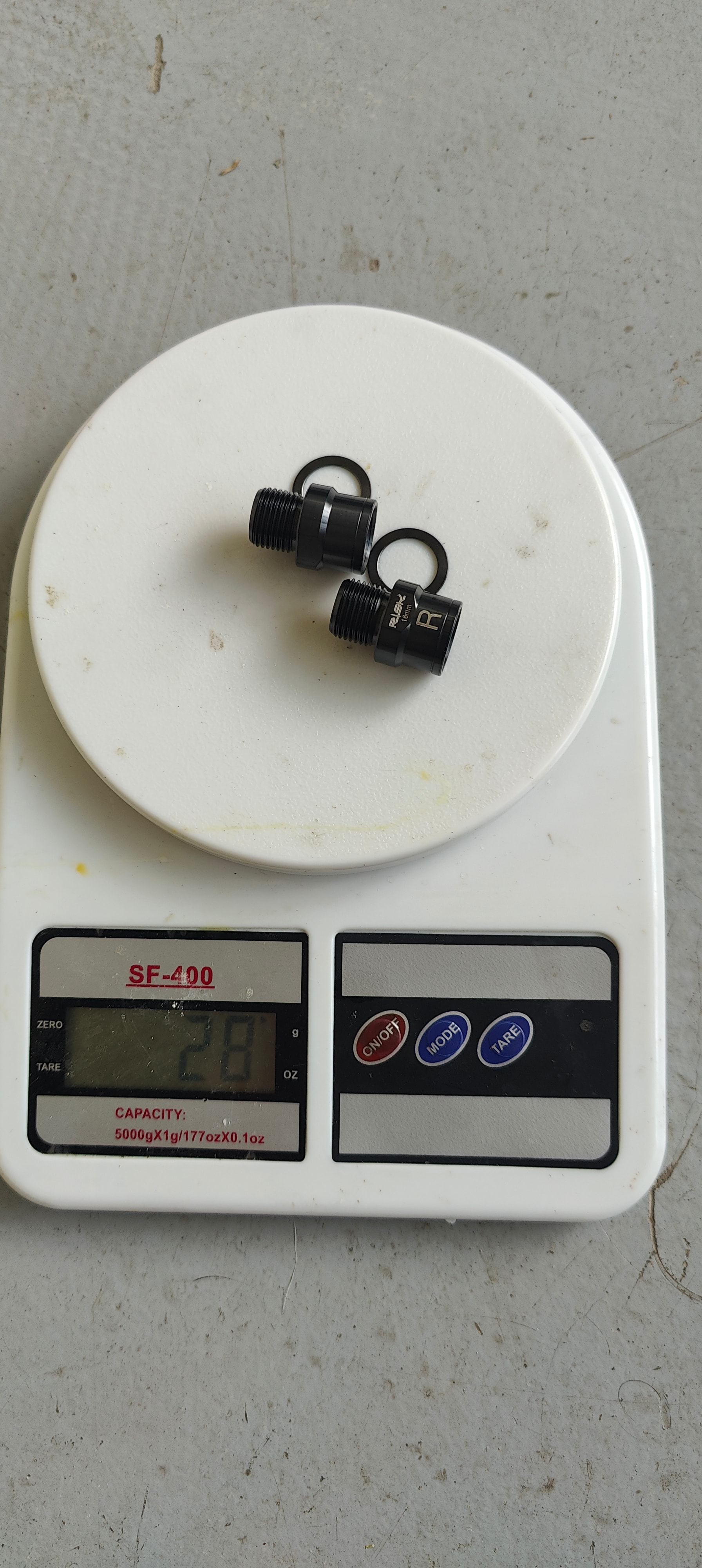

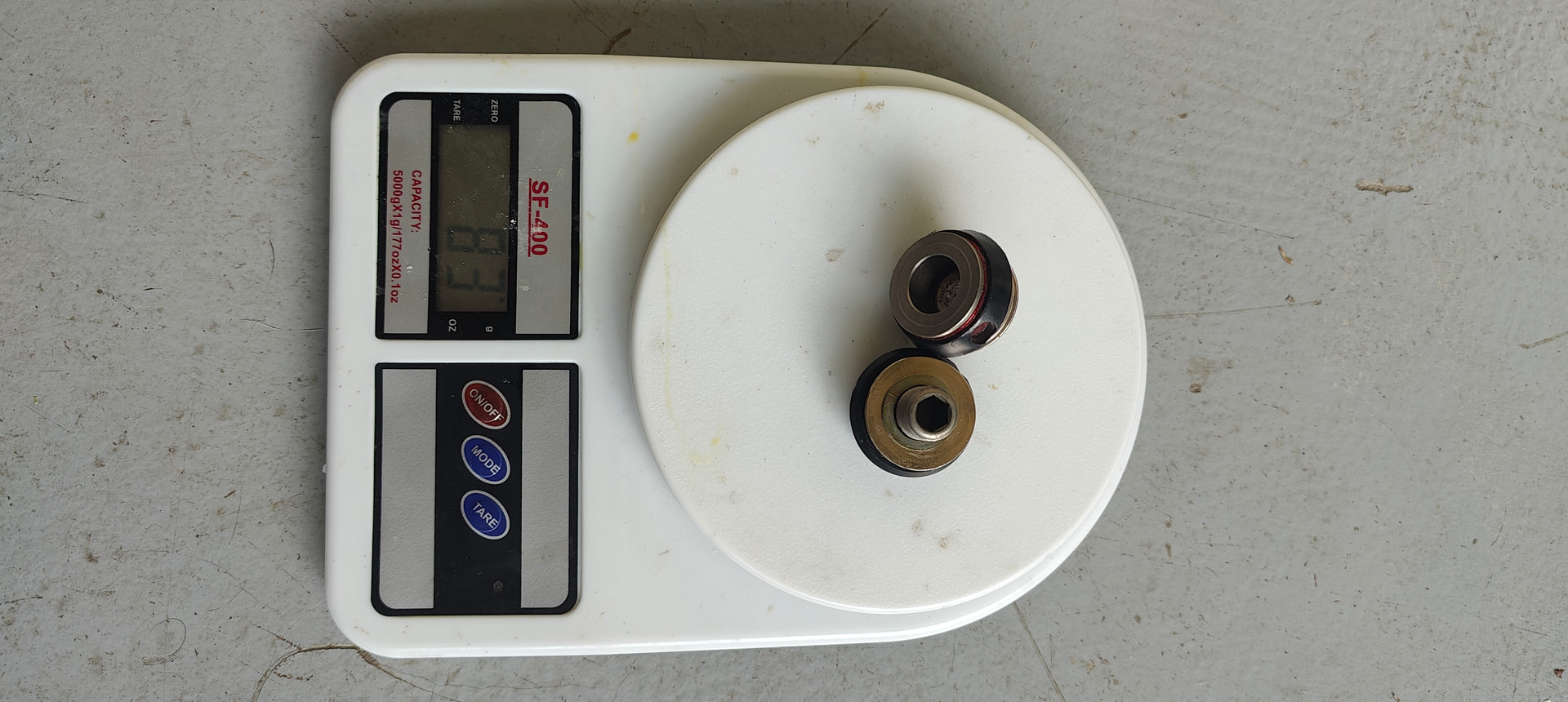

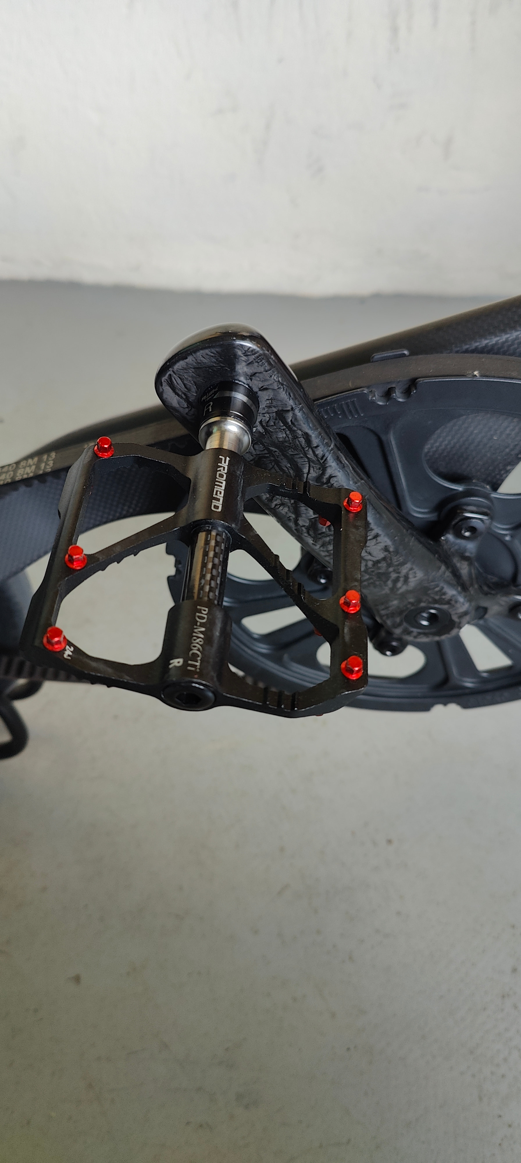

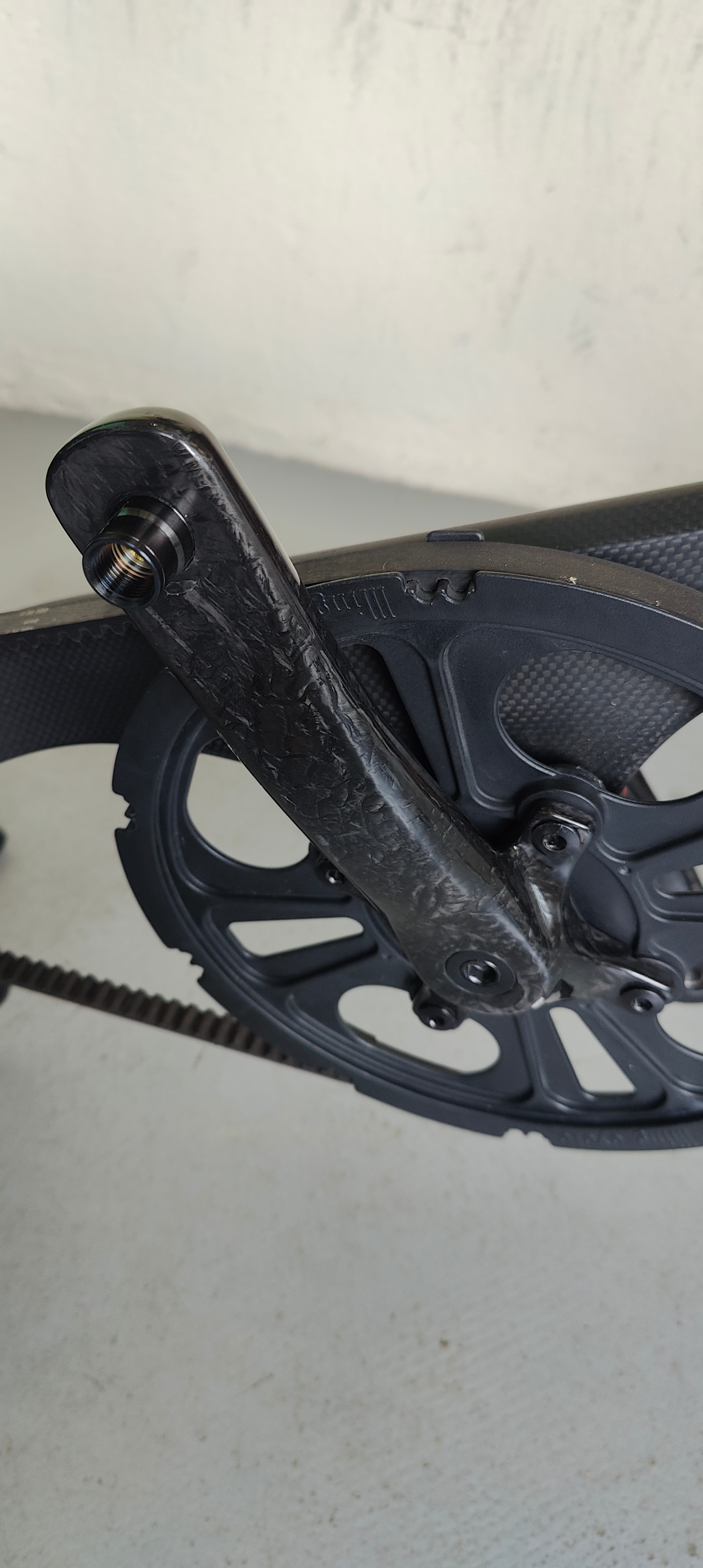

Here is finaly the working result by replacing the quite heavy original specific spacers by standard ones.
Take care,
Olivier
