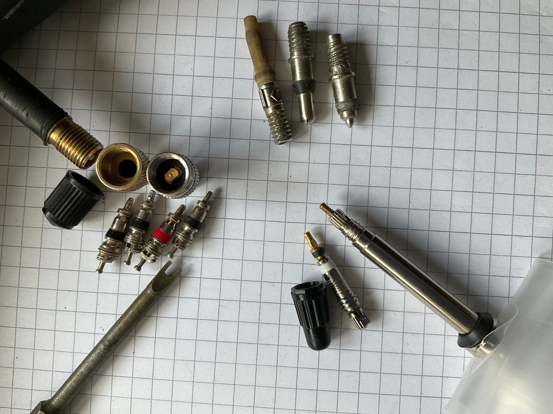

I purchased another AV/Schrader to Dunlop adaptor - the silver one in pic. 1:
It worked much better but still not satisfactory. You’ll learn why in a minute.

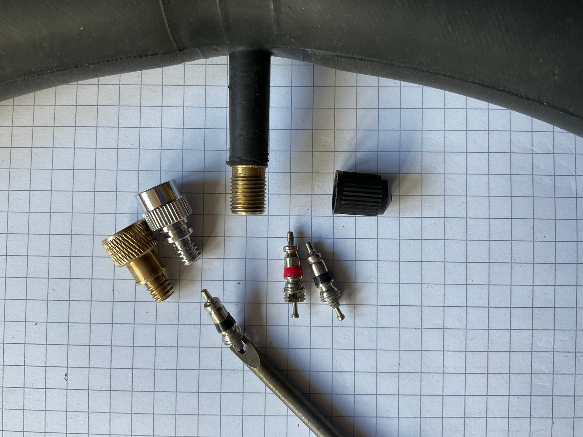

In pic 2 - on the left side - the same adaptors are shown: A brass coloured and a silver coloured with an inside mechanism.
The brass piston inside of the silver adaptor presses down the piston inside of the Schrader valve like every compressor at every fuel-station in the world would mechanically push open the Schrader valve. They have a second - low force - valve right behind the manometer that prevents the tyre from losing to much air when the compressor head is lifted from the car valve.
The same is true for the silver adaptor. It has an internal valve that does exactly the same.
However, when You screw the adaptor to the pressurised tyre’s Schrader valve, You hear a hissing noise. Unscrew the adaptor from the pressurised tyres valve You hear a hising noise, too.
In order not to lose too much pressure while removing the adaptor uncrew ist a quickly as You can! Now, how much pressure is left in the tyre? Quite a good question, isn’t it?
However, after a puncture and repair on the road, You’ll be happy to get ait into tyre good enough to go a few kilometers.
The situation with AV/Schrader valves on bikes - especielly folding bikes with small high pressure tyres - is frustrating. It might be less frustrating on low pressure high volume mountain bike’s tyres.
It doesn’t have to be this way.
Please refer to pic. 2 again:
AV/Schrader to the left, i show three differend kinds of Dunlop valves at the top. Even the good old “tube valves” work like a charm as compared to the AV/Schrader.
To the right we see a Sclaverand valve attached to a TPU tube, a Sclaverand insert and a dirt cap of a SC/Presta valve.
Take a close look at the SC insert! It has slack on both sides. I arrangesd it that way to show, that there is no spring inside a Sclaverand valve.
That’s why SC/Presta valves give You an accurate reading of the pressure while You pump up Your bike.
5 and a half decades of riding bikes showed me, that it doesn’t have to be as frustrating as with AV/Schrader valves.

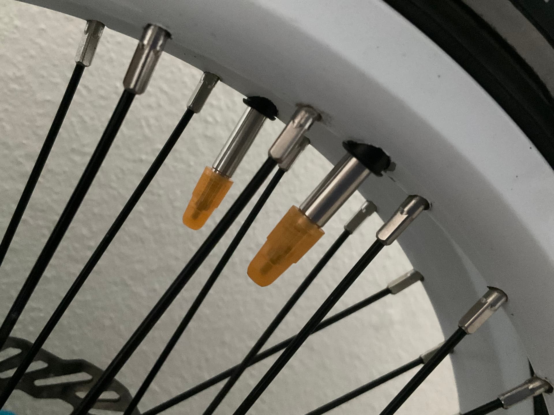

That’s how a Strida should look like:
SV/Presta valves - i call them Sclaverand and the SV in the abbreviation stands for exactly this: Sclaverand Valve - and the trouble is gone!
