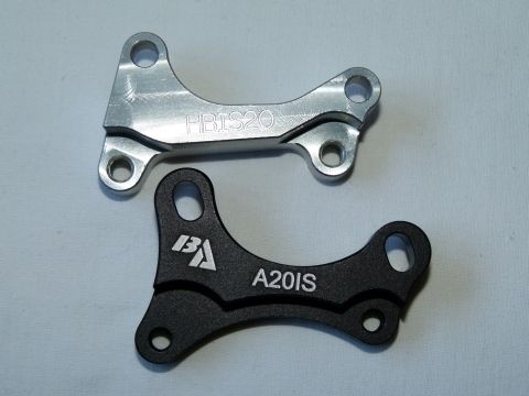

Using 160mm instead of 140mm rotors at the front wheel requires an IS2000 + 20mm adapter;
cubicapple wrote that Avid’s adapter did not work properly -
read here, that it might be tricky to make the Hope adapter HBIS20 (and some rotors) fit.

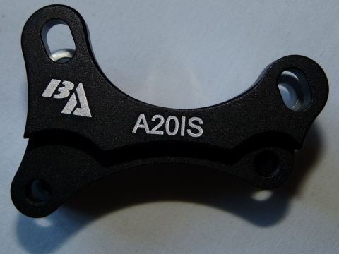

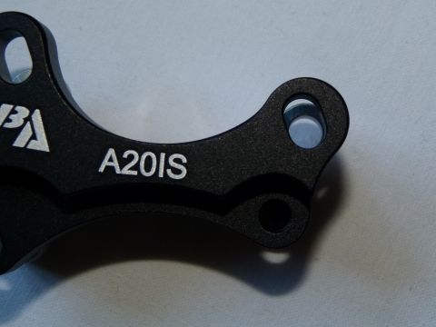

Another adapter, Brake Authority A20IS, compared to the Hope’s:
It seems that this adapter will not fit (not tested by now).

If you want a 160mm front rotor use the Hope’s adapter, but be prepared for some filework.
(That must not be necessary, it might be…)
