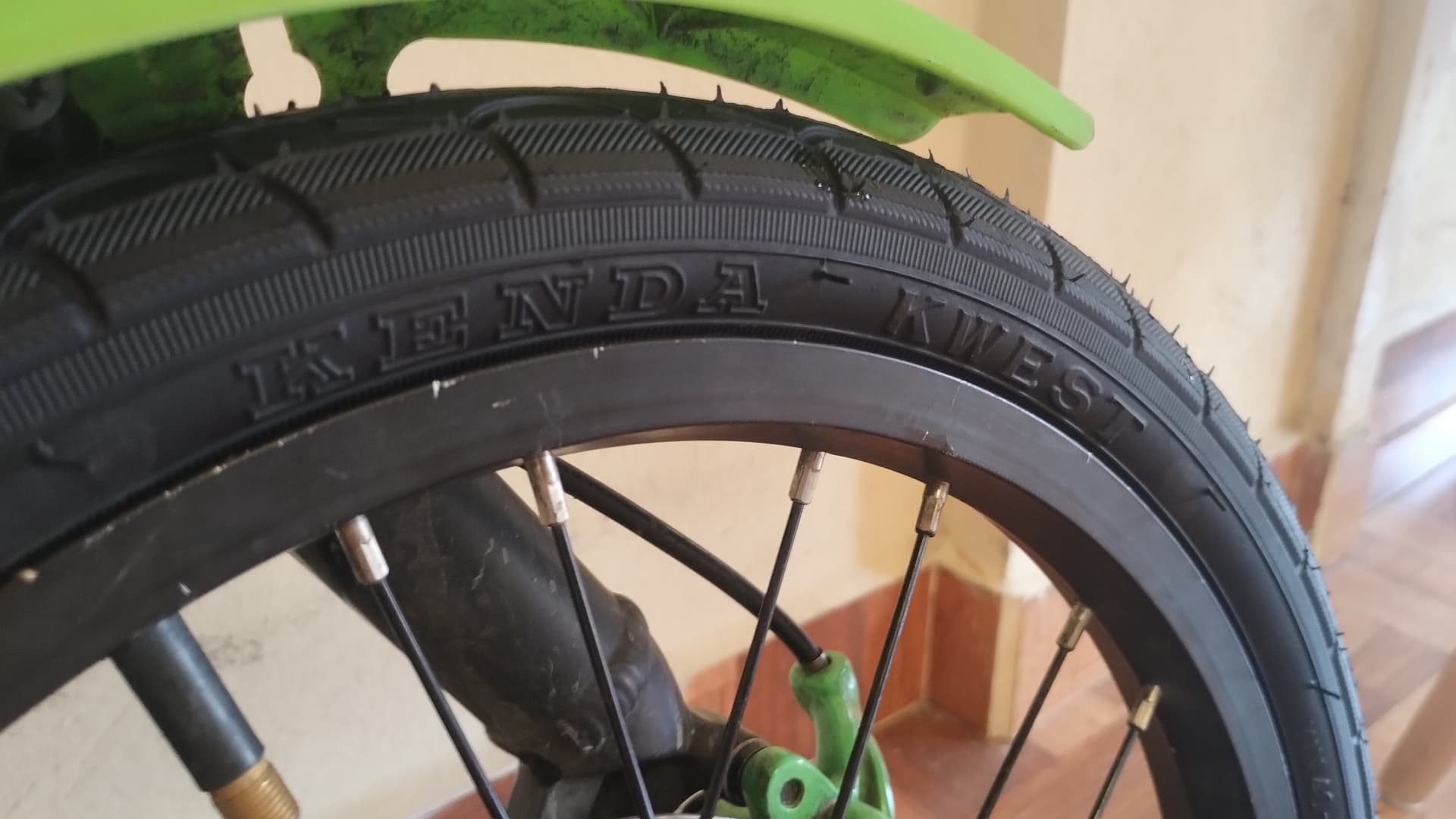

I just replaced my tires on a Strida MAS 16"
I bought Kenda Kwest 16x1.50 (40-305) that fits perfectly. I bought them on Aliexpress
I do this post because I bought a pair of 16 inches 1.5 tires on Amazon but those were bigger that the original tires and did not fit the rim. So I have to return them to the seller.
The Strida tires are not 16 inches, they are actually 15"! The 16 is a reference number, the tire company do not actually said they are measured on inches, just 16x1.50.
I hope someone find this useful!
Hello Pedro,
You’re pointing out a mistake which happens very often, I made this mistake myself too back then.
If you say that the real outer diameter of a Strida 16" wheel is in fact approximately just 15" (38 cm) you’re totally right.
To get the correct tyre for our 16" wheels, it is mandatory to refer to the ETRTO sizes.
Important for us is the bead seat diameter in mm, this is for our 16" Strida rims 305 mm.
Most likely you bought accidentally Brompton tyres, these are also specified as 16 x 1,5 (inch) but their bead seat diameter is 349 mm - that means 44 mm bigger (ETRTO 40 - 349).
The 16 x 1,5 (inch) specification is just not enough to identify a matching tyre - the ISO/ETRTO specs have to be watched, too.
