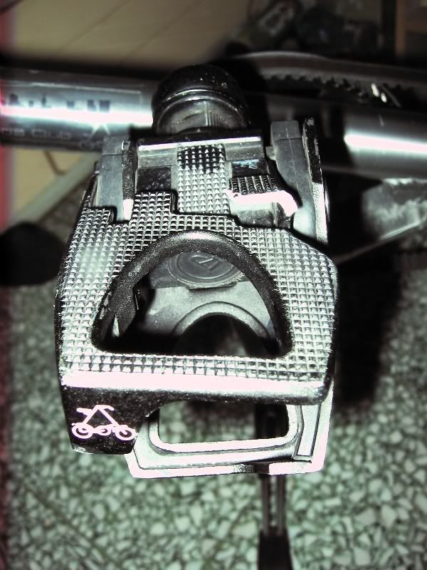

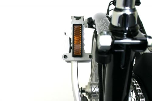

I like those Strida Aluminium pedals best (bottom picture) VP-F80 vpcomponents.com/newen/produ … .php?id=46 - they are stiffer than ANY other folding pedal due to their unique ‘butterfly’ mechanism - But they are not the lightest - the standard, all plastic pedal is lightest.

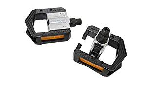

Googling around, I just found “Prolite Folding”:
Any ideas how they are compared to the aforementioned from the strida.co.uk site? … or any other folders one should consider?

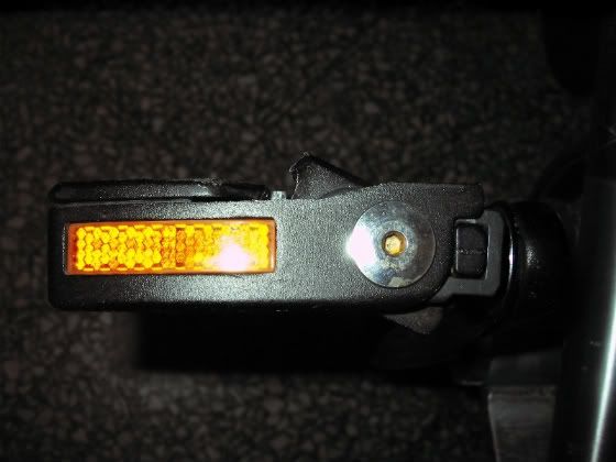

I’m curious of how the Alloy Pedal Set from Strida (the same as mounted on the SX i guess?) folds and unfolds. When “butterflied” like in the picture, they seem hard to unfold to me, but that’s perhaps not the case?

No, that’s definitely not the case. The VP-F80 pedals have the fastest and easiest folding mechanism which I’ve ever seen. :wink:

How about the dirt issue, do you get dirt/oil on your hands when you fold/unfold them?
No, I don’t. However, the pedals themselves get dirt/sand on the surfaces easily when I ride my bike in sandy or muddy environment. Furthermore, the aluminium surfaces become slippery in wet conditions.
That sounds good enough for me.
How do you actually fold and unfold them?
To open (fold) the pedal, stick a finger into the side opening and lift the top half of the pedal up. The bottom half, which is linked to the top half, will swing open simultaneously.
Yes. To close (unfold) the pedal, just reverse the above process. :wink:

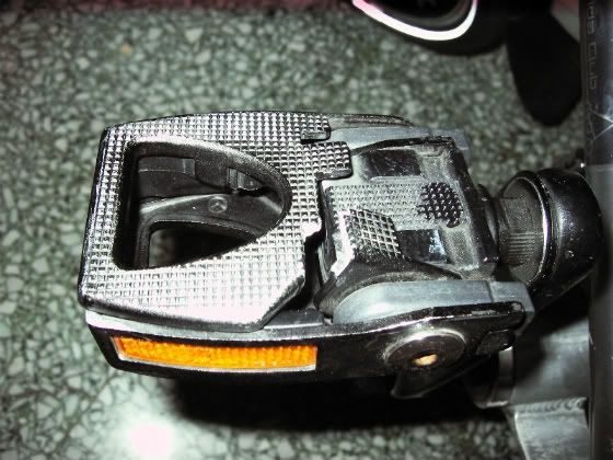

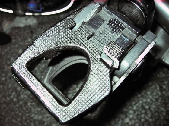

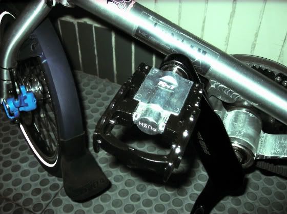

The left VP-F80 folding pedal on my SD broke recently. :frowning:

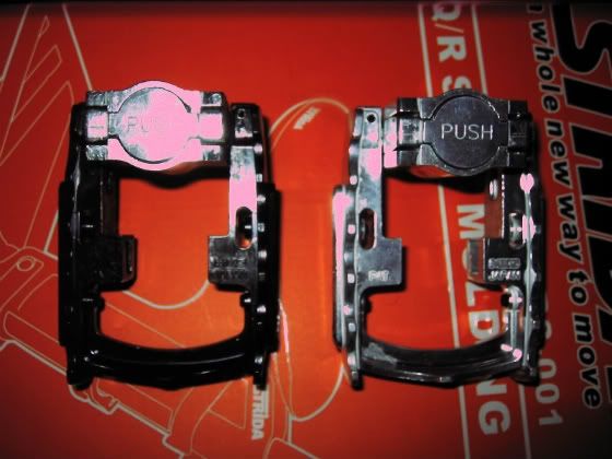

Therefore, I bought a pair of MKS FD-7 folding pedals to replace both of them. :wink:

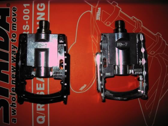

I already have a pair of MKS FD-7 folding pedals in silver before I bought this pair in silver & black. However, I think the silver pair do not match with the colour scheme of the black front pulley and cranks, so they have been idle for a long time. I have tried to find a pair in full-black but I failed because the manufacture of of the full-black MKS FD-7 pedals has already stopped due to safty issue. :confused:
http://www.mkspedal.com/fd-7kanren/fd7.htm
Here are the comparisons between a silver one and a silver & black one. :wink:

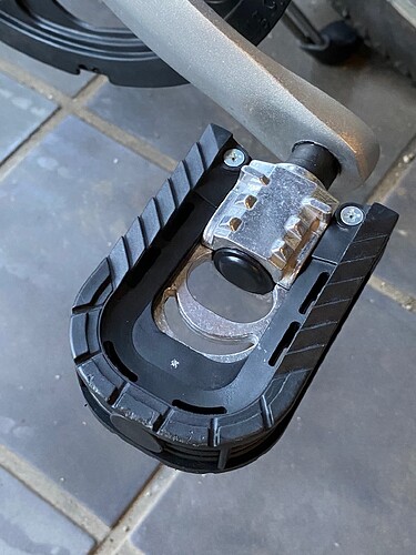

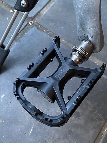

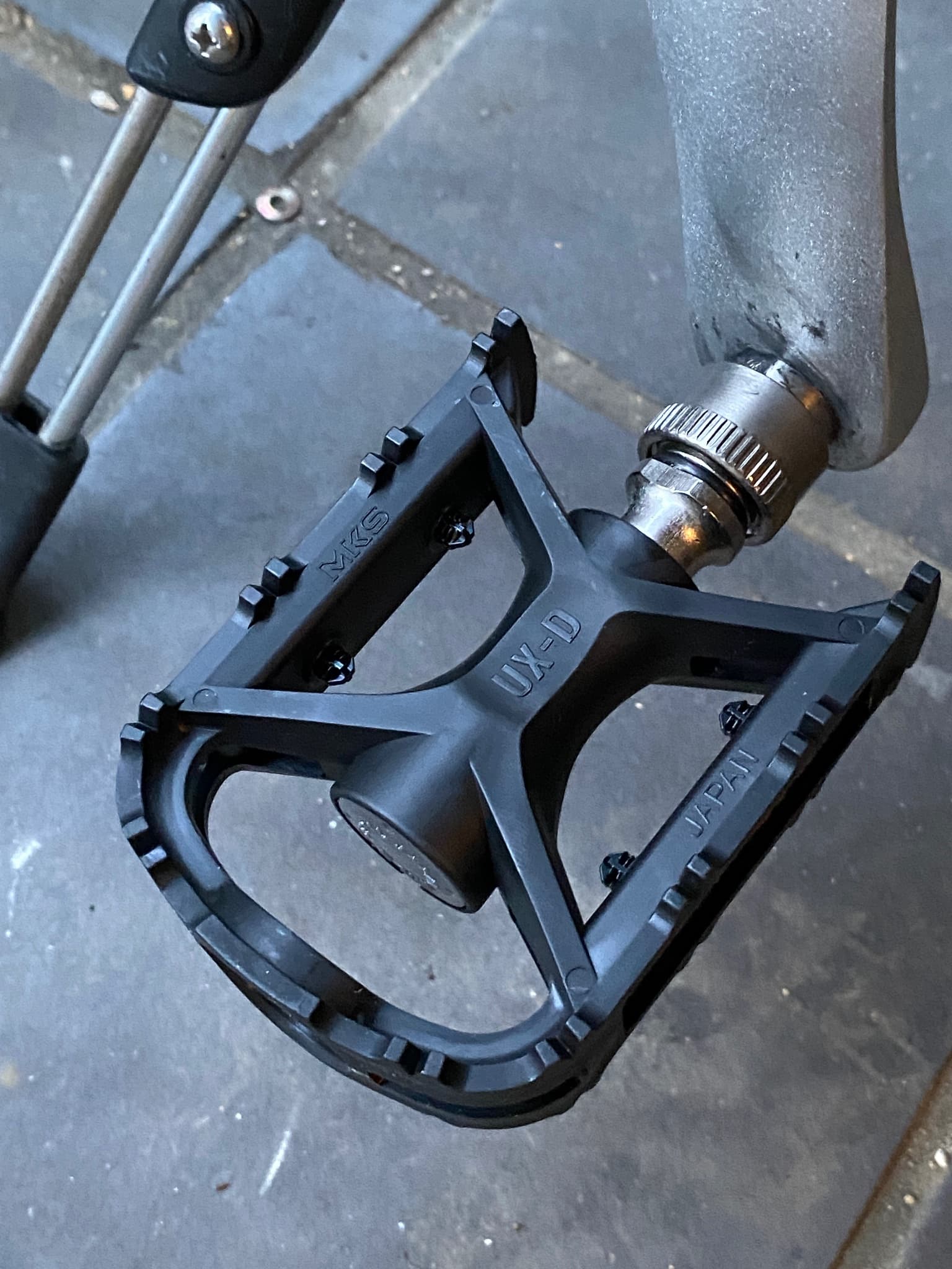

I got a Chinese folding pedal for under 1000 yen(or €7), and although the design and usability were good, the bearings were terrible…there were no anti-rotation washers and it seemed impossible to adjust the bearings, so I removed it and used MKS Ezy detachable pedals (the relatively inexpensive UD-X).
There is a plastic clip at the back of the detachable switch sleeve in the image above to prevent it from falling off, but the original C-shaped one is difficult to remove, so I use a compatible one with a tab.
