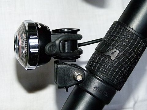

Here is nice DIY mounting for Magicshine lights, thanks to one_half _3544 ![]()
http://img834.imageshack.us/img834/425/imgp5856.jpg
http://img839.imageshack.us/img839/7932/imgp5864.jpg

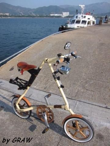

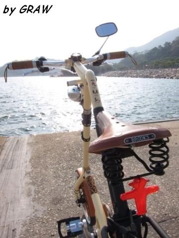

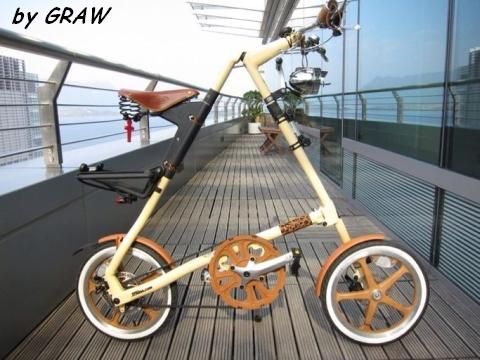

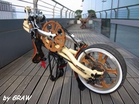

Below, as promised, pics of GRAW, member of the Hong Kong Strida forum,
original post here: http://www.hkstrida.org/forum/viewtopic.php?f=14&t=6306
(Registration and login required)
Many thanks to GRAW!

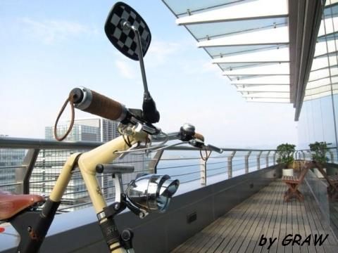

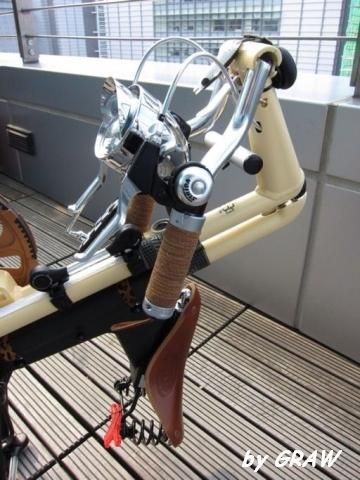

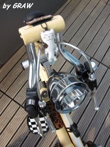

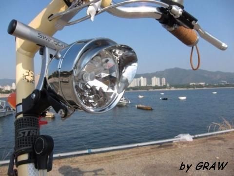

The form and size of the “bullet head” lamp are a question of flavour,
but the unusual clamp and the mounting location seems interesting:
The light holder “Swing Grip” SG-200 is a product of Minoura, Japan.
http://www.minourausa.com/english/accessory-e/sg200-e.html
It’s special feature is the thin stainless steel band of the clamp mechanism, very similar to the holder of the dynamo project - the Topeak Cage mount TCM01:
http://www.topeak.com/products/Bottle-Cages/cagemount
That is lovely, especially the light and the mirror and the colour scheme and the saddle. A lot of ands in there!
Looks very attractive, great light!

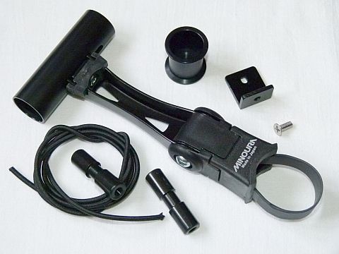

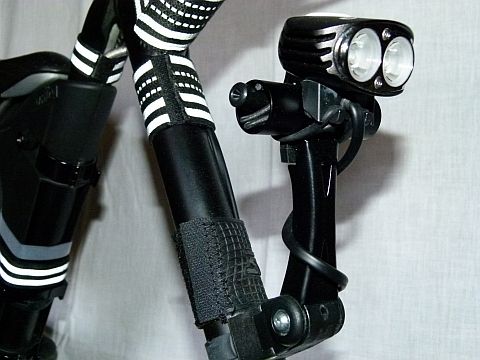

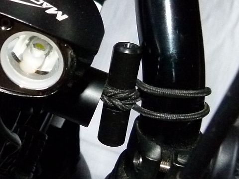

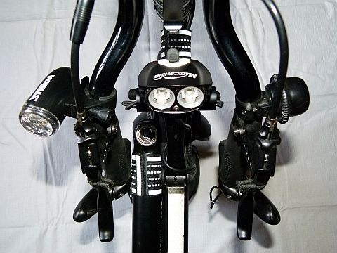

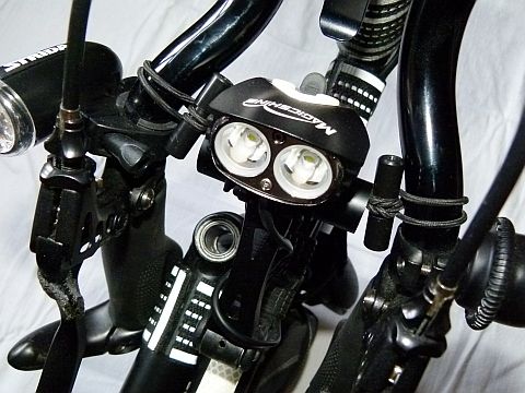

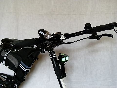

Recently announced, here’s another possibility to mount Magicshine lights on Strida - with bonus feature!

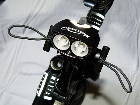

MJ-880 front light mounted on Minoura SG-200
Two plastic rods and some rubber cord inside of the aluminium tube…
…can be used to stop the wiggling of the folded handle bars.
Rods and cord inside the tube cannot get lost (providing that suitable rod size and bolt length will be choosed).

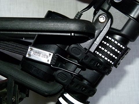

MJ-818 rear light mounted on home brewn “Magicshine-to-Strida” adapter and original Strida rear clamp.

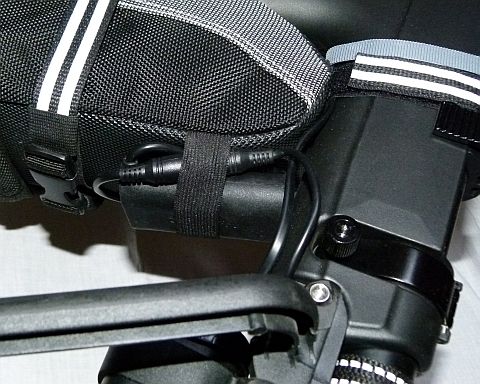

The monstrous accu for the front light fits neatly in the Strida carrier,
much smaller the rear light accu in the loop of the original saddle bag.
Weights:
Strida keyring front and rear, each ~ 15 g
=>Keyring light system 30 grams
Strida front light (~ 50) and carrier (~ 20), ~ 70 g
Strida rear light (~ 50) and carrier (~ 15), ~ 65 g
=>Original battery lights system 135 grams
(All above including batteries)
MJ-880 (~ 122) and accumulator (~ 398), 520 g
MJ-818 (~ 67) and accumulator (~ 123), 190 gr
=>Magicshine lights system 847 grams

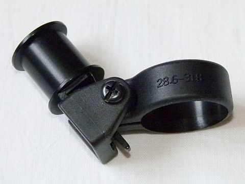

Minoura light holder ~ 105 g
(Aluminium tube shortened and black anodized,
steel carrier black powder-coated,
steel band covered with black heat-shrinking tube)
Plastic rods diameter 10 mm, ~ 40 mm long, 60 cm rubber cord 3 mm, ~ 15 g
Magicshine to Strida adapter ~ 17 g
(Made of full aluminium rod, diameter 25 mm,
~ 25 mm long and a piece of alu profile of 2,3 mm thickness)
original plastic rear clamp
