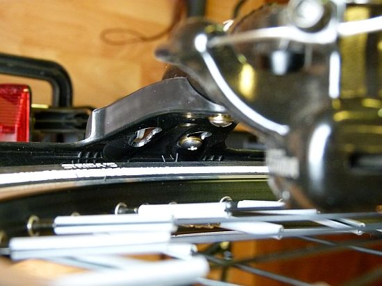

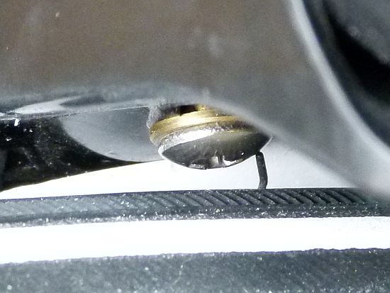

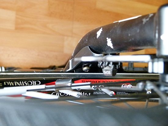

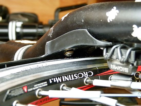

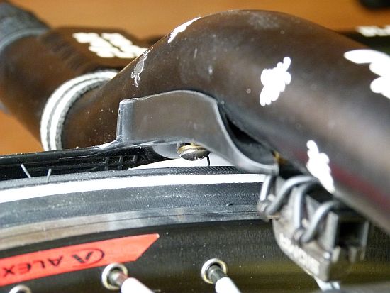

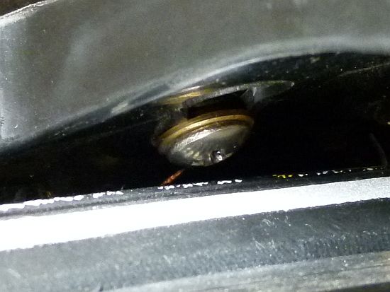

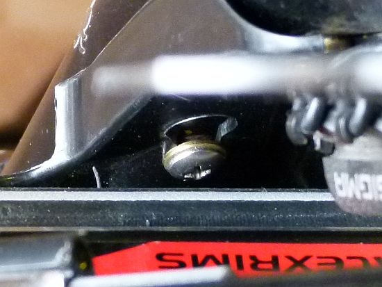

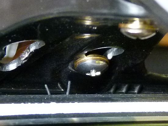

In an attempt to reproduce your issue I ripped off my Kojaks today and mounted fenders and Innova tyres…
Please see yourself; there’s at least ~ 2 mm clearance at the front wheel and about 5 mm at the rear.
(The front wheel is in fact not 100 % true, the above mentioned ~ 2 mm were estimated at the worst point.)
Here’s a piece of paper between tyre and fender:
Rear wheel:
Yes of course, this are not original Strida wheels, but they are built as close as possible to the dimensions of genuine ones, surely within a range of just a few millimeters.
With identical tyes there should be nearby no difference between our bikes…I thought… ![]()
Hi BSA,
Looking at the photos you posted , and comparing mine, originally Im having something like ~2mm too.At the first instance ,the sidewall of the rear wheel was rubbed by the top screw head.
I grinded the screwhead to make it flat , thus increasing the gap between the screw and the wheel.
Currently its about ~4mm and I installed the fender without the washer .I am in the monitoring stage at the moment.This morning I had a long ride of 55kms .on a mix asphalted park connector road.
