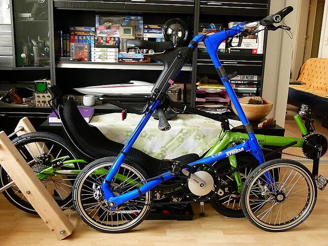

Did that already at my efneo Strida:
…and btw, there are odd things possible by switching rims:

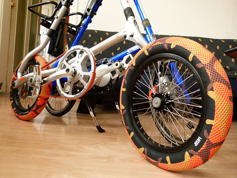

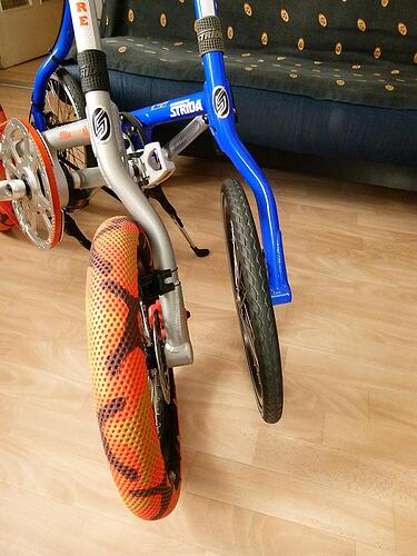

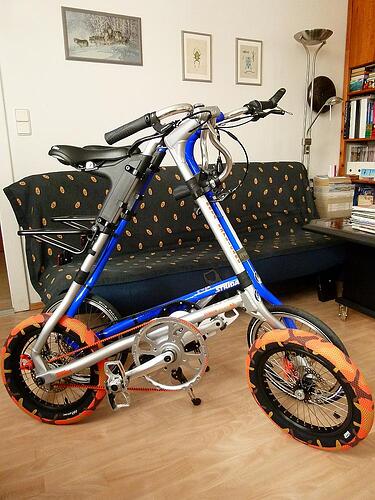

There is no way to fit Maxxis Hookworms, Hutchinson, Cult Vans onto original 16“ Strida rims!
16“ rims are just close to 22 mm wide, that means from 26, 27 mm upwards it will work.
It doesn’t work that way, first you need rim and hub – and then you calculate the matching spoke length. Most likely, the original spokes will not any longer fit.
And it would need to be a wide 305er rim with 36 holes – and accordingly 18“ hubs.
(I could not recommend trying to use 16“ hubs – they have only 24 spokes.)
Yes -and that is the reson for me to say: „Not recommended!“ in sight of durability.
The rear wheel is „dished“ about 5 mm to the left, there will be more load at the axle, etc. – this doesn’t matter for a show-bike but it does for daily use.
The axles are untouched, but there are additional spacers for magnet and counterpart installed and also longer wheel bolts.
If you are heavy and used to ride like a berserk I would recommend such wheels indeed (just a version with 2,0“ wide tyres and not 2,3“).
But if you are an average rider you might try a less expensive (and complicated) alternative:
Try to find standard metal spoked 16“ wheels (not the plastic version!) and mount Schwalbe Big Apple in size 50-305 on it.
It is weird that these do fit while several other tyre brands (which are less wide!) do not.
Anyway, with Big Apple you get the same comfort as with Cult Vans (perhaps even better because the Apple’s are a bit softer).
Plz let me know if there are more questions :wink:

No problem to check that as we know the circumferences of our tyres; we have approximately 1265 mm for a 50-305 tyre and for the 35-355 tyres we will land at about 1350 mm. Divided by Pi, we get 403 mm and 430 mm; the diameter of 18“ tyres will be 27 mm larger than that of this 16“ Big Apples – about 6,7%.
And I meant actually that the better alternative are – Big Apple’s in combination with 16“ Strida standard wheels, like this:

Hi, Chris, I think I did not pay proper atention about something(s) you wrote in that questions/answers in the forum… if using the standard Strida 16" spoked wheels with Big Apples, can I just take my 18"s away and keep the “old” SX Flywheel and brake disks, or I will have to change it all? as you say that your Strida with orange 16" (with a wider rim?) Vans tires would not be good for everiday use, will I be able to use, dailly, 16" Strida wheels with Big Apples? aparently, if with the 16" wheels with Vans you had to dish the rims, that will not be necessary with Strida 16" with Big Apples… I found that in strida.nl they do not have 16" black rear wheels, is it just a temporary “out of stock” issue?
Thank you very much!
Truly possible, but my odd English can be misleading, too :confused:
You can keep freewheel and brake discs - but you need a 4-notch standard BMX tool for the freewheel and a Torx T25 bit (key, screwdriver) to mount/unmount.
The Vans are overkill and actually too wide (“dish” required) and these rims are not any longer available.
Sure. Just to repeat - small modifications are required regarding the magnet catch function.
