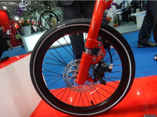

Strida with front suspension
Strida front suspension at Taipei Cycle Show 2014

Here is the pic:
Nice solution, but the price and the weight will again increase :confused:
I’d use a piece of rubber: easier and cheaper.
There is probably a piece of rubber inside the fork leg (or a coil spring), but this “heavy” and complex construction is needed to provide the required stiffness (single side fork) as well as a proper guiding of the wheel: the lower part of the fork may not rotate relatively to the upper part :laughing:
I stared at the picture for a good half hour trying to figure out how it worked. That hinge wierded me out. I’m still a bit baffled with the bend in the fork being right there, but I’m no engineer.
I would like one of those but between the weight gain and added maintenance, I’ll pass on it. It’s probably for the best as I’d invariably end up doing something on my Strida that I shouldn’t and wrecking something.
I wonder if they’ll sell just the front fork/tube so folks with the older models can upgrade.
