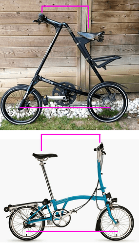

I just saw a classified for an 18" EVO Strida, and was wondering what the distance is between 1) the handlebar and the seat and 2) the two wheel axles, as compared to a Brompton :
Thank you.
Thank you.
Hello Winfried,
I mean it is hard to tell a certain dimension for the distance between steering and middle of the saddle - due to the unusual seat height adjustment of the Strida (seat molding sliding on seat tube) will this distance depend mostly on the leg length of the rider. The higher the seat, the shorter the distance - though the effect can be mildened by moving the seat a few cm’s back and forth within the clamp of the molding.
Overall maybe ~ 40 to 55 cm.
The wheel base of Strida frames will be ~ 895 mm.
According to this page has Brompton before 2003 a wheel base of 1.02m (40.2"), since then 1045mm (41.2").
brompton.zendesk.com/hc/en-us/a … heel-base-
Could you find info about the Brompton saddle - steering distance?
Brompton :
Middle of seat - P handlebar ≈ 640mm
Wheel base ≈ 1040 mmm
So it look like the 18" EVO is shorter, whether in terms of seat - handlebar, or wheel base.

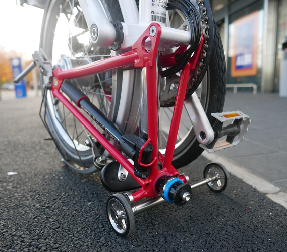

In the Pros section, I’ll add that it’s easier to roll folded than the Brompton, although you need to carry it as upright as possible since it’s not that light either.
OTHO, the EasyWheels on the Brompton can be improved with the Bikefun X-Roller Easy Wheel Extender (£75, though), so we might have a draw here.
