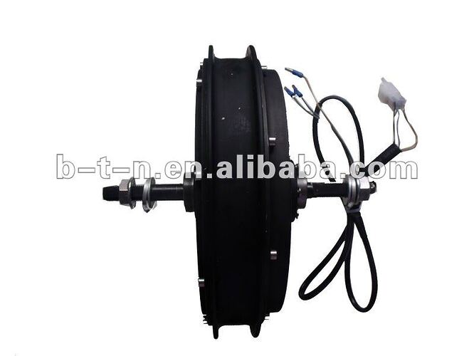

Thank you very much for the information. The bike im using for retrofit is a decatlon bfold 5 but i am nearly doing from scratch. Cause i am only keeping the frame and reinforcing it to acept all the new things i want to install… As brake discs, fork shock, electric motor of 3,5kw…

My motor is a nine continent that is in the wheel not a center motor
What i was asking is if the rear pulley had a standar “screw”(i dont now the word for it) so i could put it on the motor

Unfortunately there could no data sheet of the Nine Continent motors be found,

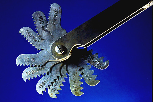

but if you have a caliper and a Whitworth thread gauge (= “medir”?) you might measure yourself.
The required outer diameter of the hub for a Strida freewheel is 1,37", that means 34,8 mm (34,6 will also do) the pitch is 24 tpi (threads per inch).
This thread seems to be very common for singlespeed freewheels.

i was out and i could not measure but it is an standart thread… i think it will do.
