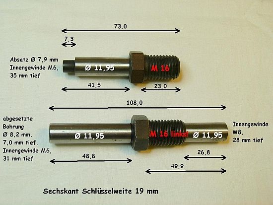

Yes right, I was also thinking of a fine pitch thread here, there is just the disadvantage of another unusual part - the fine threaded lock/adjusting nut(s).
However, I think such a kit cannot be realized without help from Ming (or their suppliers?)
The initial reason to take the picture below was the request for a quote to create a pair of similar axles but made of Titanium.
It was sent to a German custom parts manufacturer (Al + Ti specialist), the guy told me that the inner threads will be problematic to drill - due to the Titanium characteristics.
He meant it would be much more easy to elongate the axles a bit and use outer (male) threads.
(Function would be recovered by the using nuts instead of bolts, of course will a magnet modification - or even redesign - be required.)
Anyway, the working costs for such a (yes, Titanium) custom axle pair would be ~ 300 €.
So, even if made of steel, the costs for the kit will be far above your limit, I’m afraid of…
(I did not consider the costs for the 100-07 part made of steel and the smaller parts).
Above will apply to most European countries, I believe…custom made parts in small amounts are very pricy.
With the help of Taiwan could the kit manufacturing costs be decreased dramatically:
Did you know that the shown original axles were bought for ~ 20 € - per pair?
End user price, including all the sub-dealer margins…

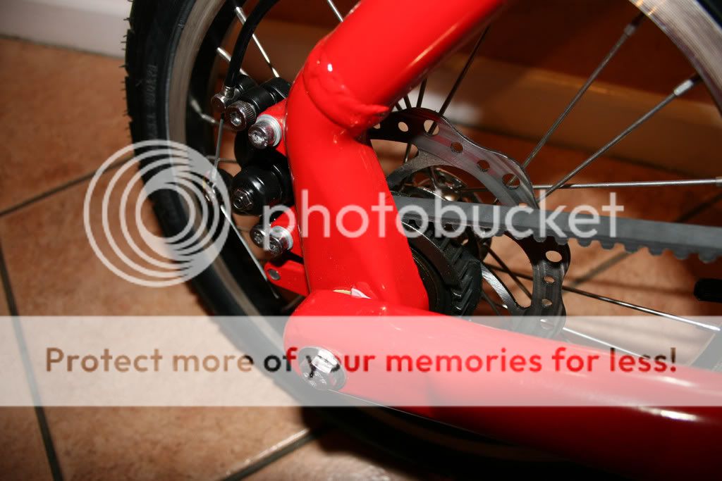

As you can see in the picture, there is a silver bead around the cup spring washer(PrNo367).
I guess this is because the edge of the washer scrapes the surface of the frame…
Are there any countermeasures parts currently available?
Hmmmm… :thinking:…I’m not so sure about that “bead”…could be also the place where a sticker was before painting the frame.
