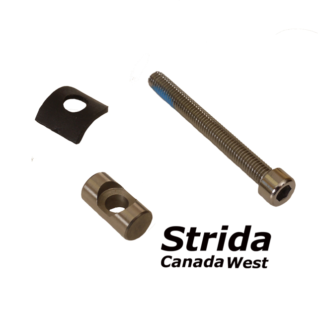

Hi jagmagana,
https://stridacanada.ca/product/strida-handle-bar-release-lever-bolt-nylon-spacer-and-axle/
it seems recommendable to change at this chance also the small black plastic part below the lever.
If you plan to use a non-Strida M5 x 45 mm Allen bolt please do not forget to apply a little drop of (Loctite) thread locking compound at the bolt’s end ![]()

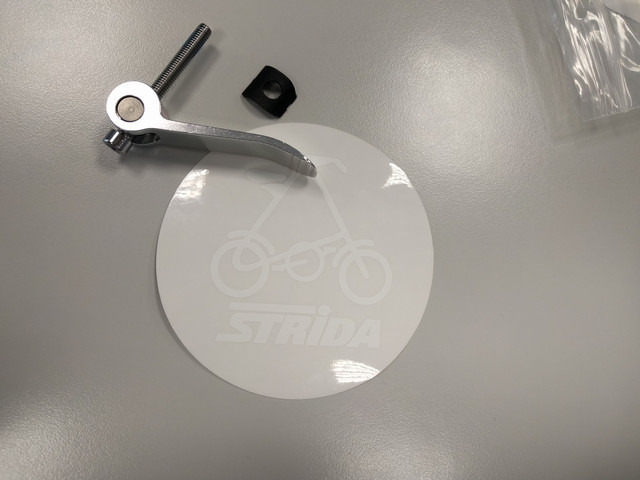

Finally i bought items in Bill shop (strida.ca), I did not notice that the prices are in Canadian dollars, and the price is lower than I expected.
Today, arrived my order from Bill shop https://stridacanada.ca
Perfect!!! Thanks Bill !!!

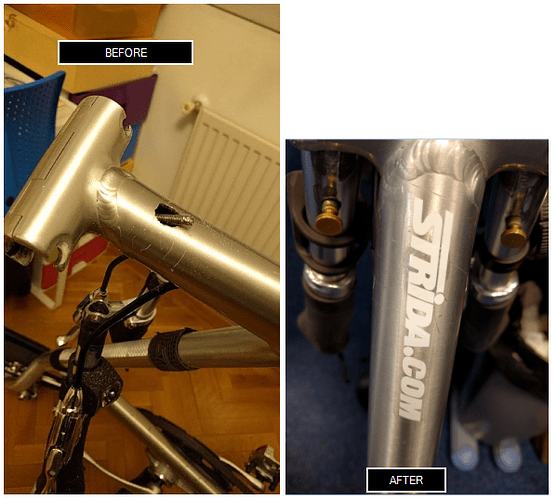

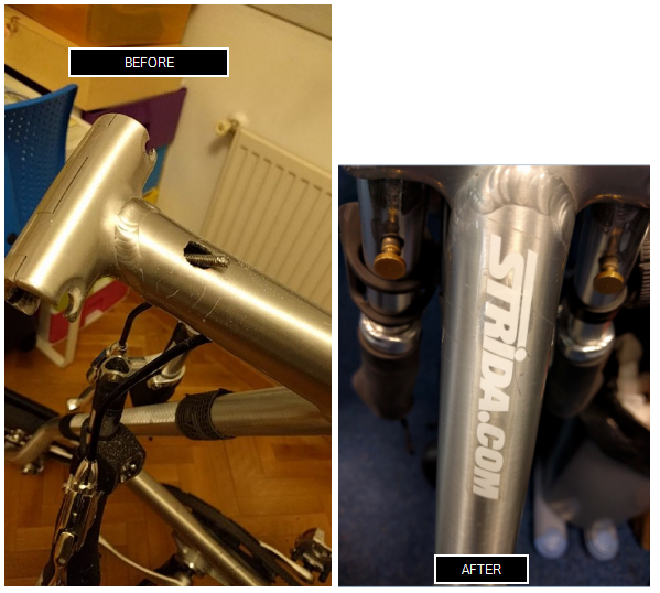

Before and after repair the hole (With Pattex Nural 21) ![]()
How did that happen?
Did you try a much too long bolt and used force?
Hi !!!,
My problem was that the bolt was broken (being inside the thread), I could not extract it by its normal output … then I observed (through the hole in the brake cable and with the help of a flashlight) that the thread was not blind, continued through the another extreme … I made a hole to access the bolt on that side to extract it out there … drilling with a 1mm cobalt in the center of the bolt to form a “line” where I could hook the screwdriver … after extract the bolt i closed the hole with special putty for metal … a little adventure …
I hope you did consider that you perforated the steering tube once more - there are already two holes at the underside (for the brake cables) in that area.
You did know that it is (generally) possible to order single Strida tubes?
Honestly mate - I’d recommend to change that tube ![]()
Yes, I know that a third hole can weaken the structure … the hole has been closed with a special metal paste and for now It looks strong like a rock. My daily journey to work on the Strida is very calm … If I detect in the future any kind of weakness or fissure in the piece will change the full piece. Thanks
