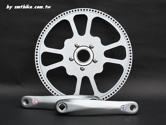

Here’s my question: I came across a friend’s Strida 3 and I immediately fell in love with it.
I bought it from him (he decided to go for a Brrr…omptom
so better for me!).
Now the “Customization” disease has infected me very brutally and my first serious project is to get rid of the dirty grey plastic freewheel dish to get a more elegant alloy one.
I’m not interested in adding gears or change the beltwheel ratio, just and aesthetic improvement.
I googled frenetically with no results.
Does anybody can help me?
Suggestions are very well welcomed.
Thank you in advance.

Had recently very nice contact with the new young sales guy of Five Big - “Kris” ![]()
(May I try to connect you both?)
And one thing more…you did know that you’ll need a special tool to un/remount the freewheel?

Of course I’ll tell Kris about your wish; I’m planning to order a few EVO beltwheels soon.
But naturely it’s no secret that Kris’ business address is smt.bike@msa.hinet.net
Unfortunately is Victoria not any longer an employee of Five Big.
The video doesn’t show the tool which I’ve meant before,
it’s necessary to loosen the freewheel from the crank axle
(at ~ 4.20 of the video is the crank/belt wheel assembly out off sight; after that one can see the actor tightening the freewheel by hand).
Please refer also to here:
http://www.stridaforum.com/forum/viewtopic.php?f=2&t=3318&st=0&sk=t&sd=a#p8211
