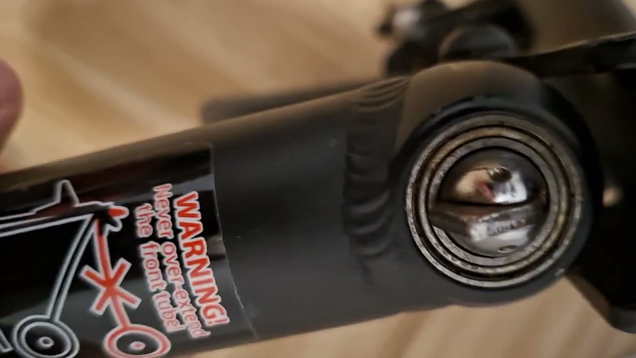

Insert your finger in that hole and make sure that you feel the inner ring of a ball bearing.
It must be moveable, it does not need to run well.

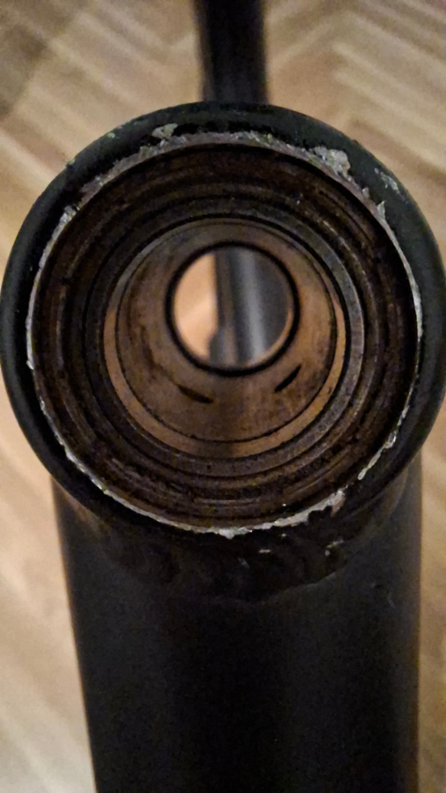

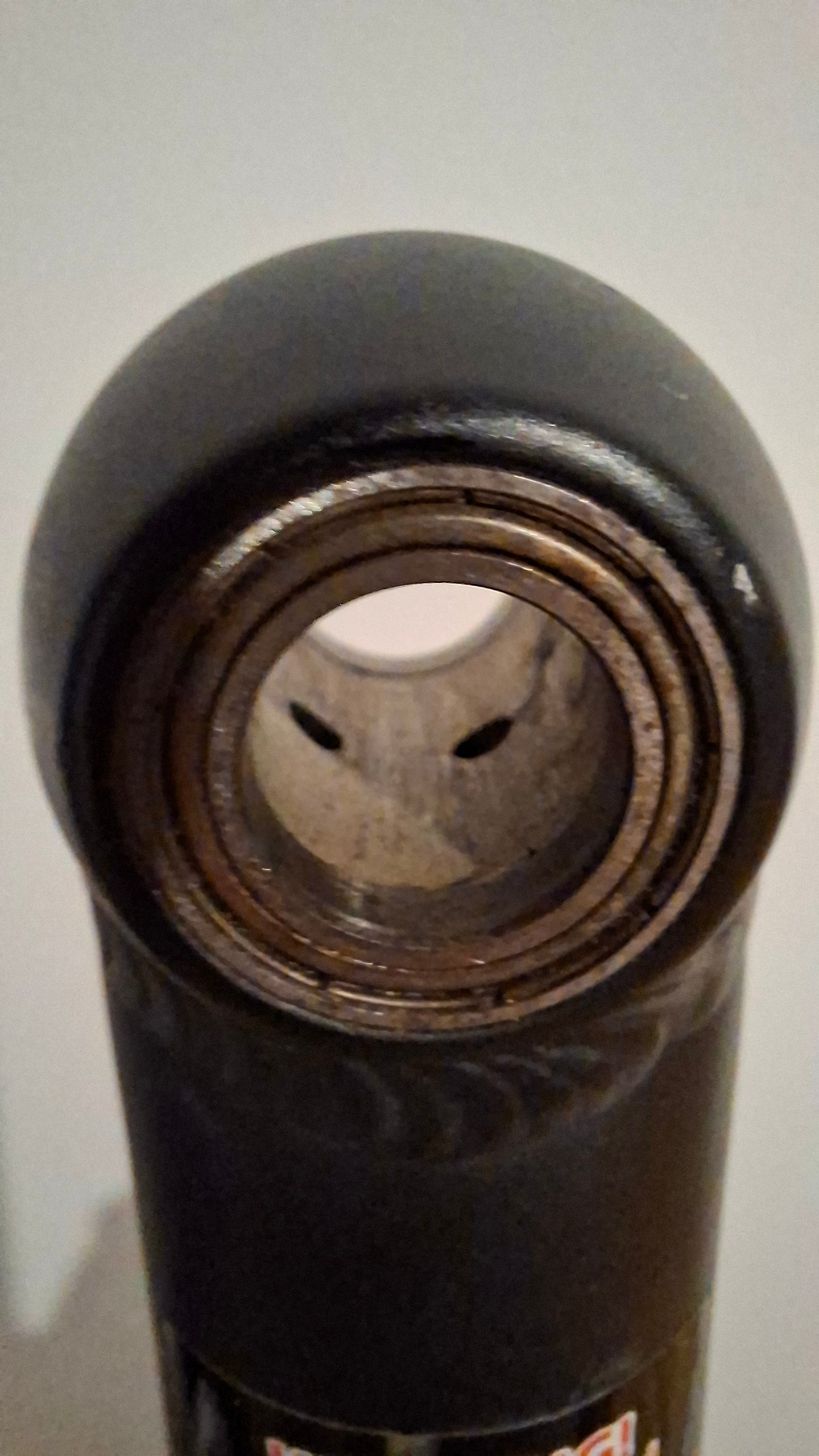

I can’t see any visual differences between the two bicycles regarding the holes for the steering pin.
Yes, I can turn the bearings with my finger, one is on top and one on the bottom.
They don’t turn smooth as on the other bicycle.
