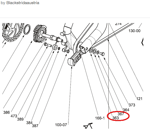

I think yes there is a chance to check:
  • Remove the cup spring (p.nr. 367) of the rear joint
    (Is there a groove in the frame? Can you take a close picture of it?)
  • Break the sharp edge along the outer circumference of the cup spring with sandpaper
  • Put a little bit lube below and reinstall the cup spring.
Crackling totally gone - it is the rear joint and you need a rear hinge kit.
Crackling still present - most likely is the KS3 damaged.
No, the KS3 can’t be serviced locally by a store.
I’d say if it’s a really good store - then it should have one or two replacement drives in stock.

The 373 bolt is currently just a bit loose, but still I can’t remove it. Should I apply more force?
No, not more force please :neutral_face:
I guess you mean the parts below the bolt’s head are loose and the head is tight.
That would be for me a sign of a damaged rear joint.
They don’t feel loose, but regardless, I can’t loosen the bolt/head as it’s very tight.
How can I remove the bolt to check the state of the parts below (cup spring, washers, frame) ?
Bolt 373 is originally glued - it is now very hard to tell why you can’t remove the bolt.
Either it is just the glue still holding the bolt - or, that would be dangerous, maybe there is rust in the thread. You are now of course in danger to break the bolt…that would be pretty bad because in that case has the complete axle to be replaced (that again means complete disassembly of the rear part).
I would now try to heat up the bolt’s head a little bit, not with flame but with electric heat gun.
There is no other way than that of removing 373 first - it is impossible to get “from the other side” because the axle (at the same time axle stump below 373) goes through the bottom tube.
Do not break the bolt if possible.
Can you tell:
Is it possible to turn the washer and/or cup spring below the bolt’s head by hand?
Try that with the bike laying on the left side.
While you try to turn the parts with one hand, use the other hand to pull the right crank gently upwards and downwards - crank in 90° position related to bottom tube (to generate torsion of the bottom tube).
