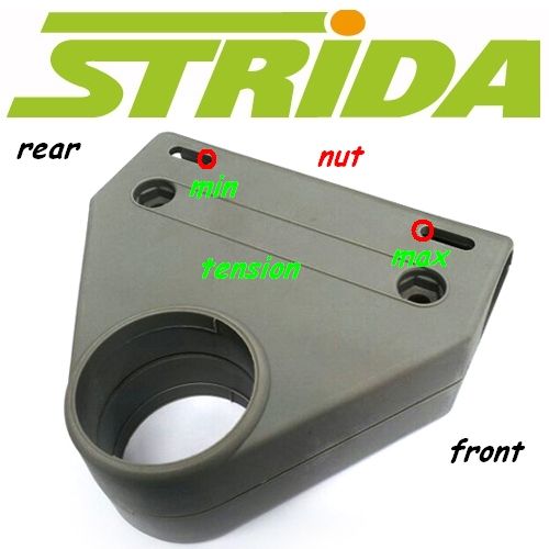

The adjustment is done by moving (sliding) the whole bottom bracket along the bottom tube.
(Moving forwards will make belt tension higher due to the higher distance of the belt wheel centres.)
The upper holes are slotted for this purpose - that’s very hard to recognize at the manual pics.
The nuts are intended to secure the manually chosen adjustment.
If the teeth of both wheels are really OK I’d say there’s something terribly wrong with your belt (?)
Yes, pics would be fine, I bet both of your upper bolts are in the left position of the pic below…

Thanks to your pic I now understand what I’m supposed to do when I unscrew the bolts :smiley:

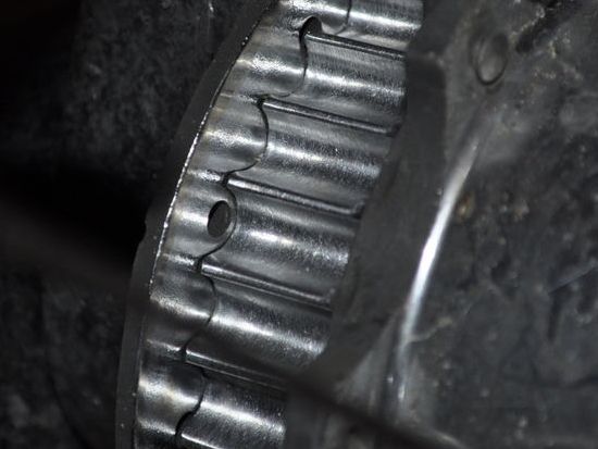

Here is the state of my indentations. What do you think?
Your rear beltwheel is worn out!
(As it is one piece with the hub we could also say the rear wheel is worn out.)
One can see that clearly on pics 4 and 5:
The higher area of the teeth (outmost diameter) should be shaped flat, just like the teeth of the frontwheel; yours are extremely rounded.

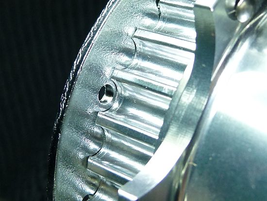

Below a new aluminium beltwheel and an older one with beginning signs of wear:
The effect of this kind of wear is also a reduction of the outer diameter and again this is leading to a loose belt. With a rear wheel like that you will never be able to adjust tension properly :cry:

Judge yourself; your hub
compared to a brandnew one:
