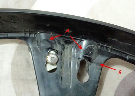

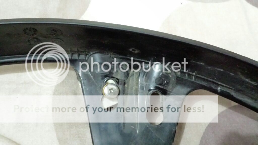

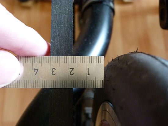

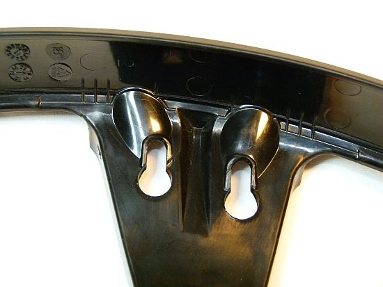

I have this tyre rubbing marks at the side of my rear Fender .This is my second fender attached to my SX 18 inch Rear tyre.I am wondering what is causing this ?The wheel seemed to be fine without sign of bearing wear and been using my strida since mid- November 2013. This a bit strange .My tyres are all Innova 18".
Most of us will not be able to compare; fixing that was easy…
So, the tyre profile grinded the two areas A, the little sideways rubber spikes created the marks in the direction of arrow B and even the surface of the bolt was in touch with the tyre (correct?) - really odd!

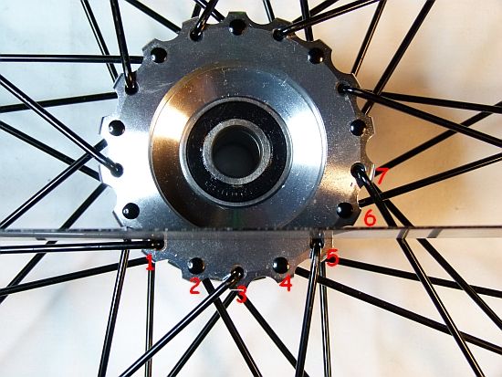

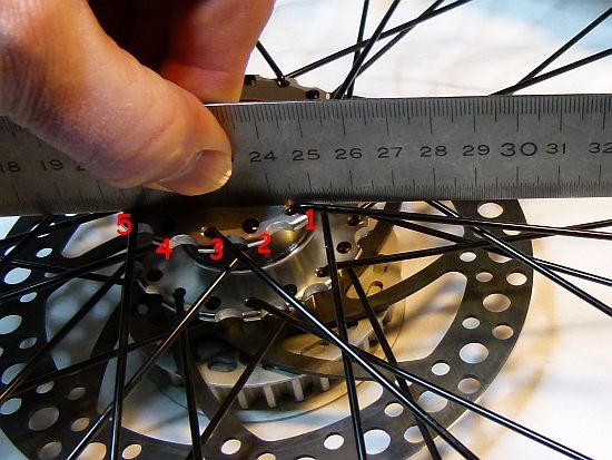

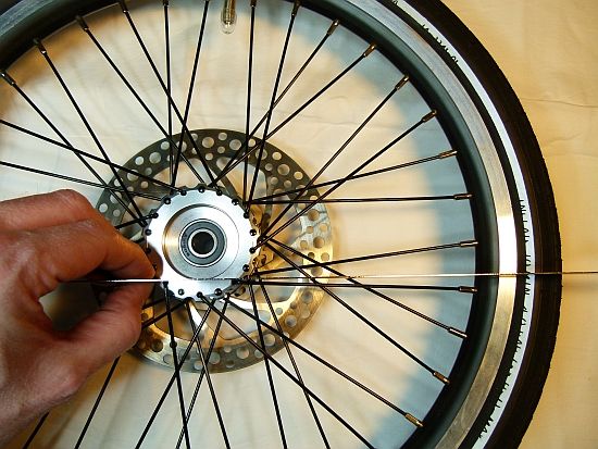

I’d like to compare our wheels; you wouldn’t need to disassemble anything,
just the measuring method is a bit tricky and will require some explanation.
A helpful hand might be also recommendable ![]()
All you need are two (steel) rulers ore anything similar.

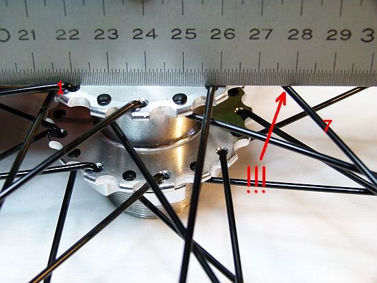

Look for three outer spokes and push the edge of the ruler onto the outer side of the hub flange,
directly below the counterpart of the magnet - like cutting 5 spoke holes off the flange.
Now count the spokes, beginning from the one which is most parrallel to the ruler.
The ruler should be very close (or in touch) with the spokes 1 and 5.
Please note: Strida wheels are built sometimes with the leading spokes on the outside and sometimes on the inside of the flanges!
Therefore you have to count either clock- or counterclockwise; depending on the spokes direction of your personal wheel.
Watch out for spoke 7 - it must not touch the ruler!

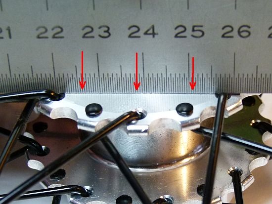

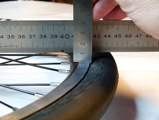

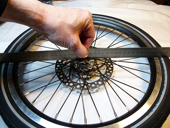

Once the edge of the ruler is sitting properly on the surface of the hub
you (or better your assistant) can measure the distance to the rim.
I’ve checked that way three original rear wheels, all were between ~ 5 to ~ 9 mm.
Of course will that amount vary due to the trueness of the wheel,
but if yours were, say, ~ 12 - 14 mm around the whole rim,
- then could the reason for your issue be a sloppy built wheel.
Caution: Different rim widths would require a new calculation of the correct hub flange to rim offset.
To assure that we’re using the same rims you might measure the rim width outside, should be ~ 21,5 mm.

Would it be very much effort for you to check the wheel as mentioned above?
@BSA,
I had a quick check on my wheel /spoke and gap at the rim edge this morning.
First, the ruler ( i used a triangular scale rule) touched the 7th spoke in most of the spokes.Only a few are not touching but the gap is almost a hairline gap only.
2nd, the gaps at the rim edge is (approx) >10mm.

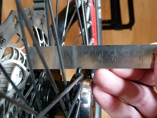

please let me suggest two more measurings, both are very easy:
First - to assure that Ming didn’t change the hubs width recently - it would be good to measure from brake disc to the above mentioned outer flange edge; that should be ~ 44 mm.
And second - as a sight from the opposite direction - the distance from tyre to belt; below with Kojak ~ 17 mm, with Innova maybe around 14 - 16 mm (?). I mean below 12 must be the critical border…

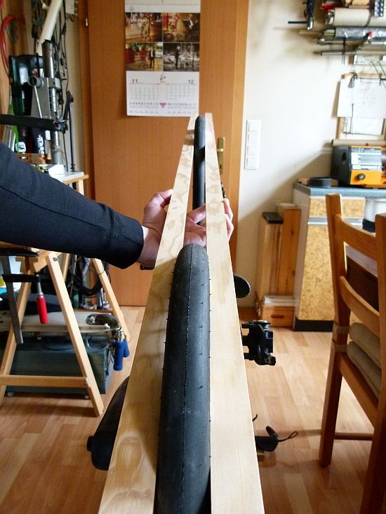

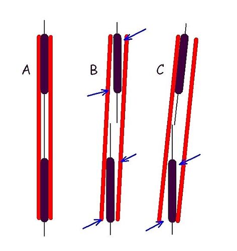

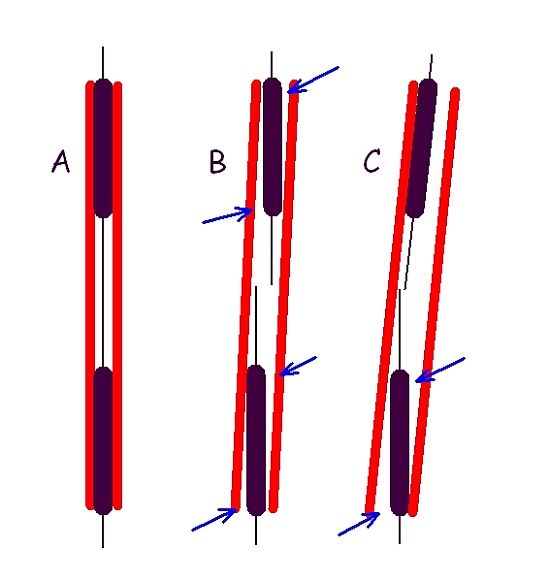

Perhaps you are able and willing to try the following too…

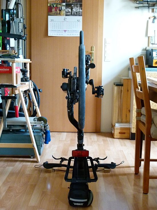

Supposed that the wheels of my black one are built correctly they should be nicely in line to each other and also with the frame.
That can be checked with two “tools” (say rails), I took straight, square wooden strips of size 26 x 26 mm, but everything which is handy, straight, stiff and at least 1,30 m long does.
So, for my logical understanding, should after gently pushing the rails together onto the left and right flanks of the tyres (parallel to ground level at a height of 5-10 cm) the situation should look like
- either figure A
(The wheels are in line, there is no gap visible) - or figure B
(Wheels are staggered, it is not possible to avoid gaps at the blue arrowed points)
Even with little steering movements (figure C) there will always be a gap, I believe…
What do you think?
P.S.:
Just called Mike (my friend and bike dealer, engineer) and discussed the issue, he meant also that the rail testing method will be recommendable.
He told me furthermore that a small misalignment of the wheels must not automatically cause a tactile left or right steering preference!
(Which was actually one of my first thoughts, as you will remember.)
