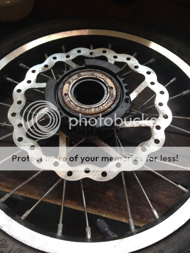

Can anyone tell me if this part is still available somewhere? It’s the bearing at the back.
It has some play, some movement, and it makes a little grinding noise … don’t like that.
I will post some pics of the bike tomerrow. Don’t know exactly what type it is.

One thing is that the brake disk doesn’t look like an older Strida to me, and your freewheel is made in China. Could that be a fake Strida?
Cheers, Bill
Also, it’s highly suspicious that the shown freewheel doesn’t have the ususal four (eight) notches for the BMX tool - but there are two little holes instead of.
I guess there will be a good chance that an original freewheel does not fit
You 're right. It’s a fake ! ! !

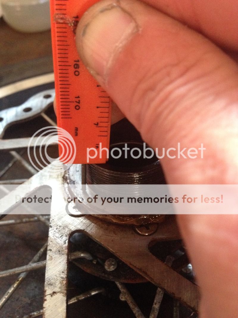

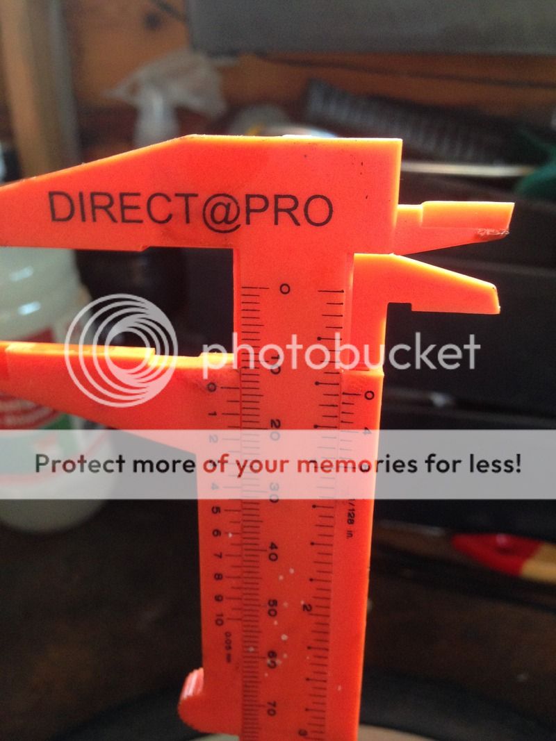

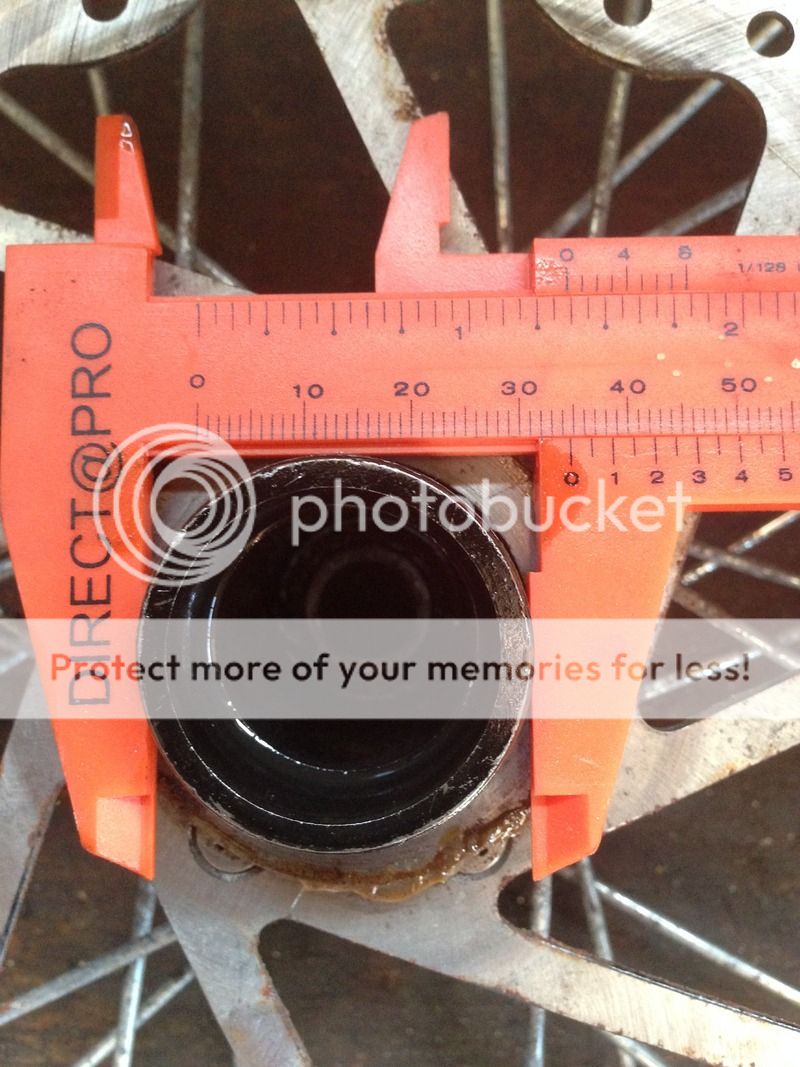

Did some measurements today.
Pic 1: outer diameter where the bearing gets turned on.
Pic 2: depth shaft.
Pic 3: depth shaft.
So the outer diameter is 35 mm. You guys think an original freewheel would fit?

Hi Guzzio, I don’t have accurate measuring tools but I measure the depth of the threads on the wheel as 14mm, depth or inside measurement of the freewheel as 20 mm.
Bill
Depth 14 mm is correct, outer diameter of a new hub ~ 34,7 mm.
Furthermore I could verify the thread, using a thread pitch gauge:
According to this the thread is a 55° Whitworth thread, named 24G 3/16, 7/32
Actually the thread pitch is just a little bit bigger than 0,8 mm.
