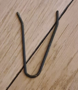

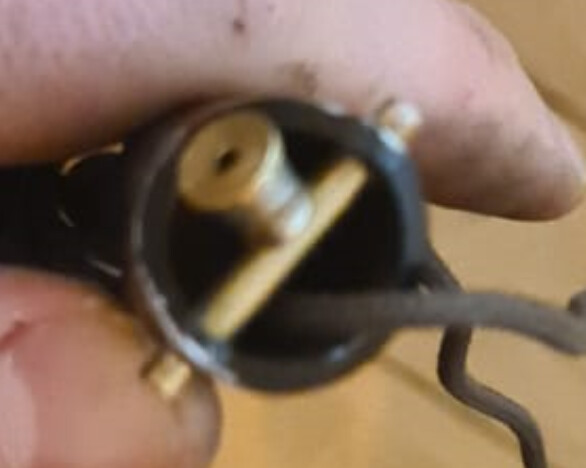

I disassembled last night and it is the spring that is broken.
I’ll buy something to replace it
Ah I see, thanks for the images!
