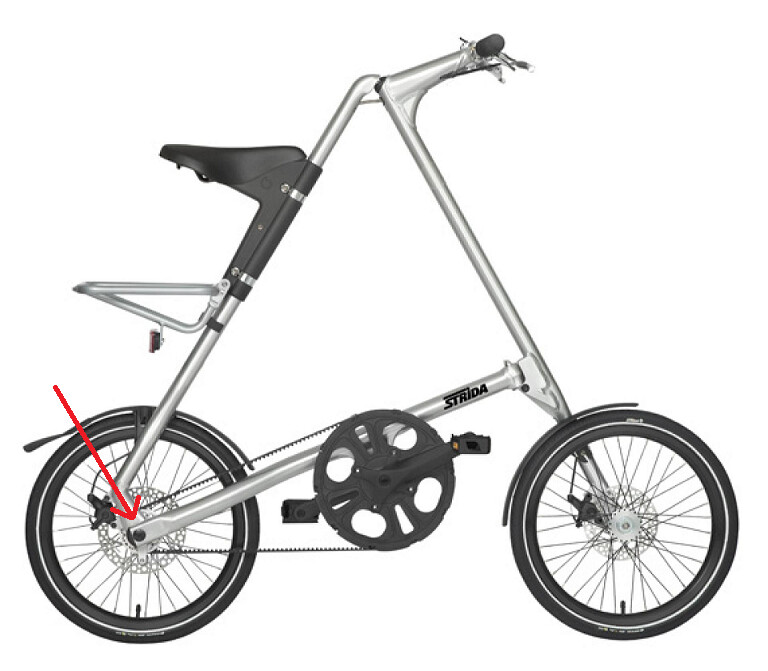

Hi, simple and definitive solution for the Strida “click”.
Easy put grease on the nylon washer rear axle.

Hi Chris, remember you sell my the Trilock system and after two attempts with Trilock the noise follow when sit or press pedal, and I continue with the original screw.
The Trilock is good idea but not resolve lack of grease on the axle nylon washer, nor the small movements of the tubes on the axle.
Obviously not fault botton braket, neither free whel.
Then I disassemble the axle and I see the dried nylon washer.
A hinge without lubricant will soon noise.

Yep, worked for me too. Been doing this for years. Well, like 1x a year if it starts creaking I just put a couple of drops of ceramic oil (actually used for my inline skates) in there.
/edit FYI I don’t take anything apart, just insert here and make a foldy unfoldy movement :stuck_out_tongue_winking_eye:
