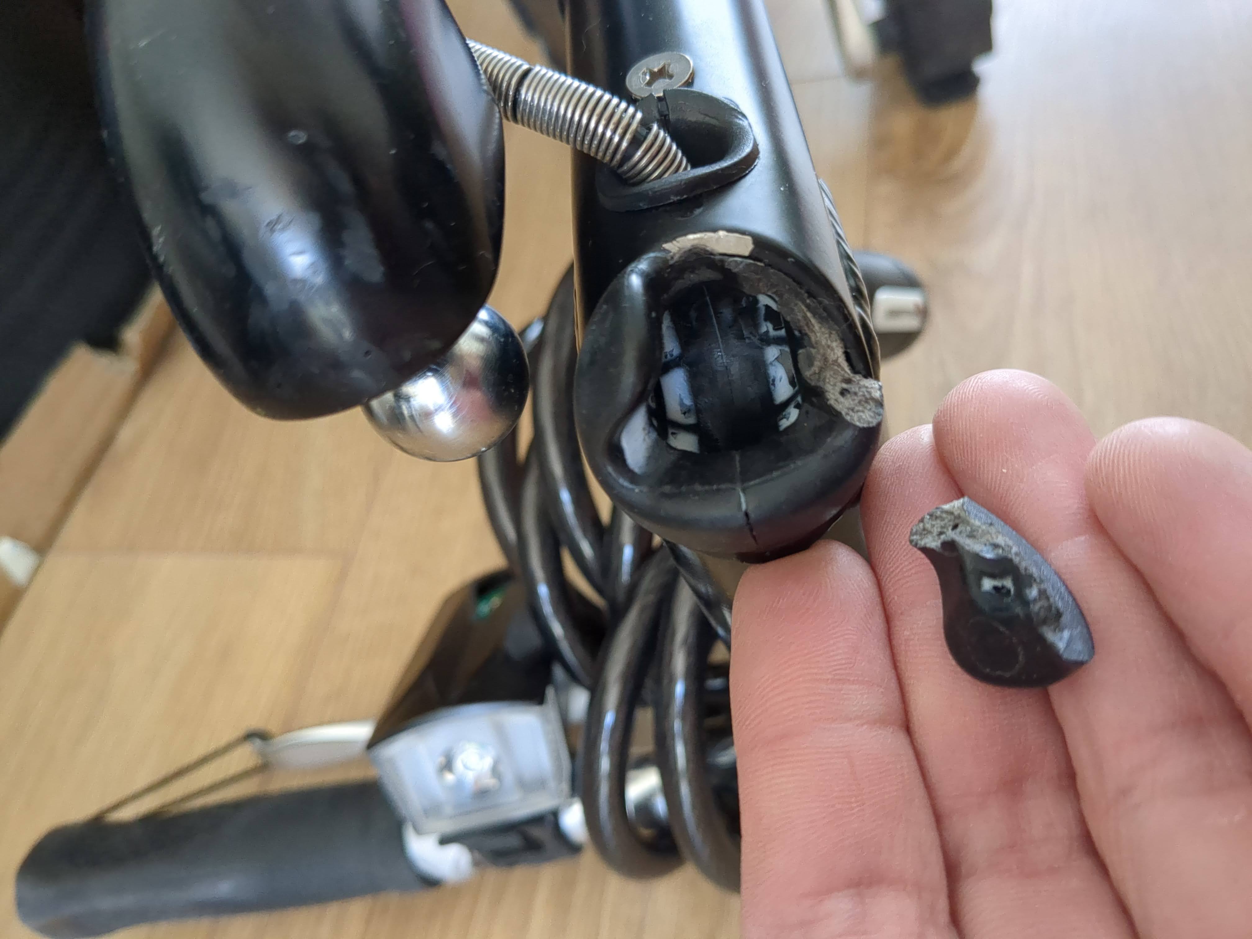

Hello Strida People - am writing to express a bit of frustration :frowning: my hinge broke on my Strida SX 2022 that I bought a couple of years ago and have only ridden quite infrequently.
Admitedlly very slight mistreatment of the bike - I pushed the folded bike under a table with my foot, the magentic clip between the wheels seperated then as the frame tube seperated a little the hinge snapped
was not a great deal of force and only a small angle between the tubes so was v surprised the hing failed so easily - but kinda my fault :shrugs:
However its 35 euro to buy the small plastic part needed?

Hello nevermind,
I mean you had good luck!
Imagine that happens during riding :face_with_spiral_eyes:
What you describe above - that is certainly NOT the typical reason to replace the two plastic ā€œpansā€.
It is a very common beginnerā€™s fault to ā€œlet the front tube goā€, meaning that the ball pops out of the pan - then it should be replaced for safety reasons.
But in your case - with, obviously, very less force - Iā€™d suspect a production issue.
Very hard to see at your image - but arenā€™t there two tiny bubbles present in the fractured surface? :thinking:
Indeed yes, there are better ways - if it really happens again - please think of me next time :wink:
(Iā€™m a private person only, but Iā€™m pretty sure that I can forward parts to UK, of course without any additional charges.)

Ahh ok - thanks for the help folks.
Yes there are a few small bubbles where it has fractured - guess I was just unlucky/lucky :sweat_smile:

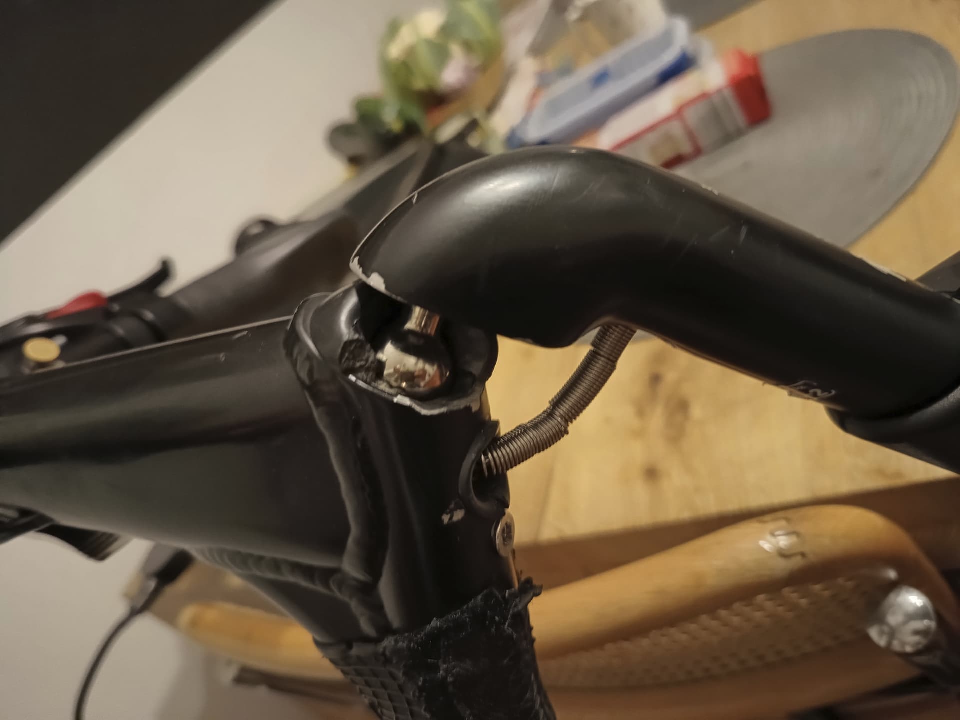

My personal experience with that brilliant socket shows that that kind of break is not dangerous for riding at all. The construction of the bike makes that the force of weight from the rider keeps the bike completely in place and operational.
Moreover the hinge with only one leaf makes the unfolding even easier.
I bought a replacement from Bill some time ago, but I am waiting for a general renovation of my strida (my wish is to repaint the bike).
I ride a lot, almost daily (as long as I do not have to replace something like rear tire which dies very fast or the freewheel which dies from time to time or KS gearbox which dies quite rarely) and I ride with this hinge like this since the beginning of my adventure with Strida which is about 5.5 years.
Of course, this is just my personal experience and I do not encourage anyone to drive with this part in this condition.
This is very common problem. Mine broke in less than 6 month. IMO it is also related to how you fold and unfold the bike and the strength of magnet. I believe this material has tendencies to have fatigue kind of failure. And installing new one is time consuming and not that easy. But it is doable :slightly_smiling_face:
