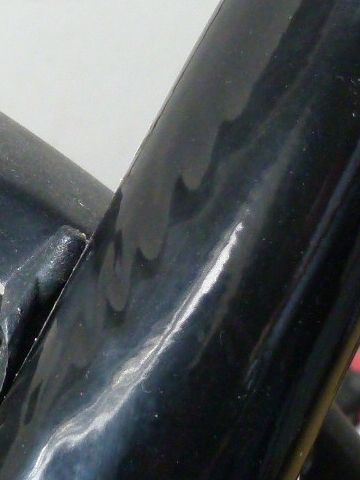

I’ve had a further look at exactly the same bike, owned by a friend here in Vienna:
Generally, there are big technical differences to an original Strida, these SLO’s are simply not comparable (that’s meant without evaluation).
Therefore, I’m really sorry to say, some tips and tricks of our forum will not “fit”.
My personal tip is: Keep an eye on your frame - constantly.
Please be careful, human body repair is still difficult…
Does your frame also look like that below? ![]()
(1024 x 768 here)
