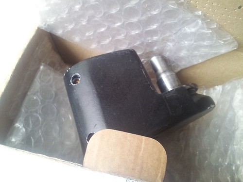

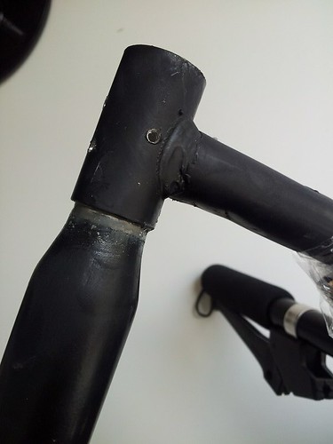

i’m now happy owner of a new bottom steerer
but to install is more difficult than i expected…

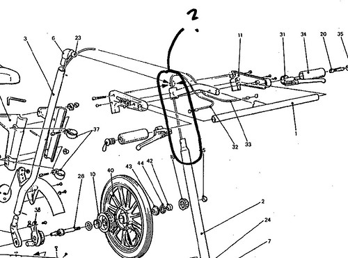

its an easy step in the explosion drawing:

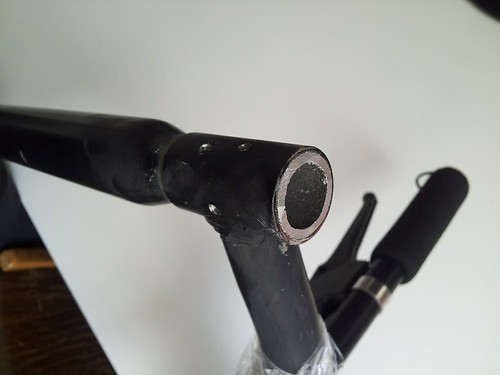

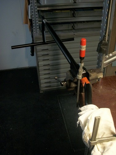

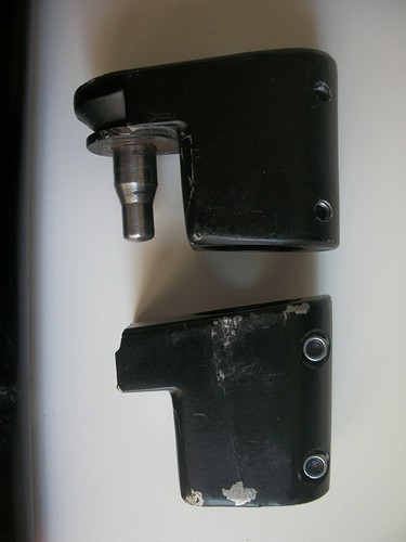

but after removing the ball joint holder i realised that this two parts are glued together…

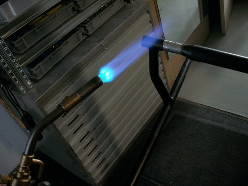

my first reaction was to give the connection an overnight bath in solvent
but no reaction - so i think its a 2component glue like epoxy…
maybe some of you have any experience with this part?
i know from chemical site that heat will destroy the epoxy but i’m afraid to destroy the laquer and the tempered aluminium pipe…

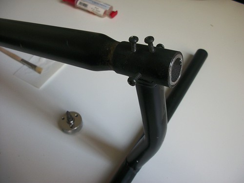

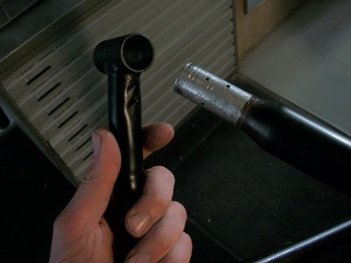

nice! the new steerer seem to be an older version with threaded holes but - and this is a sign of good quality - with thread insert from steel (emhart.com/brands/heli-coil)
but its a logic simplification in design terms to use screw nuts istead…

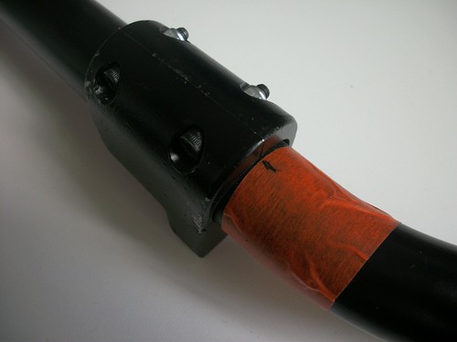

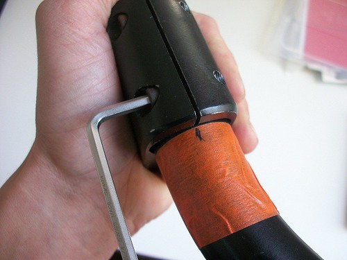

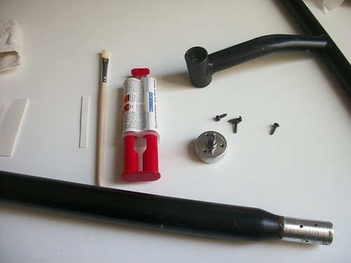

fix new steerer on same position
and finally glue again with epoxy the handlebar (after sanding and cleaning)
screws back in for right positioning

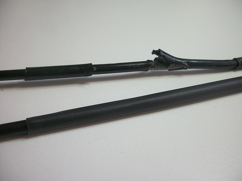

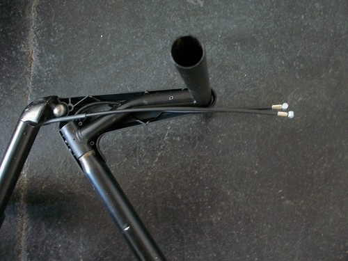

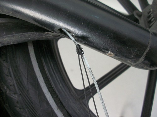

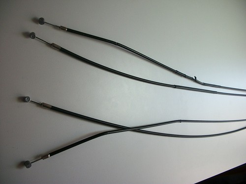

next step is to change all Bowden because they seem original and the cover is broken
specially the areas around the balljoint (and i like to have teflon bowden for better performance…)
the original cabel had a extra hose around in the area of the ball joint
i used heat shrink tube to reinforce this area

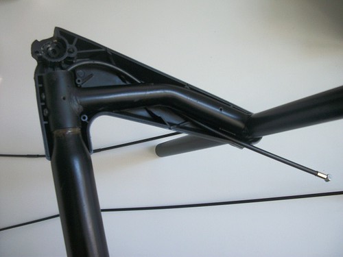

front bowden cable in place with balljoint fixation
i changed left and right position - bikes from england have on right hand side the front brake lever - and all my bikes have left hand the front brake… its a safety decision
the ball in place with cable from back brake - here you see the reinforcement
