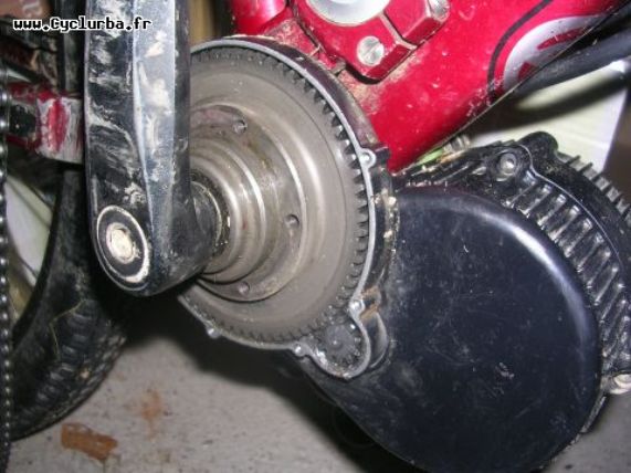

You can find here http://www.electricbike.com/bafang-bbso2-750w-mid-drive/
pictures of the drive, you will notice that there is less room between the bottom bracket and the motor case.
This distance is given by the construction of the drive - it is manufactured that way and can’t be changed by adapters.
If you want it different, you will have to create a complete new motor housing, including additional gears, shafts and bearings.

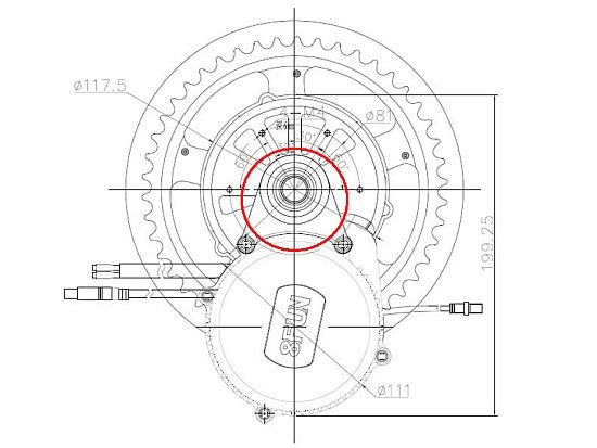

Not sure if you do already have this document; bafang-central-motor-drive-system–bds01–feb-.pdf
I’ve used a drawing from page 6.
The red circle will be the approximately position of the Strida bottom bracket.
As you can see I’m still willing to support you, regardless the conflict of opinions
This is the last step of the Bafang drive’s transmission
would there be chainwheels and a chain instead of the two gearwheels
then could the chances be better to make it Strida fit.
(A chain can be elongated easily, but not a gear drive.)
Maybe someone noticed a narrow mid drive with this kind of construction…
