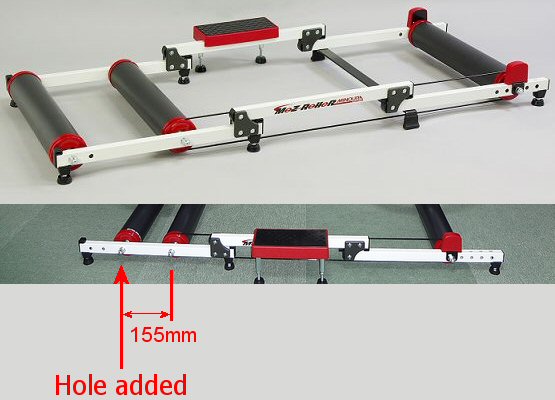

Nice! Do you know how it has to be modified? Is there a reason the Moz works better for Stridas than other rollers? Thanks for the info!
Thinking abou it, it would probably be easier to build rollers than a stationary trainer from scratch due to the Strida’s axle/magnet assembly. Maybe there would be a way to make something that clamps to the seat/rear tube…
Sorry, I don’t remember what exactly Genuine_S did with the roller, but I’ll ask him.
Have a look here: http://www.flickr.com/photos/genuine_strida/page3/
*This modification is for 18inch. For 16inch, different calculation is needed.
*Once you modify, you lose warranty.
By chance, I just needed to make one additional hole (in both end) to put one roller right position, as below. The rest are all original.

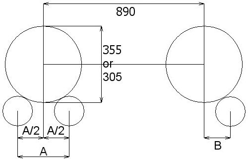

*The following image is NOT proportional to real size.
*This image was made based on Minoura moz-roller version 1.2 (black drum, improved nut)
Note:
- Make sure to measure size of each parts (tire, wheelbase etc.)
- A = around 155mm for 18inch, 130-133mm for 16inch depending on tire you have
- B is specified by manual of Moz-roller, 10-15mm is recommended. This value can be less once you get used to, but no less than zero.
