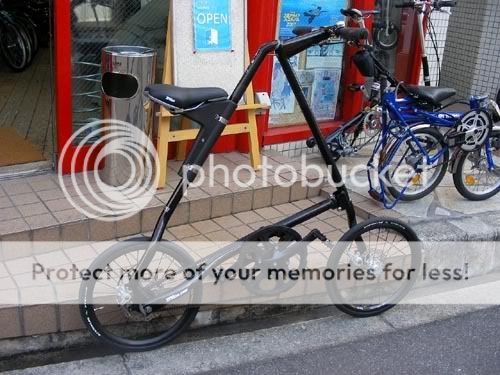

bigger wheel diameter eg have a bike shop re-spoke the hubs … assuming strida5 … onto 18" rims / high pressure tyres … such rims are used on Birdy bikes. You’d have to ditch the fenders, but with high pressure tires you’d get a very fast Strida.
More information about the 18" wheels modification on a Strida 5 in Japan.
occn.zaq.ne.jp/senmuchan/strida_diary.html
thanks. that strida with 18 inch wheels is pretty cool.
