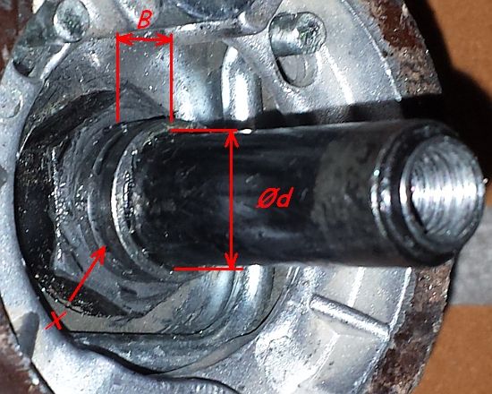

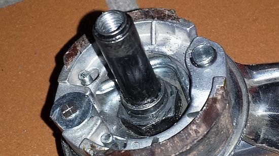

Last night I removed the front wheel (where the noise comes from) and unfortunately I noticed that the bearing (part no. 437) was definitively broken, and the other one was also compromised.
Now I’ve got the axle with only the inner bearing ring pressed on axle. Next some images.
In the last image shown above is highlighted the blocked inner bearing ring.
At this point I’m asking if somebody could help me to:
  1. understand how to remove the broken inner bearing ring
  2. understand if there’s rust problems which causes the bearing block on axle (or spacer if is present?)

I’ll try to grind the inner bearing ring by using a high speed mini cutting tool.
Looking at the pictures in the previous post, do you think the spacer is present? Is the part after the groove at the top?
Or the part after the groove is the axle itself?
Surely (now that i can, because the bearing has exploded) I’ll remove the axle before operating!!! :smiley:
Thanks for all your effort to get the pics working :wink:
That’s without any doubt the whole inner bearing ring, marked with X the ball groove in the middle of the ring.

Sorry, I meant the groove highlighted in the image below.
I realized that the other groove was of the inner bearing ring.

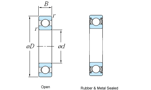

Could you tell the dimensions of your wheel bearings?

My bearings should be the type 6901 (24x12x6) and the axle should be 12mm…unless the spacer is not present around the axle.
