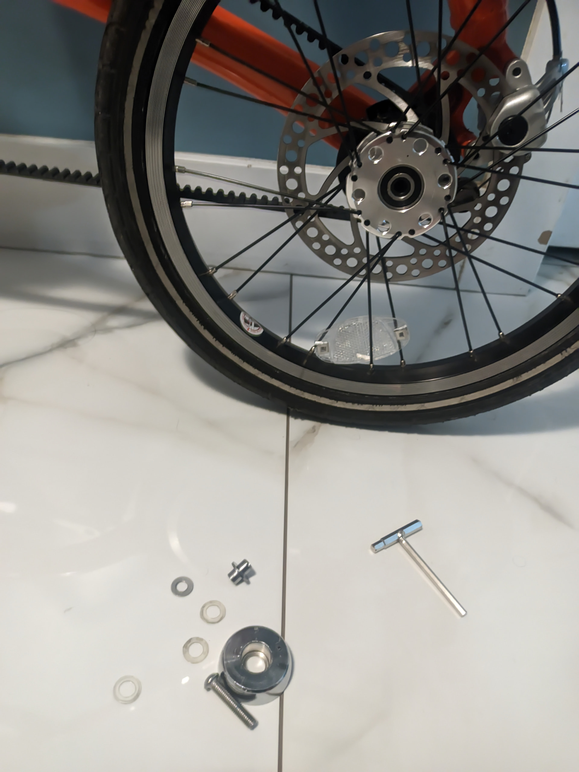

How to connect rear wheel magnet thingy after taking it off?
I took the magnet thingy from my rear tire off as it was wobbly. Now I am having hard time knowing which screw/ part will go in what order. Can someone please help?
Another question, is this magnetic attachment supposed to be wobbly, not sure but I think I read it somewhere on another forum here after I took mine off. :sweat_smile:
Thank you very much in advance for your help.

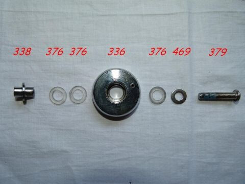

Hello Lakheet,
Here’s the correct sequence:
Yes indeed!
Explanation in short:
If you fold the bike, the wheels are not any longer parallel to each other.
The wobbliness is intended to compensate the error in parallelism!
Hint: Please tighten the bolt 379 gently by hand (or use only 1 Nm).
It is mandatory to glue that bolt with Loctite 243 (or similar thread locking compound of middle strength)!
And don’t put too much Loctite 243 otherwise the head may get stripped. It happened to me and cost alot of time and inconveniences. And it needed surgerigal intervention to remove the screw by professional welder. Consider changing the screw from Hex to Torx.

@Lakhjeet_Mann if you tighten it you may damage 338. From my experience I think you should not ride it without applying Loctite 243 because you may loose all of the items shown above. 338 may still stay in place and keep the tire in place but it is unsafe.
