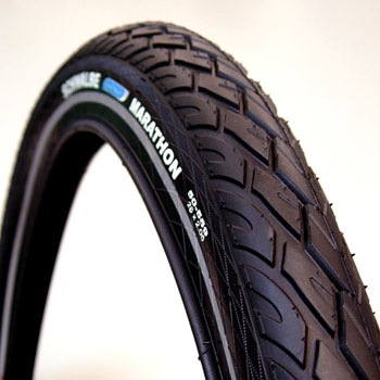

my suggestion is to change your Kojak’s to
Schwalbe Marathon Plus 18x1,35 ETRTO 35-355
schwalbe.com/gbl/en/produkte … =33&info=1
or Innova IA 2241 18x1,35 ETRTO 35-355
strida.hk/pdf/ALL%20COLOR_ACC.pdf
(sorry, found no picture)
Both tyres provide reflex stripes, so there is no need for additional reflectors!
Profile and anti-puncture function will increase your safety in the cold weather period.

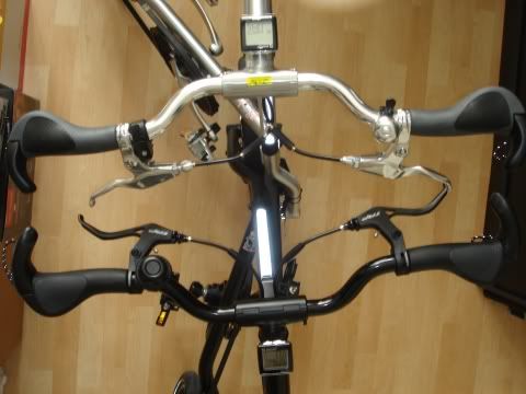

Riding a black Strida at night might not be the best idea, so I am also searching for reflective materials of any kind. At the moment I’m thinking about a “night-suit” sewn of material like this:
“Webbing with reflecting-stripe, 8mm
Durable webbing with a 2 mm wide reflecting stripe which is visible from one side.”
“High-Vis polyester braid with reflex, 25 mm
Thin braid with one 2 mm wide reflecting stripes two yellow high-vis strypes.”

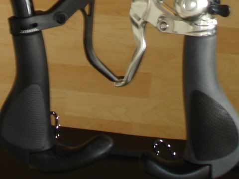

“Cord, reflecting, 3mm
Polyester-Cord with reflecting filament. Soft, flexible and slightly stretchy.”
For use as loop in the bar-ends this cord is definitely too stretchy, but it is hollow!
“Filling” with 1mm PES-Cord w. Dyneema-inlay (from kiting) is perfect for this purpose. ![]()

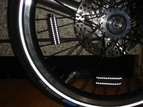

Practically no weight, waterproof, simply attachable to frame, saddle, handle-bar, (spokes?) with hook-and-loop band.
Pictured below the first try, bands are held by pins.
Maybe another DIY solution in sight?

Got reflectors with a single spoke hold.
